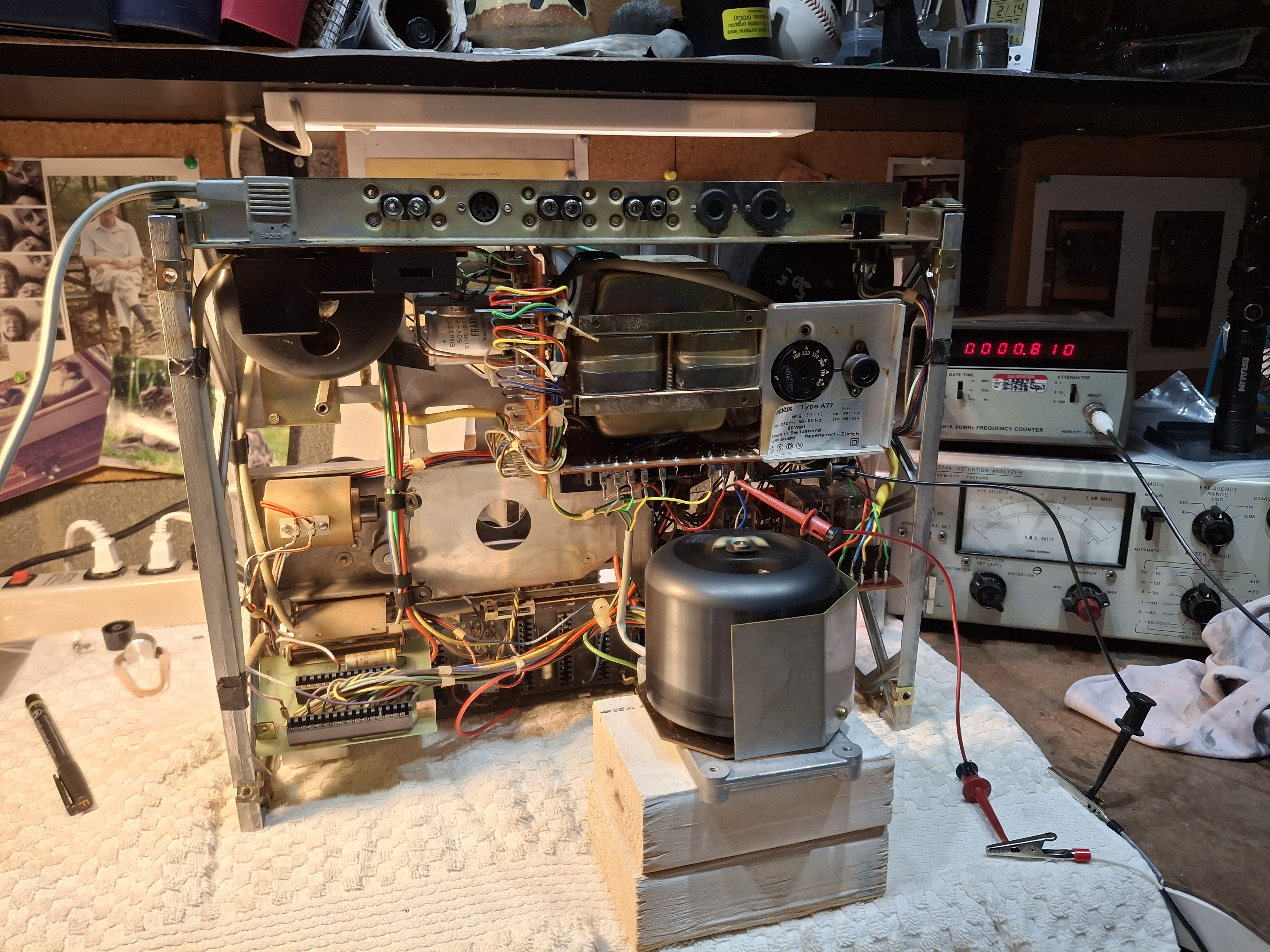

    After some interruptions and lack of interest, it's time to get back on the second A-6300 deck so I can sell it. I had playback frequency response calibrated very well on both decks. Record on both decks needs some tweaks varying record EQ cap values, so the record frequency response is as tight as the playback response. Older tape got a frequency boost in the 7-10kHz range that modern tape doesn't require. More on this process later.

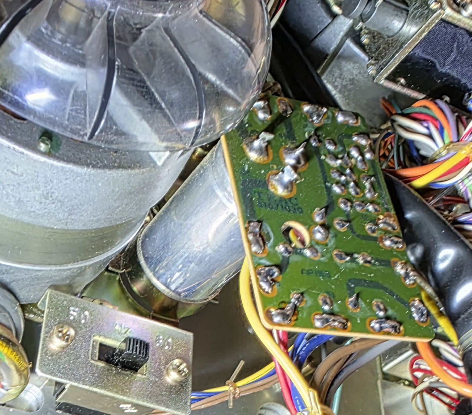

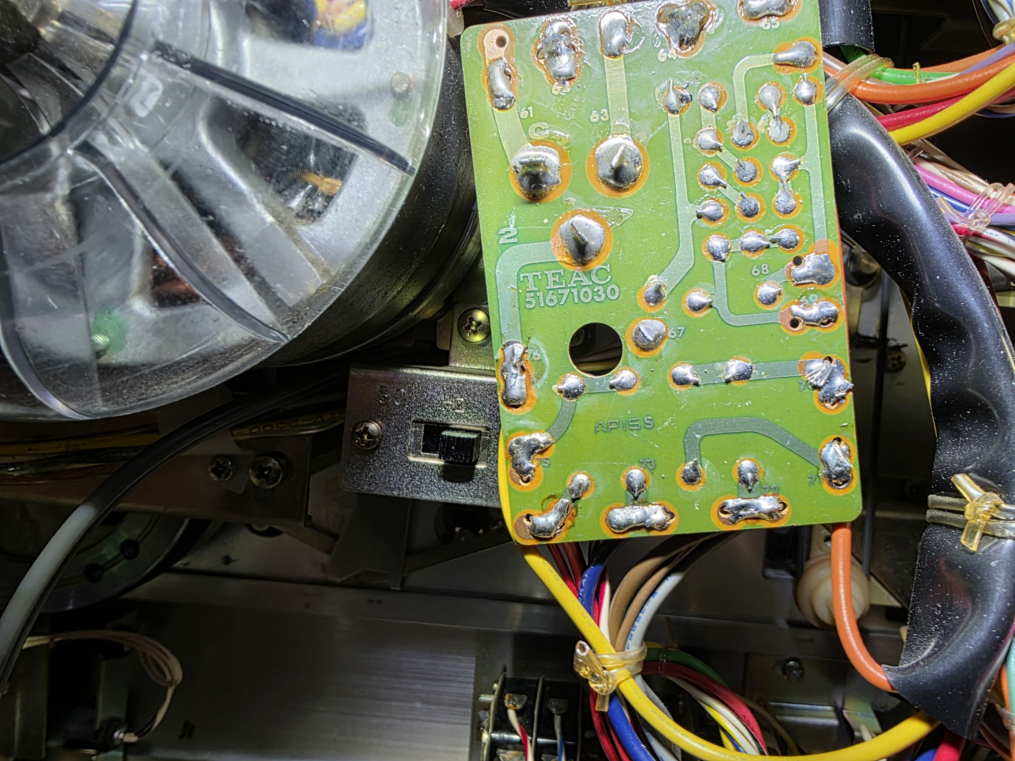

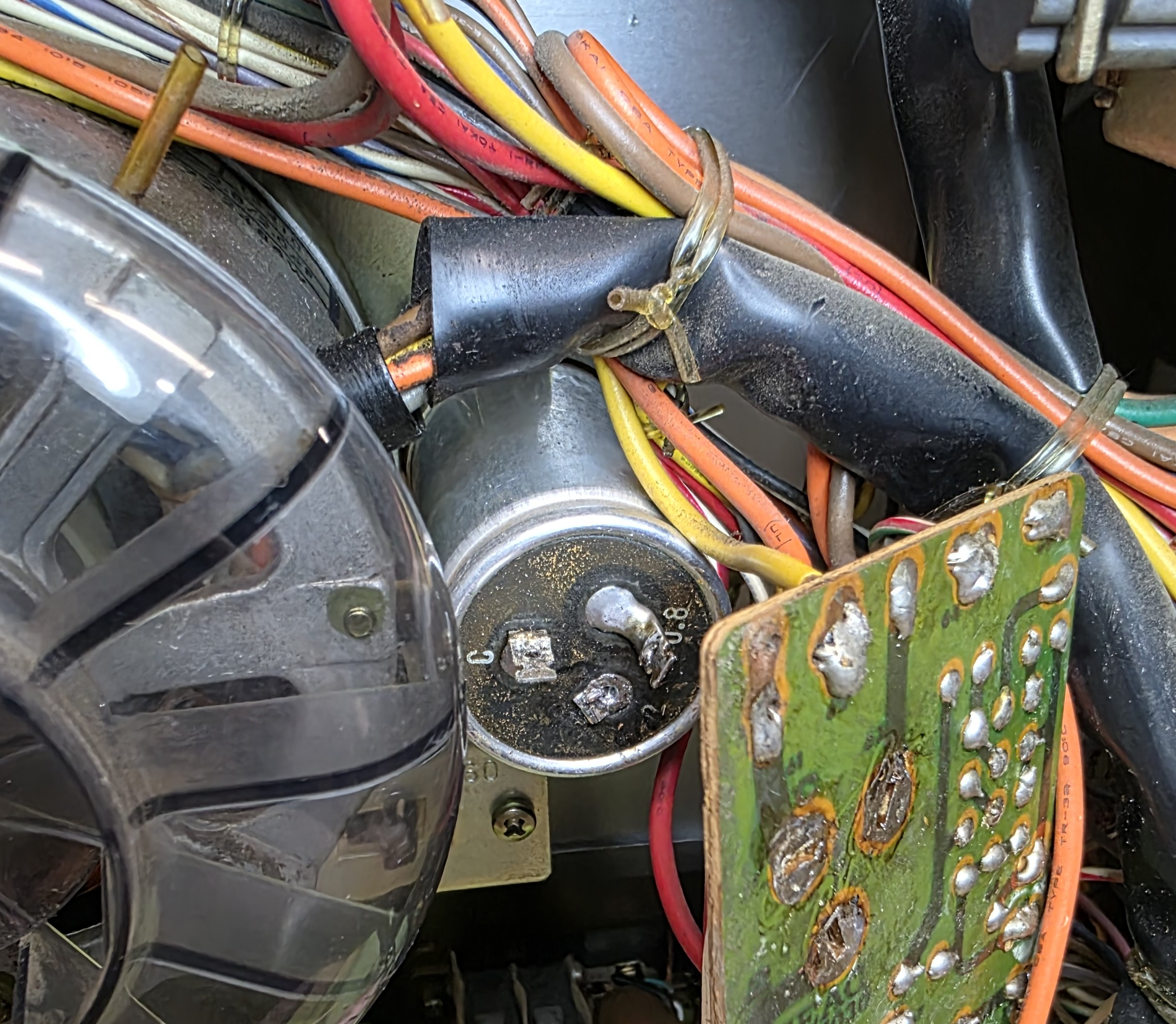

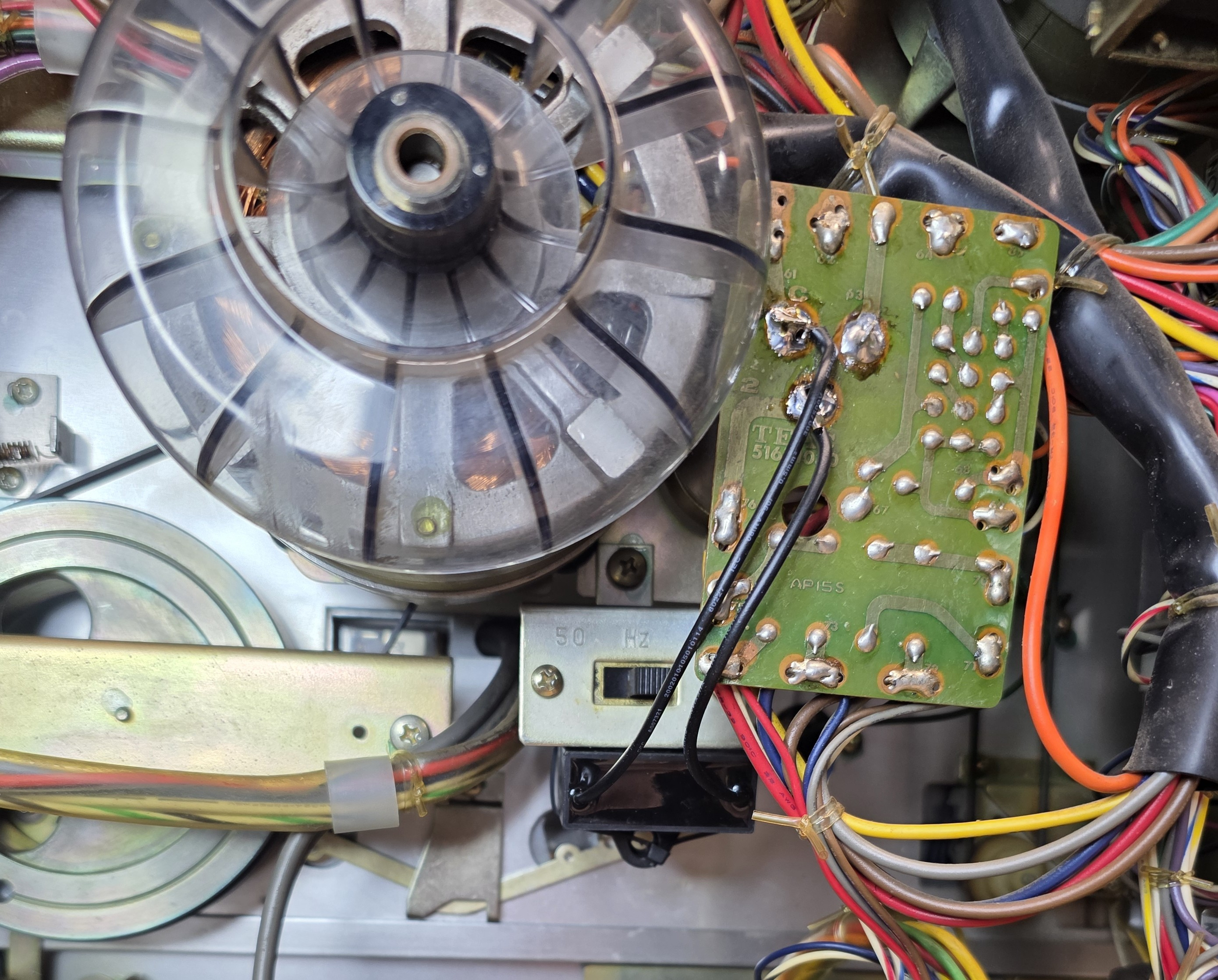

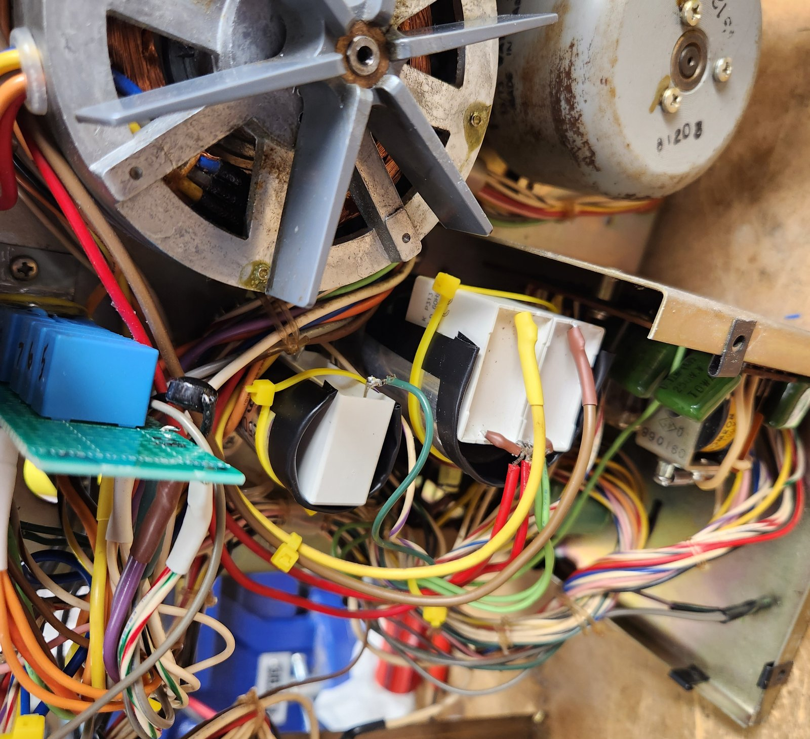

    When I first attempted the record EQ mods, I ran into capstan motor speed issues on the second deck. Motor run caps can fail or cause speed issues like the ones in ceiling fans.
    Teac mounted the base of capstan motor run capacitors to the inside of deck. They soldered a motor run PCB to the top terminals. Remove the can, now you have to secure the PCB to prevent it from flopping around and shorting out. Motor run caps for multi voltage decks will have two values, one for 60Hz and a second value to boost capacitance for 50Hz operation. (The other thing, you move the capstan motor belt to a larger 50Hz pulley).
    The 6300 capstan motor capacitor has two values in it. A 2uf for 60Hz operation and a .8uf value added to the 2uf by flipping a switch for 2.8uf 50Hz operation. One way is to desolder the terminals from PCB, cut the 60Hz tab off and resolder the common and .8uf 50Hz terminals back on the PCB.
    Then solder one wire of the ceiling fan motor run cap to the C or common terminal and the other wire to the 2uf trace. I zip tied the motor run cap run to the 50/60Hz switch bracket.

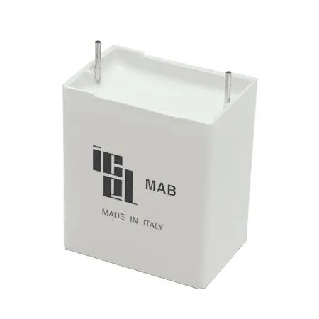

    In a previous deck, a Teac A-4010US, I used Icel by Nichicon MAB series motor run capacitors for capstan and reel motors. Mouser and Digikey were out of stock for the value needed. They mentioned minimum order, tariff issues, so I got a ceiling fan motor run instead. The motor run capacitors in that deck were also mounted at the base with wires to terminals (no PCB), so I gutted the cans, covered sharp edges and zip tied the new caps into them. It was a US only deck and while the cans contained 50Hz values, no wires or 50/60Hz switch were installed/connected.

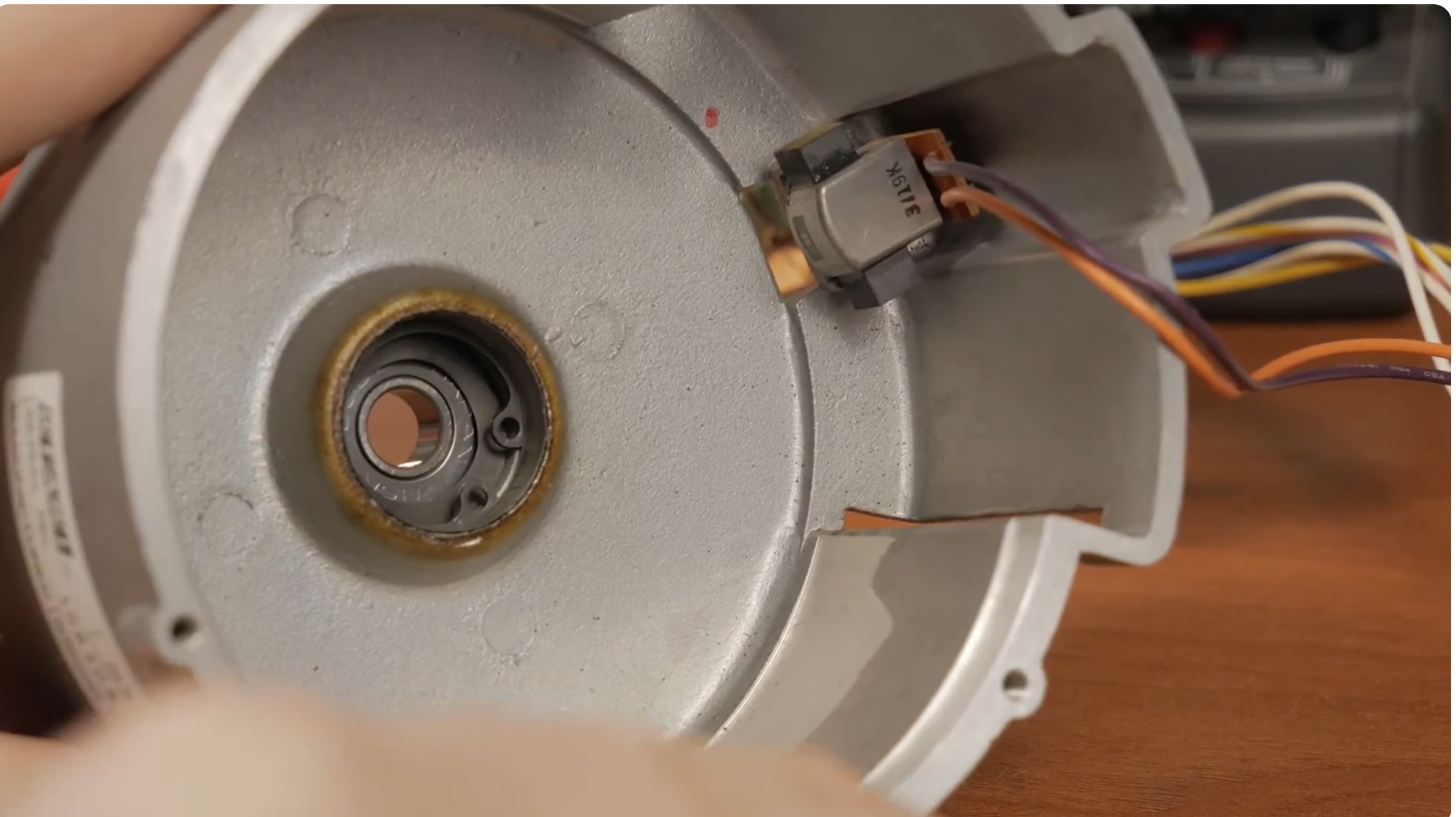

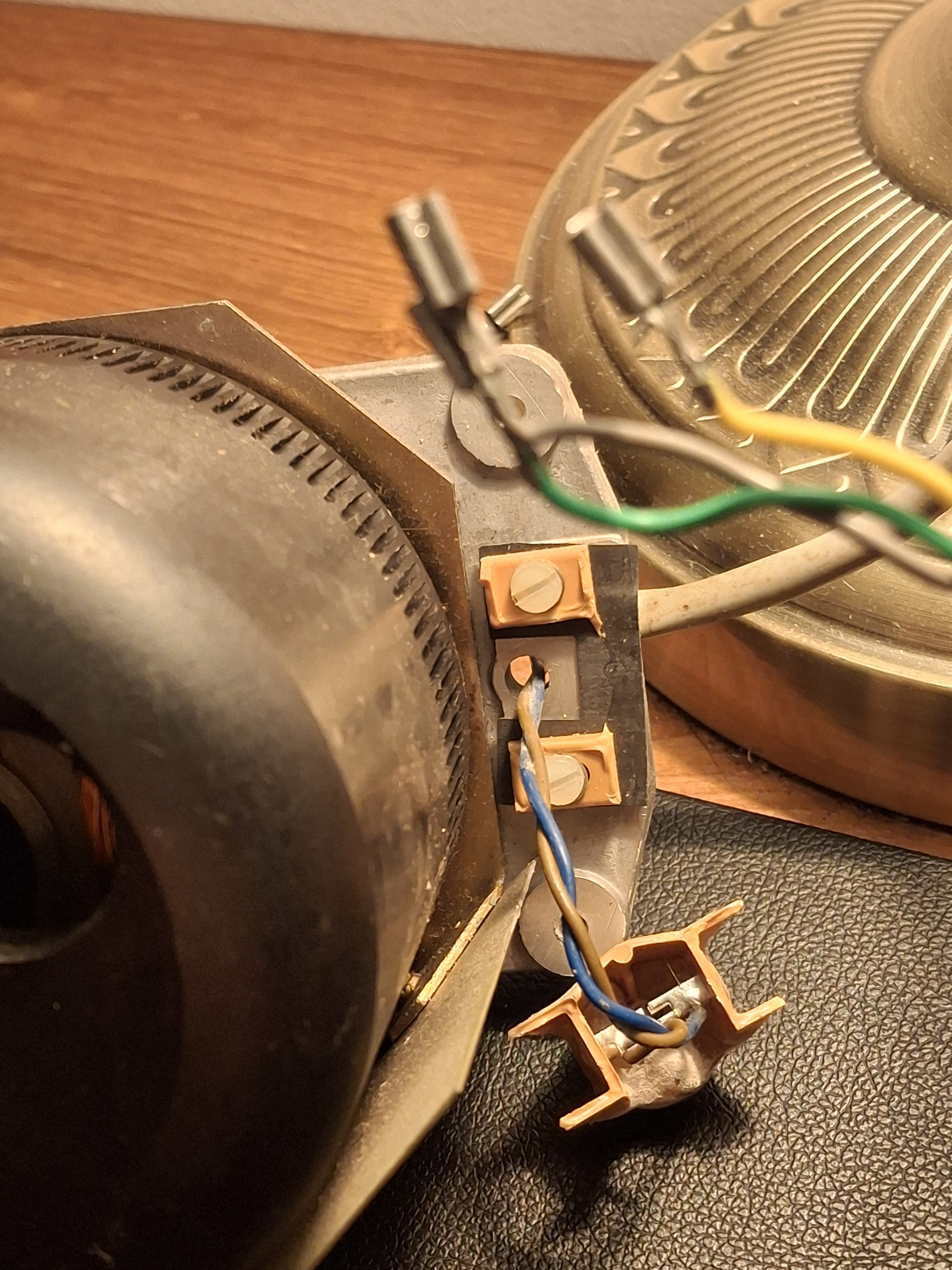

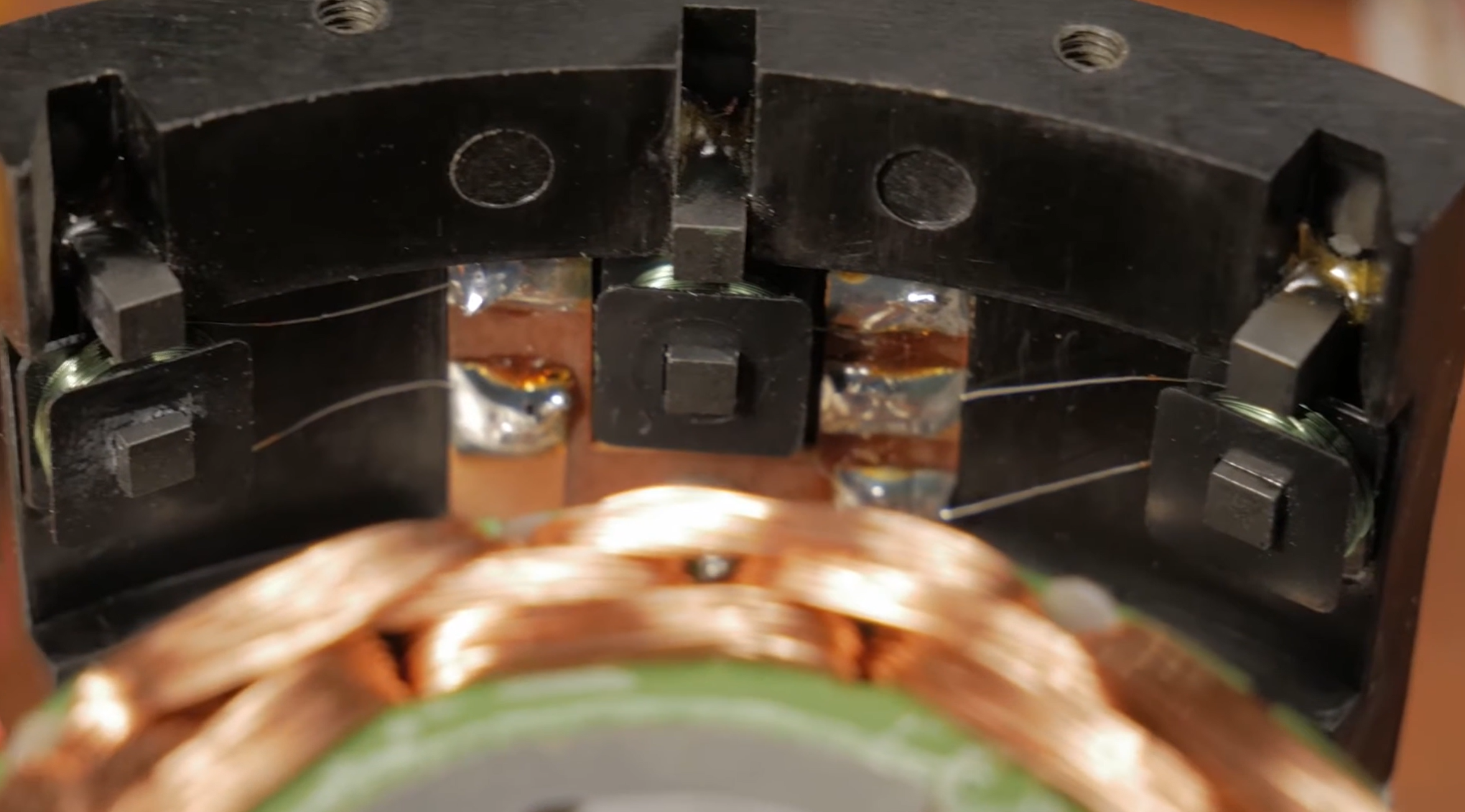

    Nice to see your progress on the Teac, Rich. I'm working on a Revox A77 for a customer and it has some speed issues as well. The A77 uses a tachometer placed close to the spinning rotor of the capstan motor. I initially suspected the speed control board and since it is a feedback loop circuit it is difficult to diagnose. I ended up checking every component on the board and replacing some out-of-spec capacitors. But the problem still happened, the capstan motor would rev up going faster and faster. Then I connected a spare motor to the circuit and it worked fine, this indicated the problem was connected with the motor. After pulling the motor I could see a broken tachometer mounting:
  • SeleniumFalcon
    I used a two part epoxy, Araldite, to repair the tachometer then connect it to the speed control board using a test jig I have and it now worked.

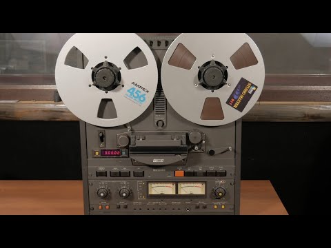

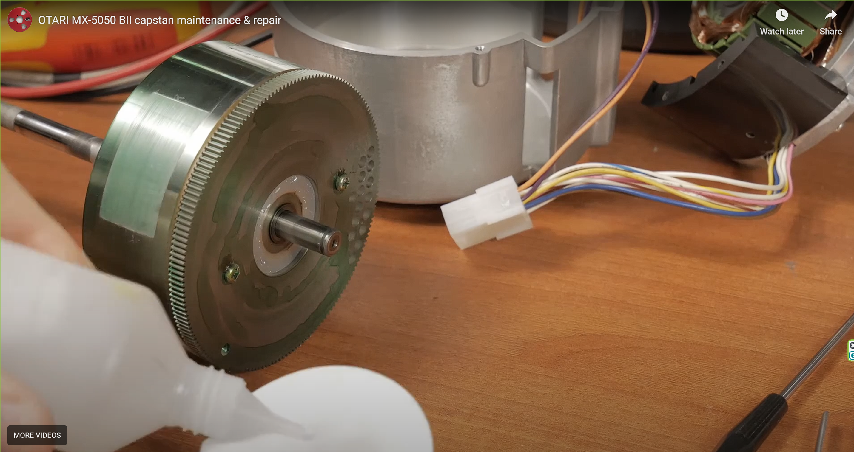

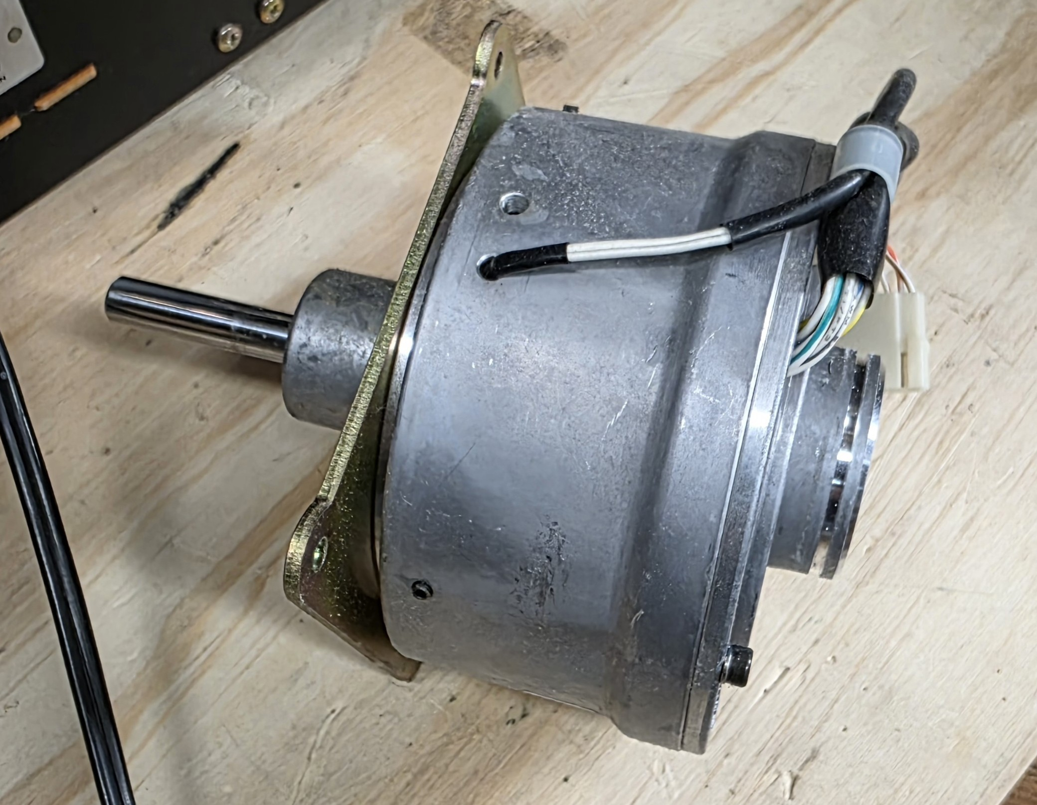

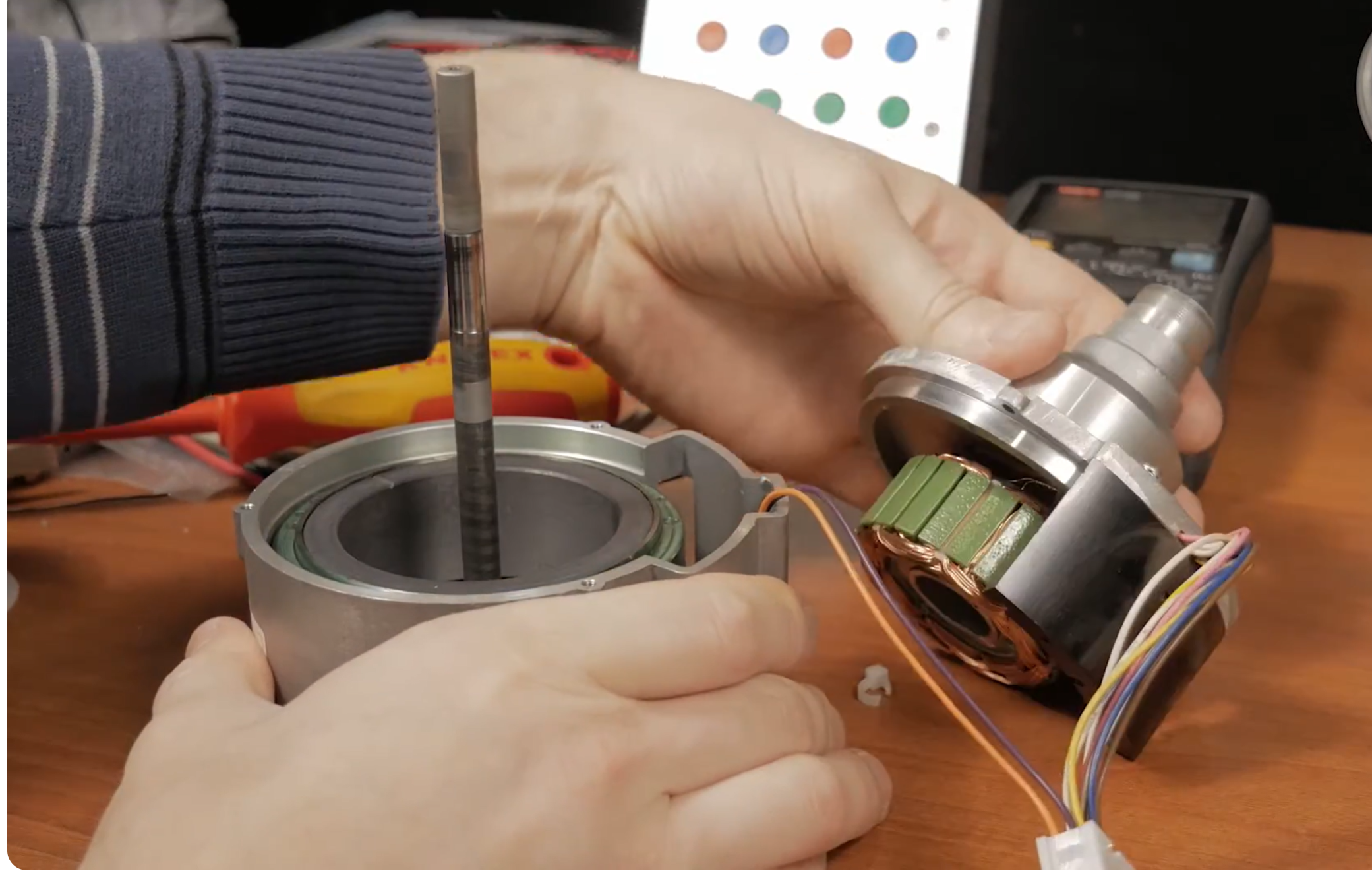

    My Otari capstan motor has some rotation sensors and two magnets on the side of a tach head that can loosen/fall off with rough handling while shipping. While searching for Otari MX-5050 BIII-2 info, I found a youtube video by Anthony Scott showing the preventative re-gluing repairs. The video shows a motor for a BII, same motor used in BIII. It's on my to do list.
    I found the info/video after removing and reinstalling my capstan motor to access sticky pinch roller arm/tape lifter linkage. The BIII added a harness plug to the motor while the BII wires were soldered to a control board. Anthony added Molex wiring connectors to his BII motor.
    https://youtu.be/McqL88f9anI?si=ws4UMZtkpZ7fgjIO
