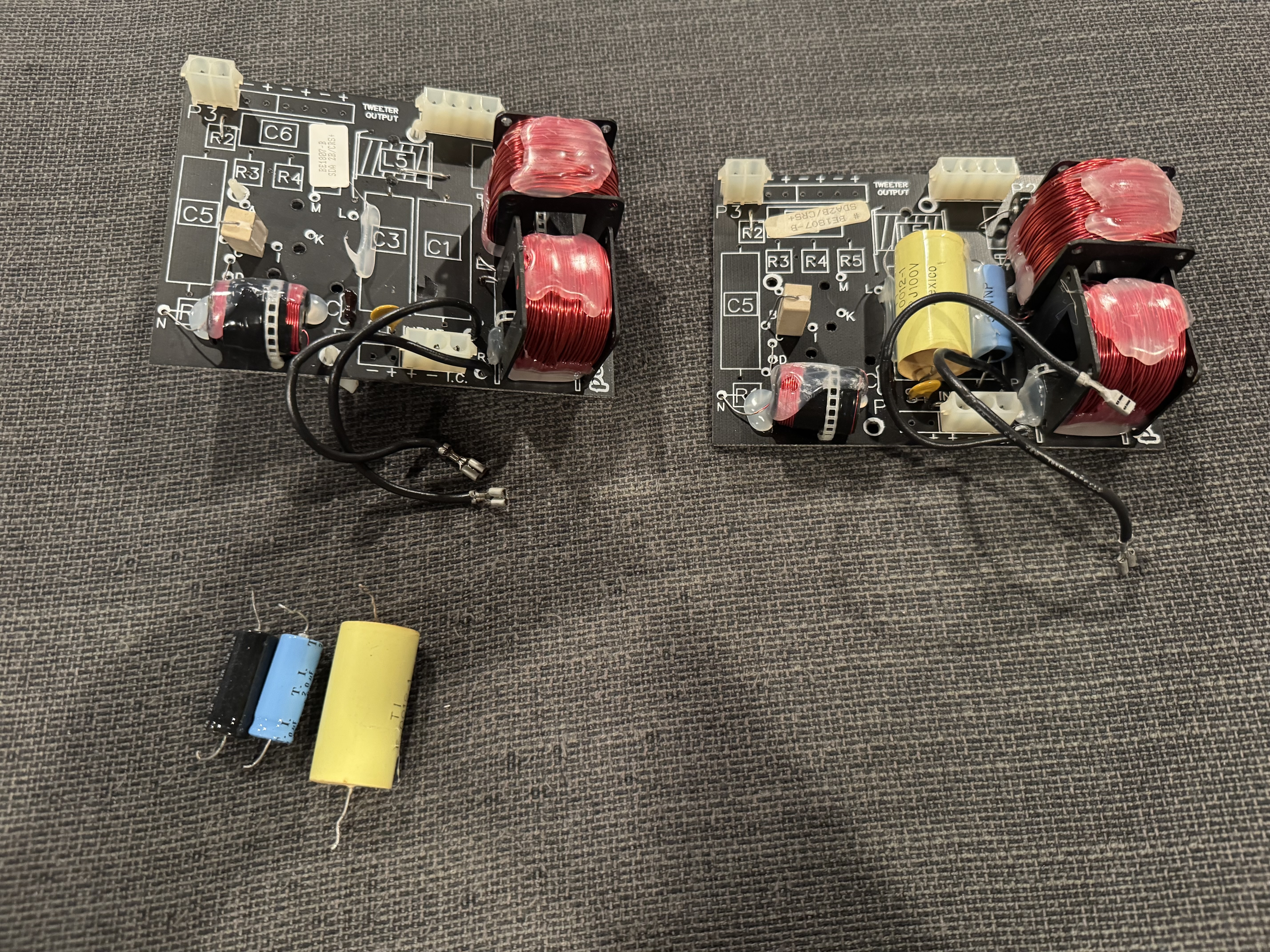

  • ok so I got the rdo198's this week, and I just got the crossovers and all that jazz in the mail today....now I need to order caps and resistors...
    I see three caps and one resistor in each crossover (pic posted below):
    1. Yellow Mylar (I think) 12uf 100v
    2. Black Electrolytic (I think) 40uf 100v
    3. Blue I-have-no-idea 20uf 50v
    4. and lastly a 2.7ohm 10%5w resistor
    so what all do I need here? and before someone says look at the schematic..I did..and I have almost no clue as to what any of it means...
    I went on madisound to look for Clarity CSA caps in these values and couldn't find what I was looking for..
    what do I need to order and where should I order it from? I'm trying to order all this asap and get these done because I have all kinds of other life-crap to deal with in the next few weeks...
    xschop Posts: 5,341
    Clarity PX?

    Am I on the right track here?
    Two of these, one for each tweeter circuit. I figure I should put the higher quality CSA cap in the tweeter circuit.
    https://madisoundspeakerstore.com/claritycap-csa-capacitor-250vdc/claritycap-12-mfd-csa-copperconnect-poly-cap-250v/?srsltid=AfmBOoqFvXgG6RF0dqiF6p2rU88GnRv7vWDOuVFEDgcEJgjBemoAKMeW
    Two of these, one for each Stereo driver....
    https://madisoundspeakerstore.com/px-cap-250vdc/claritycap-20-mfd-px-range-polypropylene-caps/?srsltid=AfmBOoqGlZs0QrhXg0cgsmk8scTi77mC3_vM-Rpz3T1r7-IW1IIwZp6n
    Then two of these, one for each Dimentional driver:
    https://partsconnexion.com/claritycap-capacitor-40uf-250vdc-px-series/
    and are these the resistors I need..two of them to be precise?
    https://digikey.com/en/products/detail/vishay-dale/RN60C2701FRE6/21736030?gclsrc=aw.ds&gad_source=1&gad_campaignid=23434098130&gbraid=0AAAAADrbLlgoL5YqUm-9YCs1bHlZIx-xs&gclid=Cj0KCQiA7rDMBhCjARIsAGDBuEAYhb0VvdrRKEqJx_bHRRkl1sAsg1vPREsEykw3_3o-JNdng5k5_d0aAnQ2EALw_wcB
    and lastly, i'm not sure what to get for the "5.8uF Electro" and "750pF Silver Dipped Mica" on the TL upgrade schematic. That's beyond my pay grade..haha...
    do I at least have the caps and resistors correct so far? I wans't sure with the different names..copper connect, metalized polypropylene, etc...
    xschop Posts: 5,341
    You can use the 5.6uf caps. Forget the 750pf. It's not needed
  • ok so I should order 2 of these....one for each tweeter circuit..and then I have everything I need?
    https://madisoundspeakerstore.com/claritycap-csa-capacitor-250vdc/claritycap-5.6-mfd-csa-copperconnect-poly-cap-250v/
