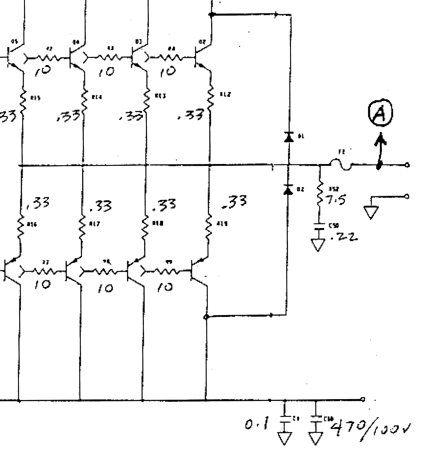

    Hello Mr. President. Can you advise if a PS Audio Delta 200 would be appropriate in this setting? I can't find anywhere whether it is a common ground amp or not.

  • SeleniumFalcon
    SeleniumFalcon Posts: 4,311
    Of course you should check with PS Audio, however the schematic seems to indicate that the negative speaker terminal is connected to ground:
    Point A is the positive terminal and the terminal below is the grounded negative terminal.

  • Of course you should check with PS Audio, however the schematic seems to indicate that the negative speaker terminal is connected to ground:
    Cheers, thanks for interpreting that for a newbie.
