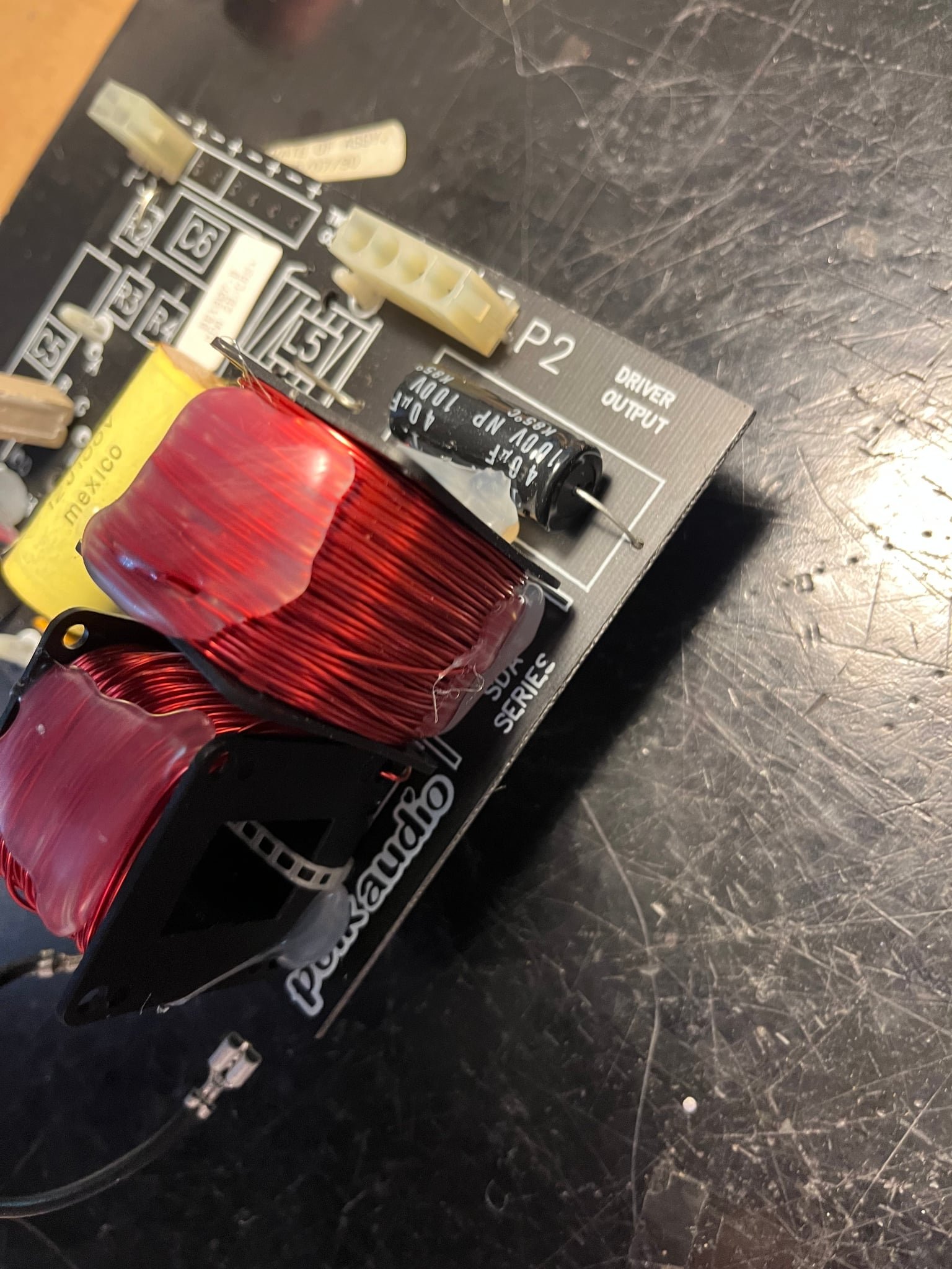

    Well boys and girls the operation was a complete success.Received the RDO-198s this morning, and already had everything else.
    The modification was rather simple. To clear some space for the new 5.8uf cap, I relocated two of the resistors to the bottom of the board. On the shunt resistor, I left enough lead popping through the top of the board to get a set of alligator clip jumpers on for testing. I did the left speaker first, and put the jumper on to simulate the 4th generation/2B High-Pass configuration. Buttoned it up, and fired up the HTPC. Started playing a few very familiar tracks, and immediately noticed the stereo image had shifted to the left. The left speaker was slightly hotter on the top, and a bit louder. There was significantly more detail as well. I suspected this would be the outcome of the test, but for completeness and any doubters out there I wanted to be sure. I pulled the PR, removed the jumper, buttoned her back up, and started again. Stereo image was back dead center, the hot top end was gone, but the increased detail remained. I then rebuilt the right crossover, put her back together and sat down for some critical listening. Way more detail across the board. I would not say the difference was as dramatic as going from the SL2000s to the RDO-194s, but there is a very noticeable improvement, and it was well worth the effort. As I stated before, and others have also, the only difference between the 2A and 2B Hi-Pass section was the 2.7 ohm shunt resistor. The 2As use identical MW6510s for the stereo and dimensional drivers, where-as the 2Bs use an MW6503 for the stereo driver and an MW6511 for the dimensional driver. I can only surmise that the combined output of the two different sets of woofers is the main reason for the shunt resistor in the 2As. It was used to balance the output between the tweeter and woofers on the 2A, but was not needed for the 2B.
    The bottom line is, 2As can be TL'd just like their younger sibling. This should apply to the 1986 CRS blade/blade as well.

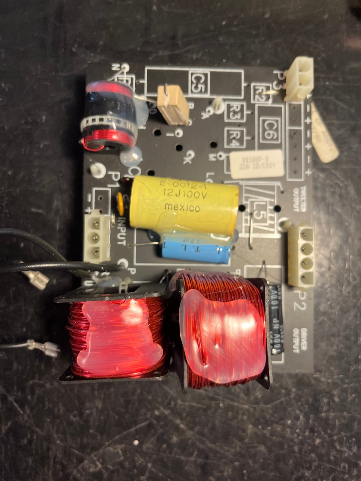

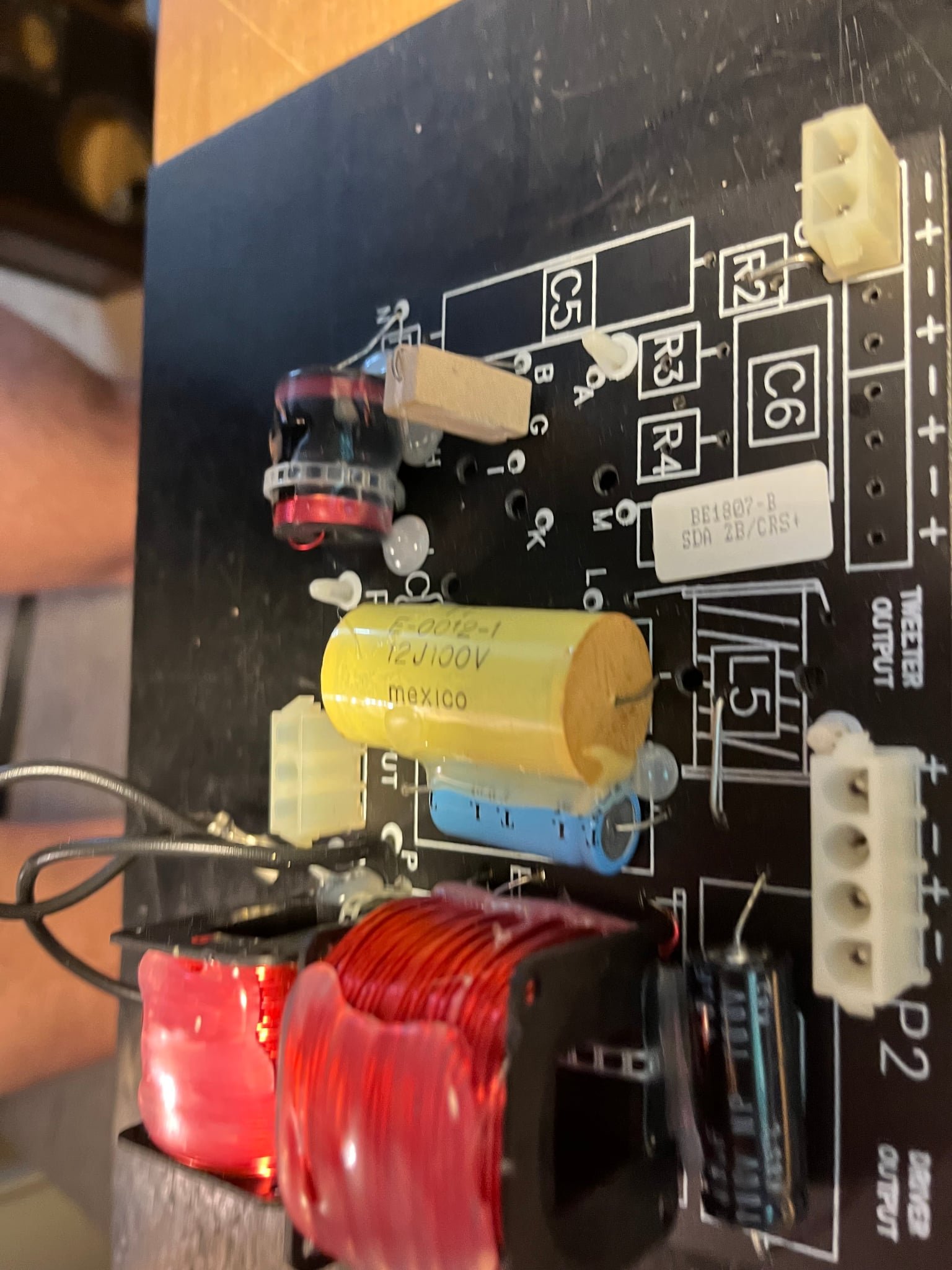

    alright...interesting turn of events...
    so this guy on Facebook has the following...he said I could have any of it for almost nothing...just shipping and a minimal fee...
    two questions:
    1. are these the desirable crossovers (and 6511 drivers) I would need in order to make some seriously gnarly CRS Plus TL-super-mega-awesome-name-people-call-them?
    2. If so, who thinks I should get these, some rdo198's, some caps and resistors and go that route?
    F1nut Posts: 52,005
    edited February 2
    Get all of that, then proceed with the RD0198-1 tweeters and TL upgrade.

    question though..are those crossovers complete? are there seriously only THREE caps in that whole crossover to replace?
    F1nut Posts: 52,005
    Quit dragging your feet, get them before they change their mind. Look at the schematic to answer your question.
