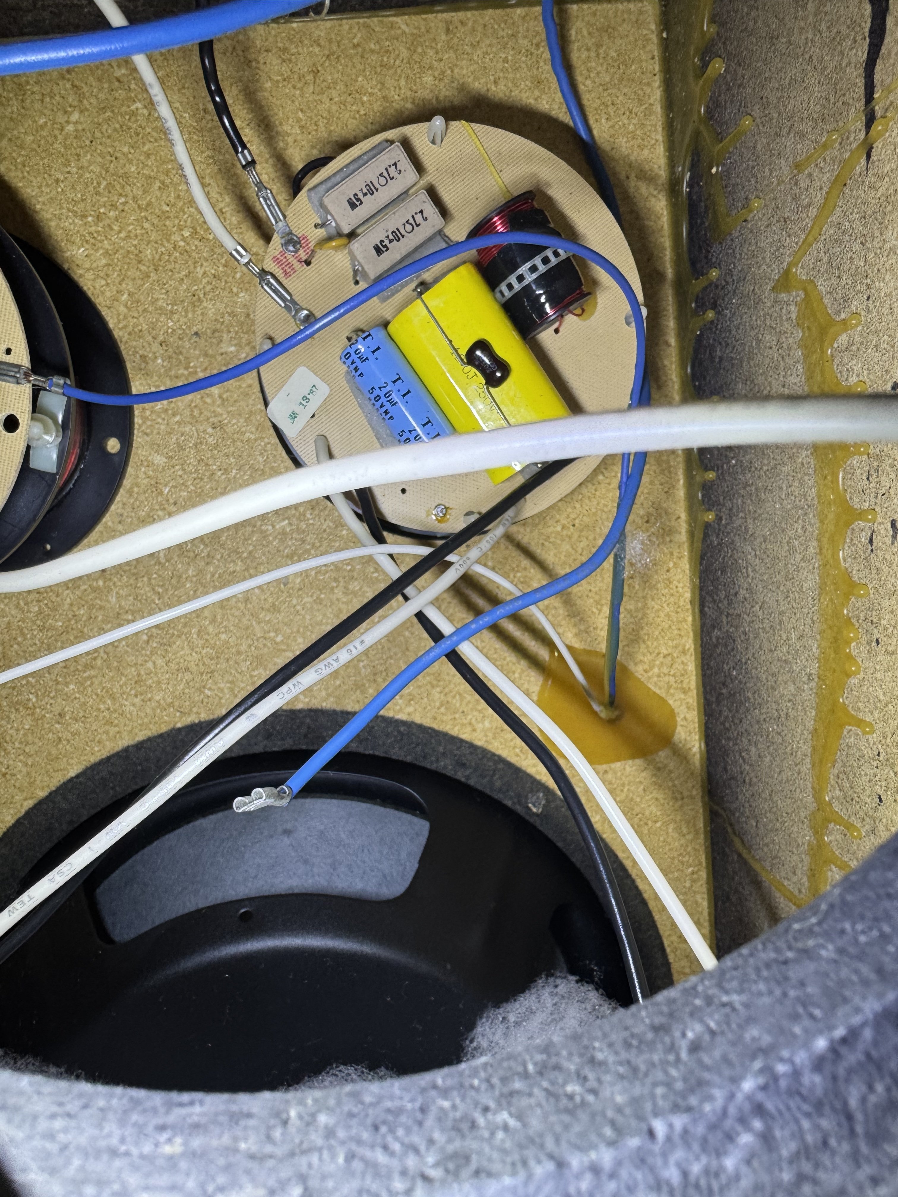

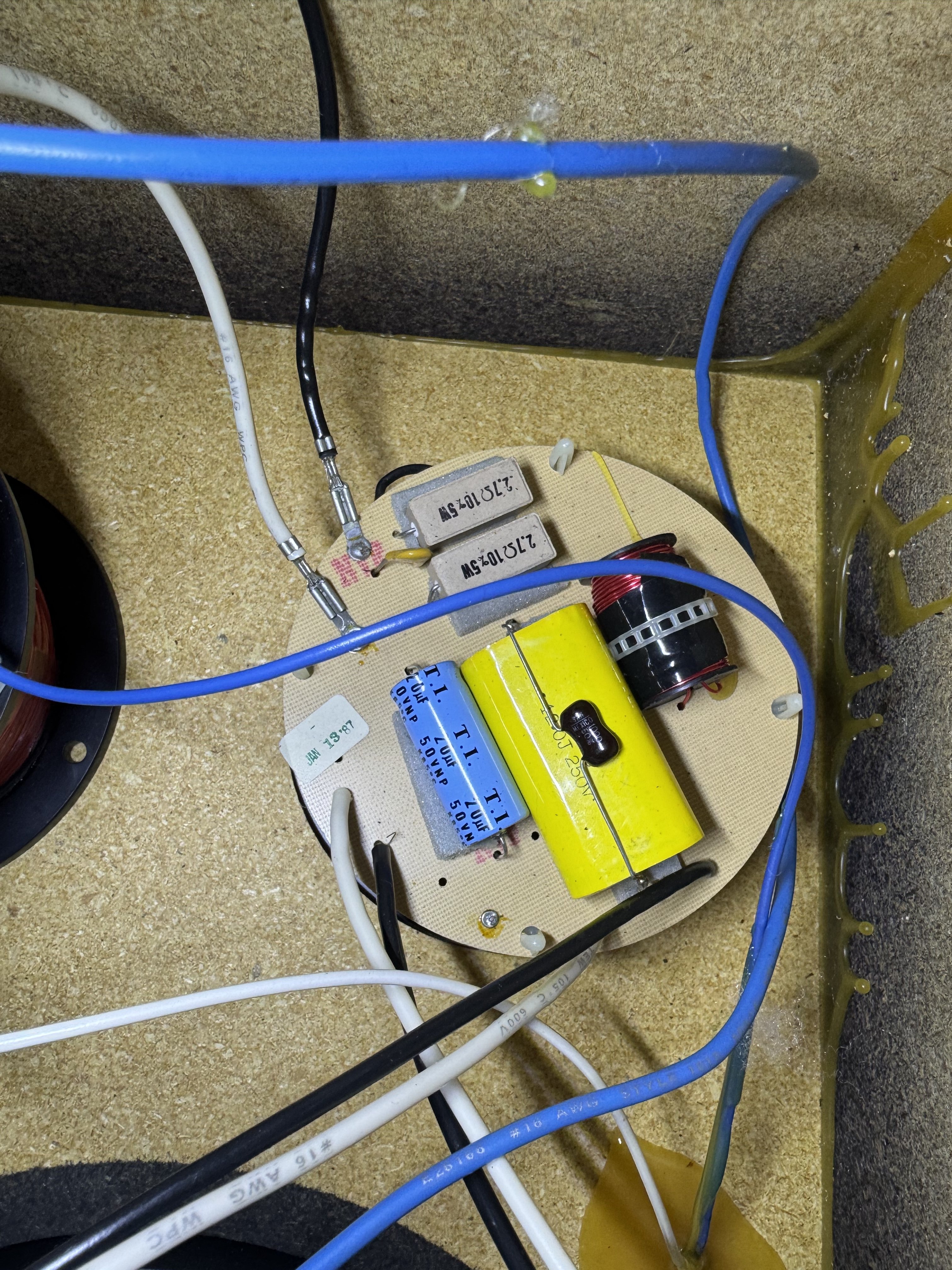

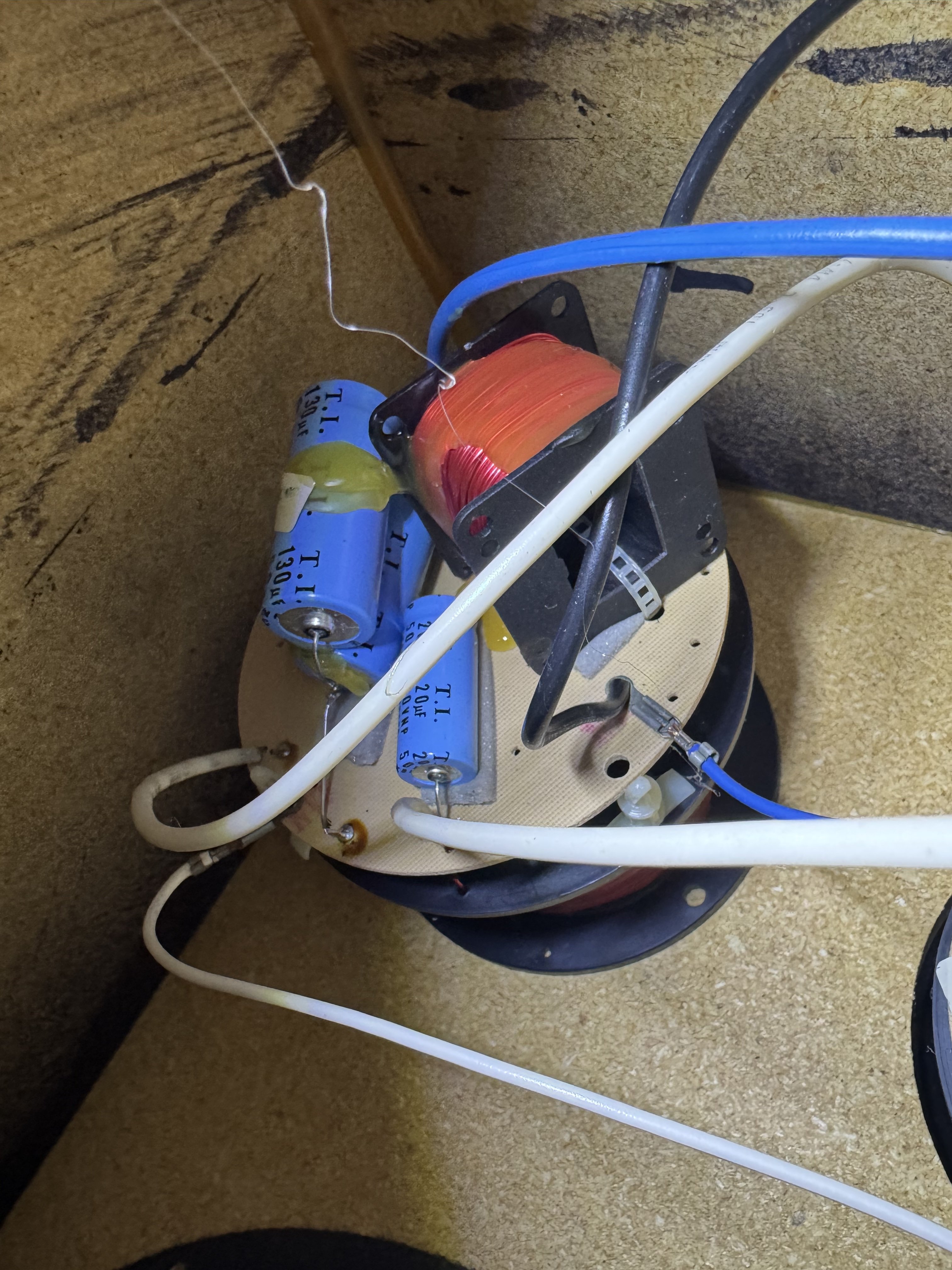

    ok so here's what I got...is it me, or does it look like someone has been in here before? this is not what I was expecting to see at all...are those OEM caps? and what is that big **** coil of wire down there?
    xschop Posts: 5,677
    Looks like all-original untouched caps.
    pitdogg2 Posts: 27,617
    All original. What are the MW driver numbers? At this point I'm not sure you can TL them. Do they have a pin/blade socket or Blade/blade.

    it's blade blade..beyond that, I have no idea what i'm doing..that's why i'm here....at a minimum, id like to upgrade the caps and install rdo194....but if i'm already replacing caps and tweeters, and it's possible, I my as well do the TL mod....i don't plan on going any further than that..these speakers were 275 dollars and I have 15 pairs of speakers, 4 automobiles, 5 RC cars, an RC boat, 5 drum kits, a full PA system, a bunch of guitars and far too many hobbies, ..etc...haha...I have to limit the time and money I can put into these.
    If recapping them and doing the TL mod is fairly straight forward, under 500 dollars, and makes such an improvement that they can potentially best all of my other speakers, then I'm down. Otherwise I'll probably just replace the SL2000 with rdo194 and move on with my life.
    F1nut Posts: 52,181
    Completely stock. Cannot TL those.
