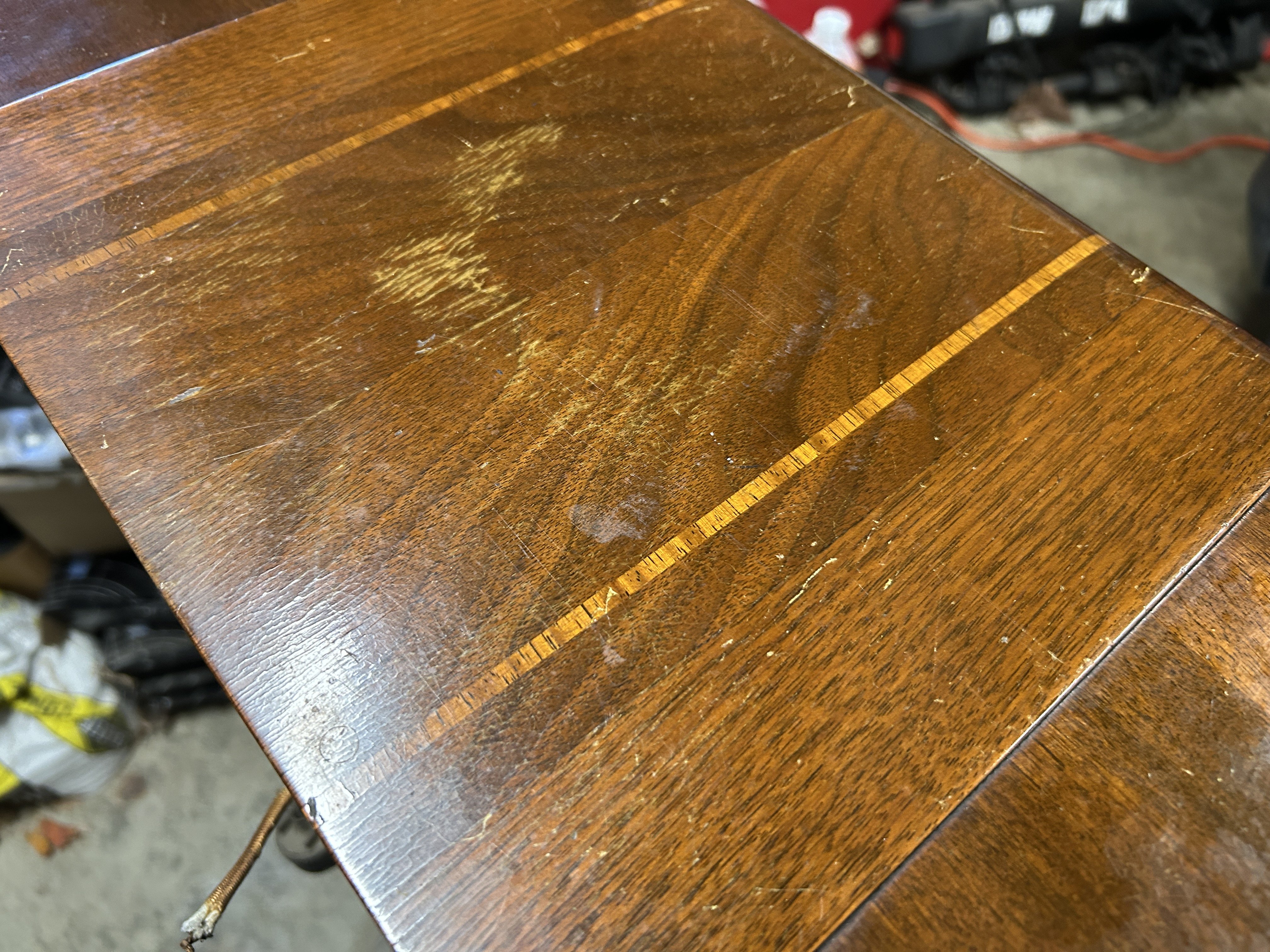

    Will the degreaser attack the finish? Also, any suggestions how to fix the top finish.

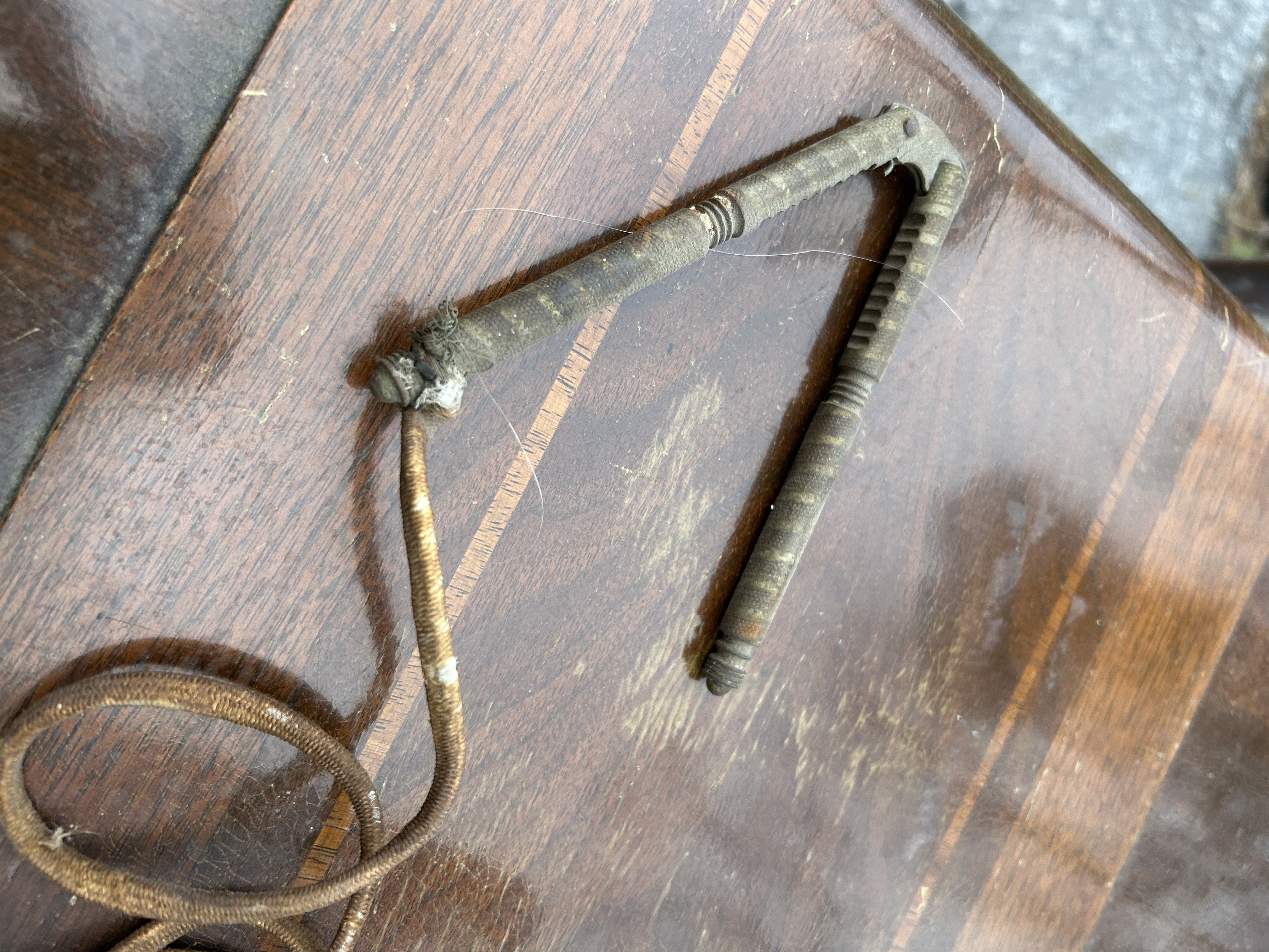

    Also, I guess my grandfather was not very technically inclined but I suppose this worked as an antenna. Either that or he booby-trapped the nut cracker to keep us out of his wallnuts and almonds.

    It will not affect the finish.
    There is nothing you can do about the finish on the top. The finish has delaminated.
