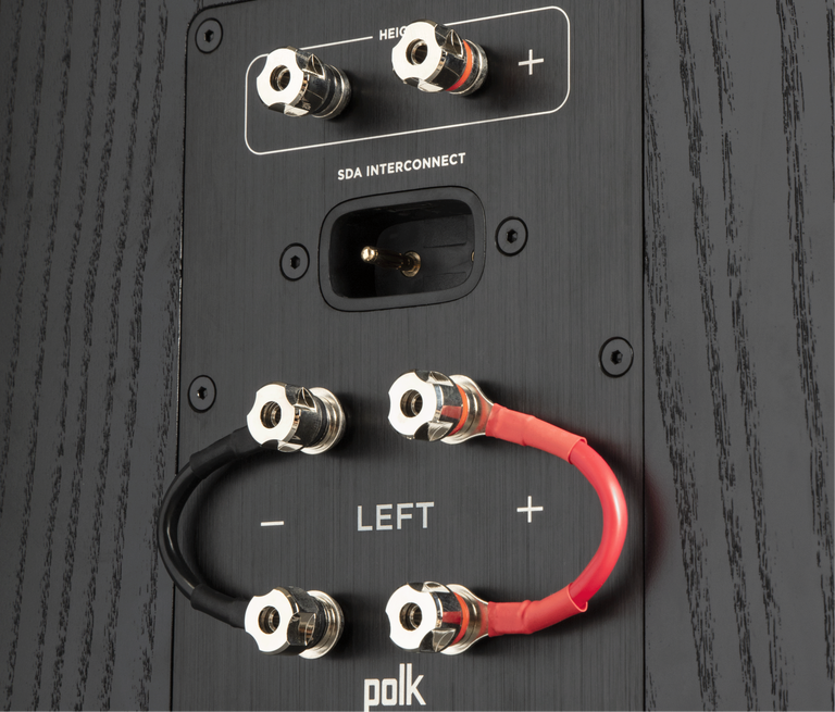

I posted before about the issues with my Polk L800. I bought these used and the previous owner broke off the binding post on the left speaker when bringing his hospice bed in. The family replace the binding post. I did. Rentable shooting today
I get sound out of all the tweeters and drivers when hooked up to amp and SDA cable plugged in. The problem was I would blow the fuse on any amp I tried when play loud. I wasn’t hearing a wide image and it was overly harsh.
I was planning on ordering a new binding post plate for the left speaker and maybe a new crossover
I just tried the following:
Unplugged the positive speaker cable on the right speaker and both tweeters and mid range work low bass out put
Plugged the positive back in and removed the negative cable and only outside tweeter and mid range work. No bass at all
Plugged both back in and went to the left speaker
Unplugged the negative speaker cable and outside tweeter and mid range worked. No bass Plugged back in and unplugged positive cable and no sound at all from the left speaker
What could cause this?

    Looking for someone with L800 to tell me what happens when you remove positive cable from the right speaker with the SDA cable plugged in. I don’t believe it should still play out both tweeters.

    nooshinjohn Posts: 25,928
    Take apart the binding posts and check to make sure the plastic sleeves are in place. I am thinking a binding post is shorting to the plate itself.
    warlocks1 wrote: »
    Binding posts sleeves are in
    Place. I am going to order a new plate from Polk just to be sure.
    Just because they are there does not mean they are positioned correctly. There is a ridged edge on at least one of them that sits in the binding post hole to protect the post from touching the plate. If the sleeves are not installed correctly, the post can shift.

    Maybe a quick test to see if the Post is contacting the plate...
    Take a DVM and check between the Post's and the Plate?

    Update:
    I received the new crossover and binding post plate
    Installed both and no change.
    Installed the removed right channel crossover in the left speaker and no change
    Removed and test all tweeters, mid range and woofers. All appear to be working properly
    Same question:
    What should I hear on each speaker with the SDA cable plugged in and
    1 the positive cable from one speaker removed
    2 the negative cable removed from one speaker
    Why am I not hearing the same thing on both speakers when doing the above process
    Currently:
    Why not the same on both speakers
    Is it possible that’s the way they are designed
    Tested all the speakers
    All 4 woofers tested at 9.8 ohms
    All 4 mid range tested at 7 ohms
    All 4 tweeters test at 3.3 ohms
    I am so confused
