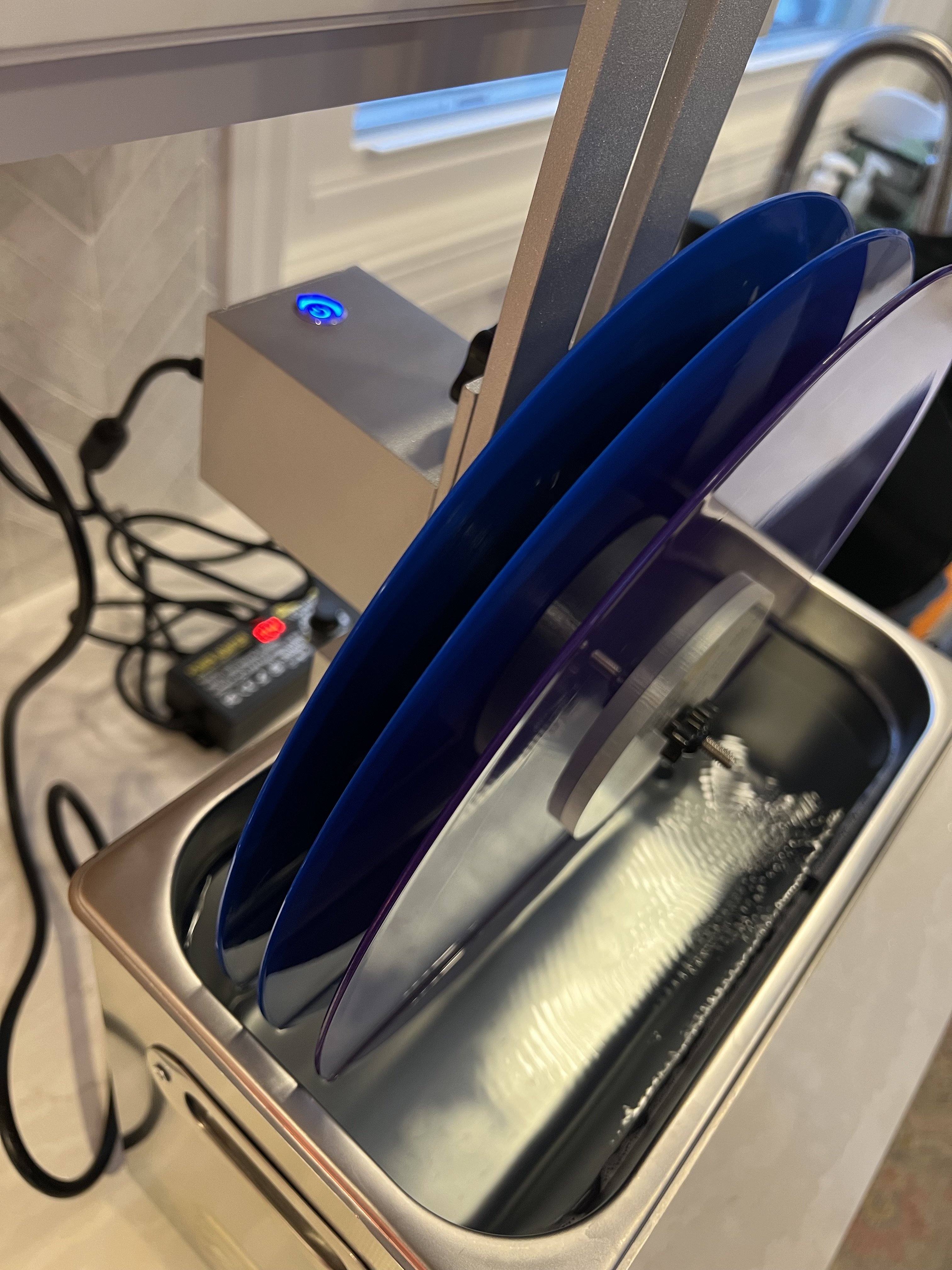

I needed an ultrasonic cleaner for cleaning brass casings, for reloading. I decided to keep it reasonable and while kicking around the Vevor website, I came across this:
https://www.vevor.com/ultrasonic-cleaner-c_11064/6l-ultrasonic-vinyl-record-cleaner-cleaning-machine-complete-w-drying-rack-p_010265133877?adp=gmc&utm_source=google&utm_medium=cpc&utm_id=23093382192&ad_group=189722589027&ad_id=778133999269&utm_term=&gad_source=1&gad_campaignid=23093382192&gbraid=0AAAAACq8bLVhdLwZFk1VsOJGBev78HBsr&gclid=CjwKCAiA3L_JBhAlEiwAlcWO54l7DwsrEJn27vCAyRE6xyp1-eEvXrLeyQCwxBAKItezcJcEIbBzFRoCkR4QAvD_BwE
I figured for the $15'ish it added to the "standard" version, why the heck not try it.
For it's base purpose, it's fantastic at cleaning up brass!
After a good clean out, I set up the vinyl cleaning setup.
I need to research some better solutions for the ultrasonic, but I have a good bit of the "Spin Clean" solution kicking around, and a quick search claims it works alright.
So, I dropped in 4 caps of the solution and started a cleaning cycle.
I set the water temp to 39*c (about 102*f) and ran 6 albums for 15 minutes.
I picked a few albums that I've retired for being too noisy, such as ZZ Top "First Album" and Ray Charles " Ray's Moods".
The cleaner didn't perform any miracles, it's not going to repair surface damage, but it did clean up the sound of these 2 by a really good margin. Way less hiss, crackles and pops. To the point that I'll happily put them back into rotation.
I also put my MoFi copy of "Brothers and Sisters" in. This album has always had a frustrating amount of noise to it, especially for what MoFi albums cost.
All I can say at this point, the noise is GONE.
So, it seems I'll be cleaning my entire collection of vinyl on this machine!
Thankfully it's a relatively small collection.

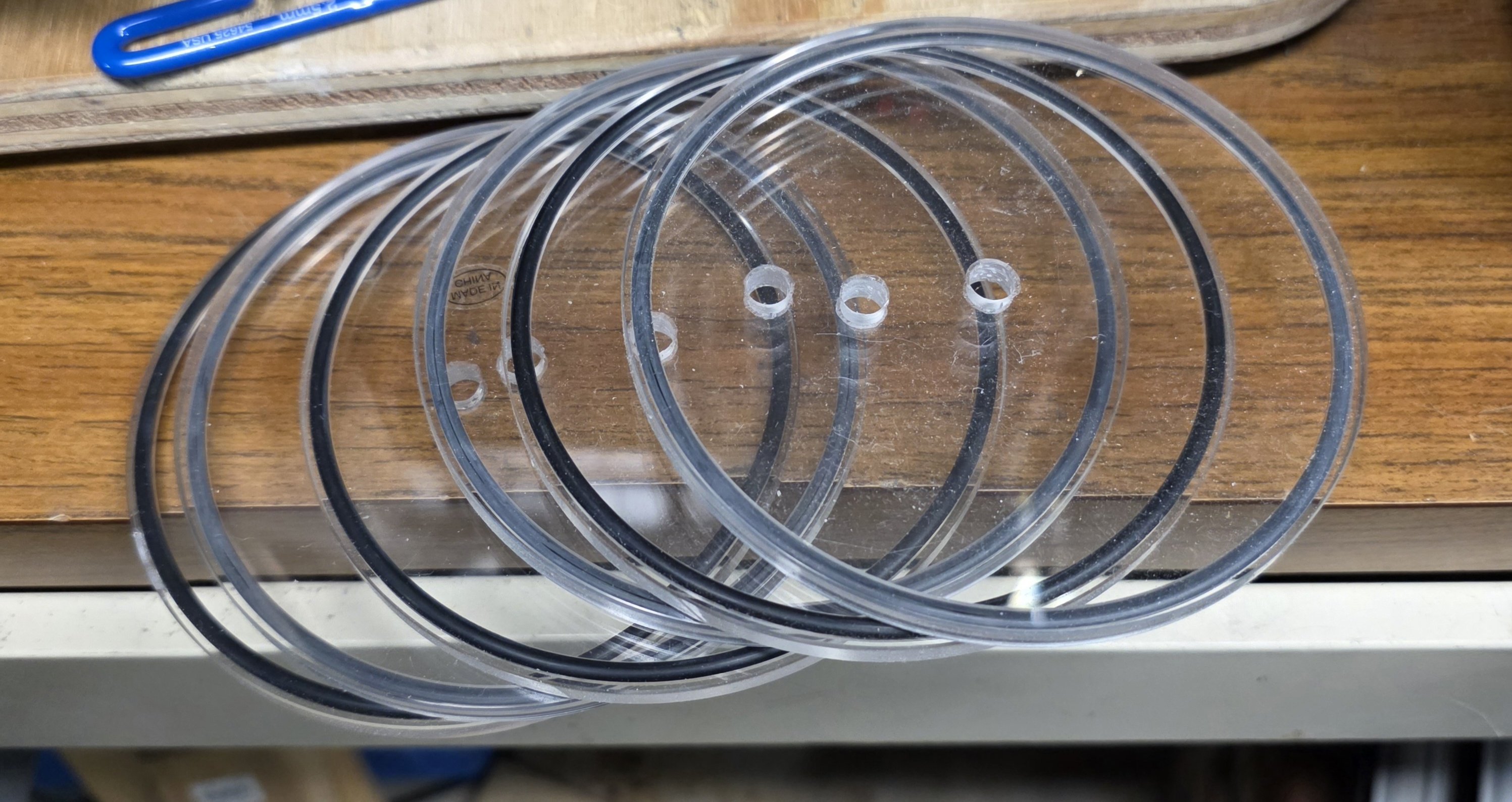

  • Upstatemax
    Upstatemax Posts: 2,798
    This one does come with spacers that go between each record, they also cover the labels to help keep them better protected.

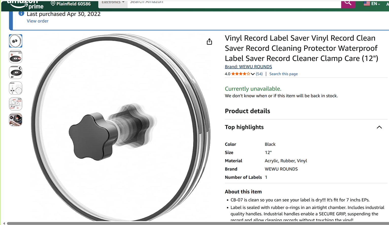

    edited December 2025
    I thought I got them from ebay but turns out it was Amazon. The ones Wewu Rounds sell on Amazon now appear to have a rubber seal around the perimeter. Might try ebay for LP label savers and see what you come up with. I don't recall paying 20 bucks each for three back in 2022.
    I'll have to measure the spacers provided from Vevor, once I get home.
    They looked to be about 1/2" to possibly 3/4".
    Probably wouldn't be too difficult to add some form of rubber ring to them, to seal out water. But the batches I ran, none of the labels got wet.

  • marvda1
    marvda1 Posts: 4,962
    I got one of these to slow down the rotation and clean one album at a time for 15 minutes as recommended by one reviewer.
    https://www.amazon.com/dp/B0BKPZZV83?ref=ppx_yo2ov_dt_b_fed_asin_title
    Puritan PSM156

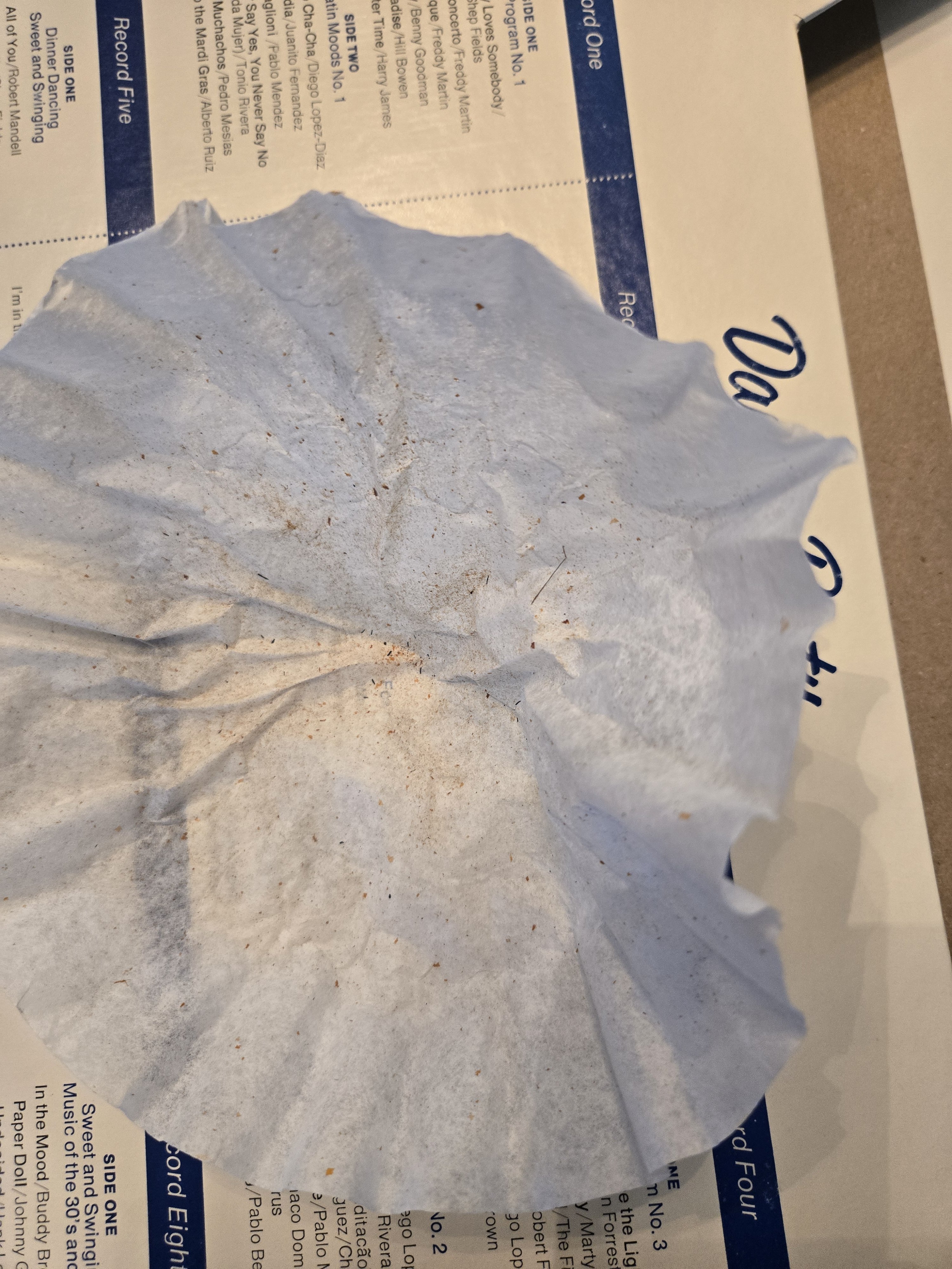

    I don't have a large record collection, so I had cleaned them all with a Spin Clean.
    They looked very clean to me until I used the Vevor, take a look.
    Puritan PSM156

  • skipshot12
    skipshot12 Posts: 2,092
    ^That came off your record?
    Nice to see that's not getting pounded into your grooves.

  • marvda1
    @skipshot12 it came from the grooves as the spin clean had the outside spotless.

  • Upstatemax
    It’s a “dual power supply”.
    The ultrasonic has its own plug/supply, the motor to rotate the records has its own supply.
    So, no impact on heating/ultrasonic.
