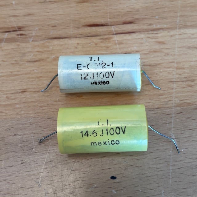

  • Recap update with new questions (just what you've been waiting for)! I was able to track down an MW6500 driver, and I was pleased that I was able to successfully recap the 7's as I had not done that before. I decided to go more of a budget route with caps as I saw numerous posts of others who had done that and were satisfied. I used a Jantzen Cross Cap for the 12uF and Standard Z-Cap for the 33uF cap. I also used one Jantzen resistor and one Mills resistor. Unfortunately, the speakers for the most part sound the same. Dull highs even with the Peerless tweeters and bass that should be tighter. When I compare the recapped 7's with my original 5's the 5's have crisper highs and tighter bass, even with the flawed sl2000 tweeter. Doing the recap I did notice something that raised a red flag. The caps for the high frequency looked original but did not appear to be the same uF. I'll attach a picture to show. So have I stumbled across some 7's that had some work done already, and is there something else to consider to get them to sound up to their potential? Or was using Jantzen caps a big mistake? Any input is appreciated.

    With the +/- 10% or so both of those caps could theoretically be very close to the same value.
    F1nut Posts: 52,006
    The Cross Cap was not a good choice.
    Sound: Like many basic quality MKP's they lack sophistication but their overall tonal balance is quite neutral. Due to their very low cost they are ideal for parallel capacitors in the low-pass of a woofer for example where in low budget systems electrolytics are often found. Also fine in basic quailty parallel correction networks. They are also quite compact in size, so they can turn out handy when space is critical.
    The Superior Z is MUCH better.
    The 14.6uF was wrong, the 12uF was correct.

    Weird. Never saw a 14.6 ever in a M7. Do both crossovers have the same dates, which were usually scribbled on them with a grease pencil back then?

  • pitdogg2 you're probably right but it was still a surprise to see the different caps that appeared to be original in the two crossovers. The speakers do have a store sticker on the back of them so maybe they had been reconditioned with available mix and match parts at one time.
    F1nut you're also probably right about the cap choice. I'll give these time to break in and if I'm still unsatisfied maybe I'll replace the high frequency caps with the sonicaps that you and others suggested. There were a number of satisfied recappers though who had used budget options like Dayton and Jantzen who shared their stories here and on other forums which is why I decided to give that option a try.
    Gardenstater I should have looked for those dates on the crossovers but did not. When I take them apart again I'll check. The stickers on the back of the speakers are from "Sound Company", a no longer in business audio shop in San Diego. I suppose it's possible they got a hold of these years ago and used whatever parts they had on hand to replace non working components in order to sell them. Although it did not look like the board had been desoldered/resoldered.
