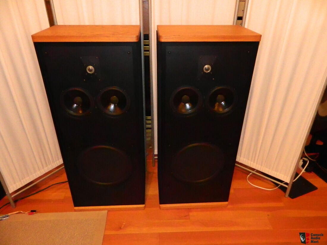

    pitdogg2 Posts: 27,186
    That sounds like SDA 2b. They are a much easier load on gear. 6 ohm IIRC
    My speakers look like this and as I said they have the blade/pin plug for the interconnect
    SDA 2b all day.

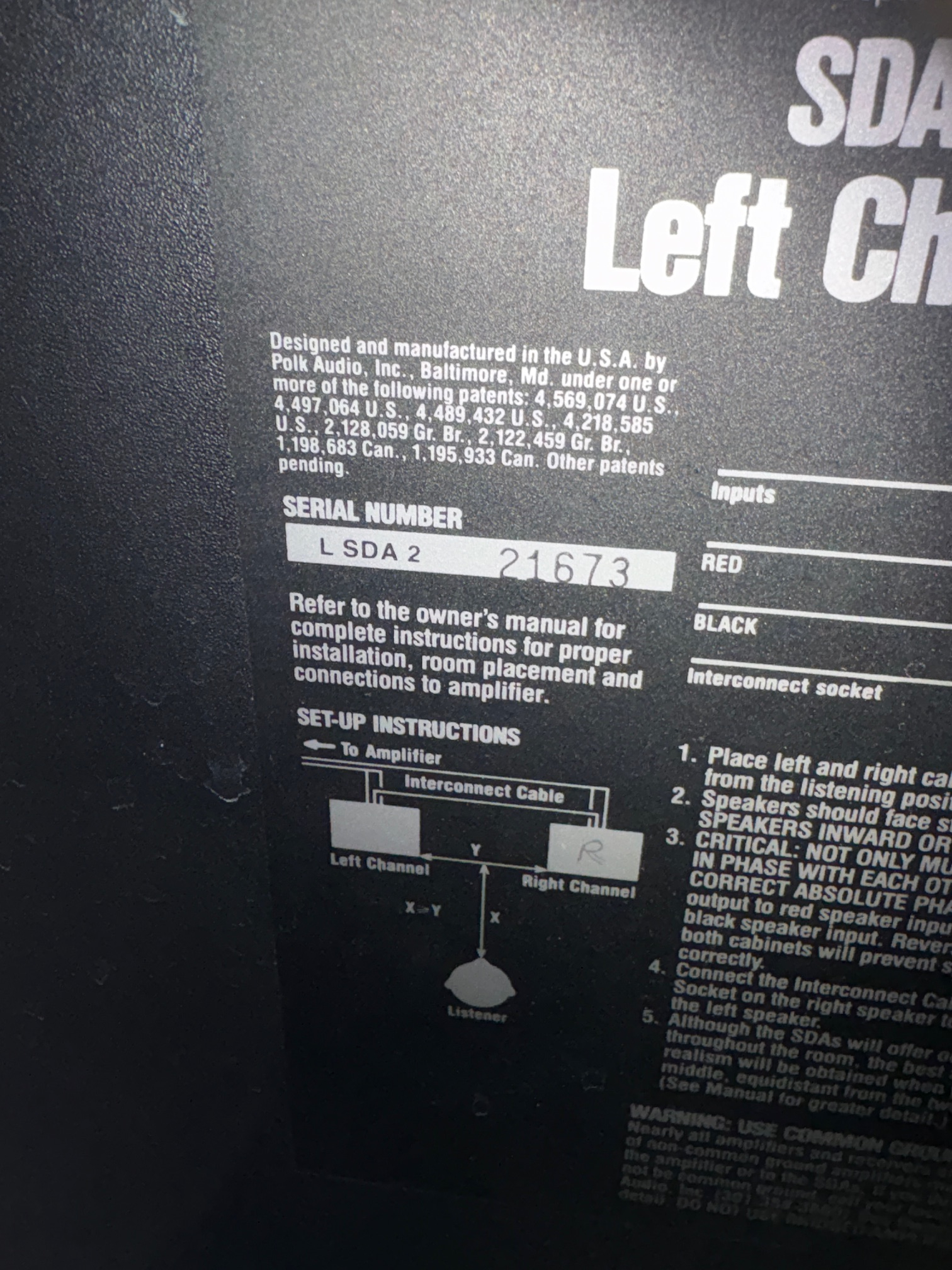

    audioluvr Posts: 5,977
    Do they say "SDA 2 A on the back of one? I wonder if those are my old ones.
    I had a closer look at the label on the rear of the left speaker
    I also got hold got hold of a B&K ST2020 power amp and this is like night and day compared to the Yamaha I was using to power the Polks. The Yamaha would be running out of steam at higher volumes and the B&K is barely at a 1/3 volume.
    My old ones had that SDA 2 but then a square sticker with red background and a white A. But later found out they were actually B's
