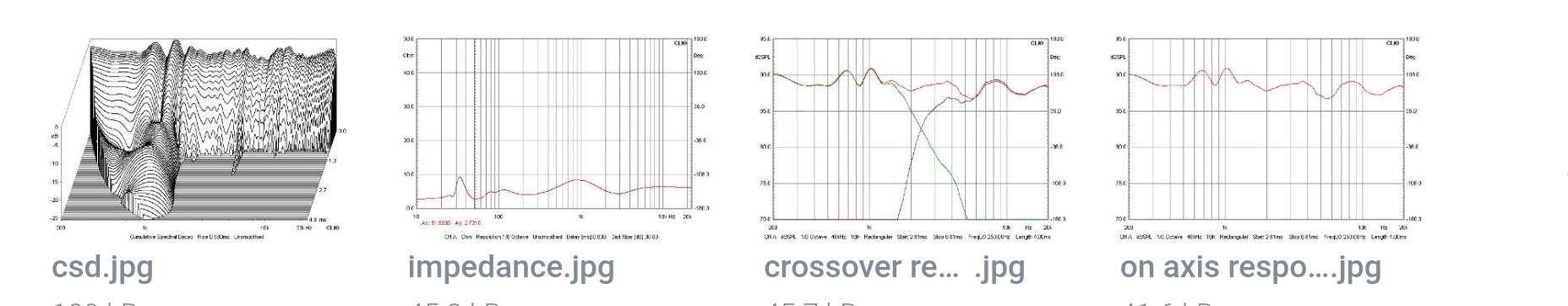

Ok. Not 100% convinced because he's selling the product. Next i contract another tester and builder to get pricing. He said kinda the opposite. But his testing is a different speaker. The Lsi9. But said they use the same MTM section. Don't know what that is. And he sent me charts to prove it. Suggest I buy his DIY kit for less and will outperform. Here is his quote
"I measured and tested the Polk LSi9's twice. They have some significant break up issues in the woofers range that I cannot fix. See attached measurements.
Your model uses the same MTM section.
The impedance was really low on those too.
If it were me, I would start over. We have some really high quality DIY designs that will outclass them significantly and for less money than you would spend trying to upgrade those."

Attached is the image of tests. (For different model lsi9) he's claiming the same.sxrsp4jnvqow.jpg

    Was that Danny Richie who tested the LSi9? Looks like his plots. Can't find any youtube video on that speaker done by him.
