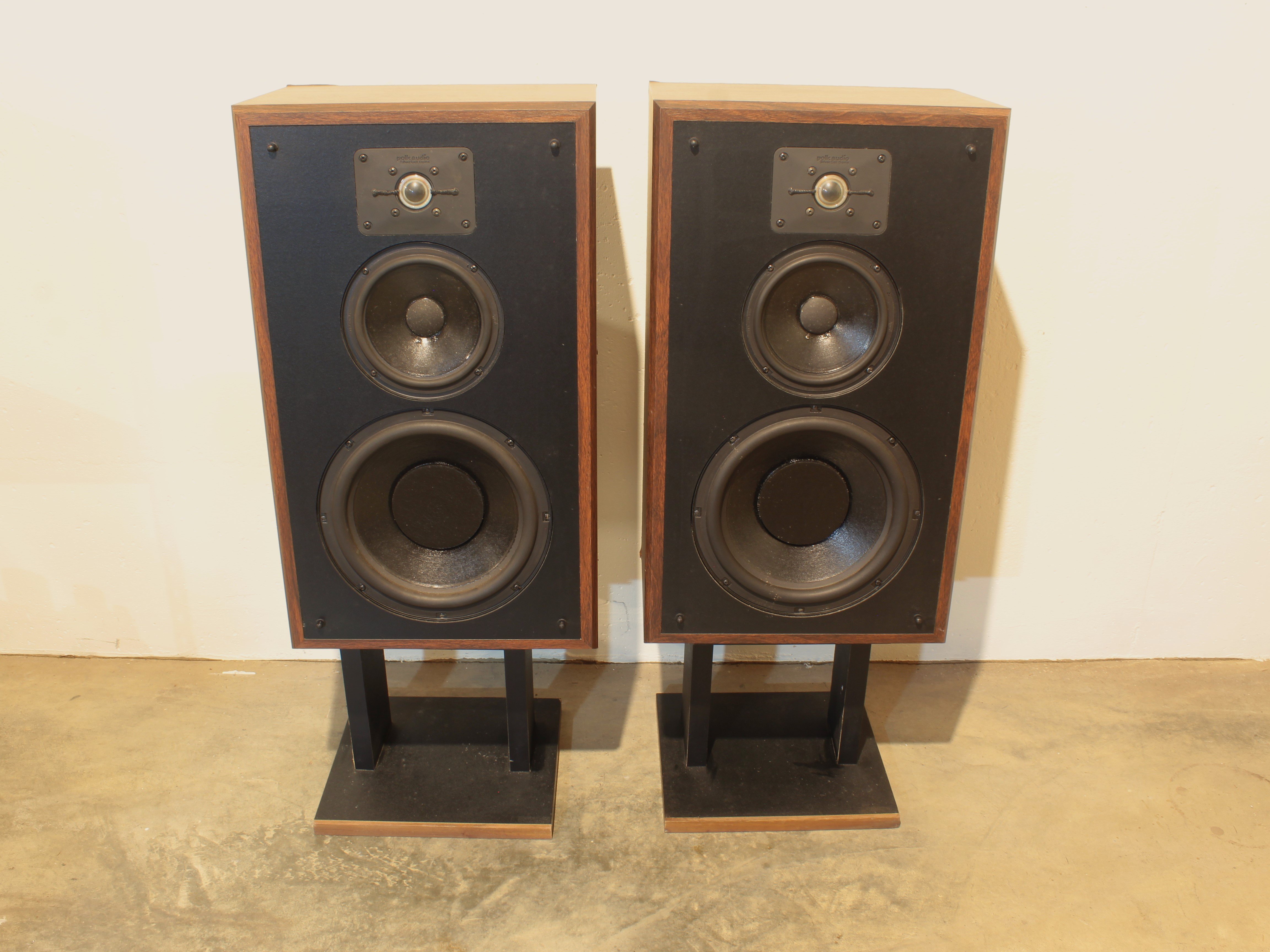

I have been trying to do a modest set up in my basement, which is unfinished, and serves as the smoking area of the house. So far, my system is a Pioneer RT-1020L reel tape deck, and the two Polk speakers I just got Saturday (09/13/25). I have the power source coming in the mail 09/15/25, a JVC JA-S44 integrated amp w/equalizer (45wpc). The Polks are pretty nice, with edge/corner damage in the back of speakers only, with the fronts of both like new. The grills are also fantastic.

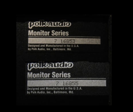

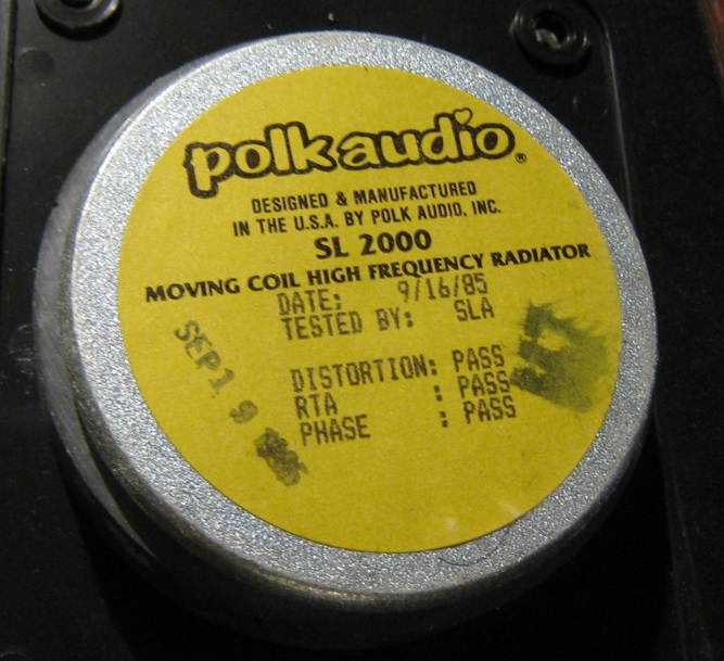

Now, as to what model 7 series I have, other than the serial number sticker on the back saying just '7', I learned that pulling the tweeter and looking for the tweeter model #, and I find it's says SL2000, 1985.
Other than pulling out one tweeter for series model ID, I have not done anything else. The surrounds are nice (rubber materiel).
Inspections and tests on the to do list, check ohms on the tweeter and driver. Then inspect the crossover. Other than the seller demo-ing on a Sony (black) receiver to hear them (which as they are now, they sound good to this ole man with bad hearing), I will see about changing any caps or diodes? Oh, I got some nice speaker stands along with the sale. I really like the wood trim on the bottom of them. I really like the front cabs how they curve out, (ie. like advent bullnose??) sort of.
On the one tweeter I pulled, I see what looks like (stamp) M7 ??? (for Monitor 7)??
Well, in closing, I got these Polks picked out from a short list from FB marketplace I was shopping. (BA HD10, Advent 5002, BA 40, Polk Monitor 5). I am real glad I got the Monitor Seven.

    Congrats and welcome! Those are Monitor 7C and the updated/upgraded silk dome tweeter for them is the Polk RD0194-1 That's a Zero not an O.

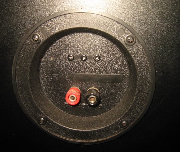

    The midwoofers should be the MW6502, which is something you should check, along with making sure there is no rubbing of the voice coils which would indicate magnet assembly shift due to adhesive failure. If there is absolutely no rubbing you should glue the magnets to the front plate and the back plate in the form of a continuous fillet or intermittent fillets. You can use JB Weld epoxy and a popsicle stick for these drivers. Also check for correct phasing. The positive binding post is the red one and should be on the left side when looking at the backs and make sure each midwoofer is correctly wired the same so positive (black wire) goes to positive on the speaker which is the terminal with the red dot.

    Nice speakers that can be made much better by getting rid of those nasty SL2000 tweeters. Call Polk, mention you are a forum member and get a small discount on the RD0-194-1 tweeters.
  • I found this sample on identifying Polk Audio Monitor 7's. I just opened up my Monitor 7's and the SL2000 with the speaker clips being the same size, confirms the indenty and that the info provided is accurate. wzyj3kofiz62.jpg

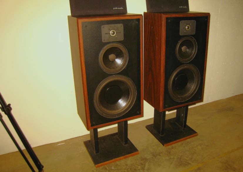

    here are a couple more photos
  • I just contacted Polk by phone to order the RD0-194-1, and they are $60.00 each before discount. I just hope they reduce the "shrillness" some. The SL2000 are great for some music, but, not for all. I had tried placement>up, down, tilted, equalizer<and I am going to give the RD0-194-1 a try.

    FWIW the difference between the SL2000 and SL2500 is readily appearent just by looking at the dome and front of the tweeter.
  • The positive wire is black.

    The very early 7C, before they went to the polyswitch, had an external fuse and the SL1000 tweeter. Late 7B had the SL1000.
