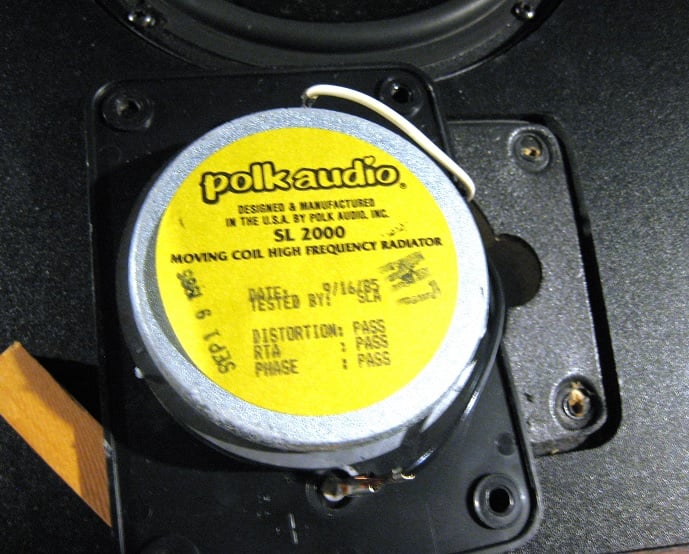

Now, as to what model 7 series I have, other than the serial number sticker on the back saying just '7', I learned that pulling the tweeter and looking for the tweeter model #, and I find it's says SL2000, 1985.

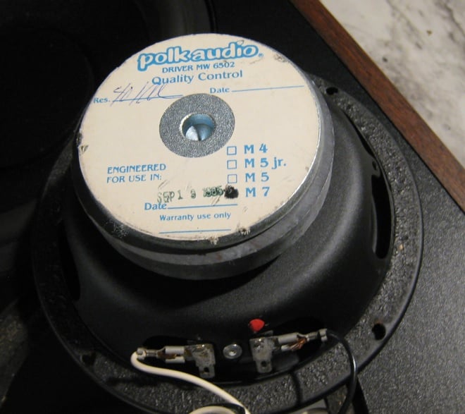

    Congrats and welcome! Those are Monitor 7C and the updated/upgraded silk dome tweeter for them is the Polk RD0194-1 That's a Zero not an O.

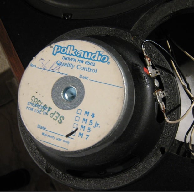

    The midwoofers should be the MW6502, which is something you should check, along with making sure there is no rubbing of the voice coils which would indicate magnet assembly shift due to adhesive failure. If there is absolutely no rubbing you should glue the magnets to the front plate and the back plate in the form of a continuous fillet or intermittent fillets. You can use JB Weld epoxy and a popsicle stick for these drivers. Also check for correct phasing. The positive binding post is the red one and should be on the left side when looking at the backs and make sure each midwoofer is correctly wired the same so positive (black wire) goes to positive on the speaker which is the terminal with the red dot.

    Nice speakers that can be made much better by getting rid of those nasty SL2000 tweeters. Call Polk, mention you are a forum member and get a small discount on the RD0-194-1 tweeters.

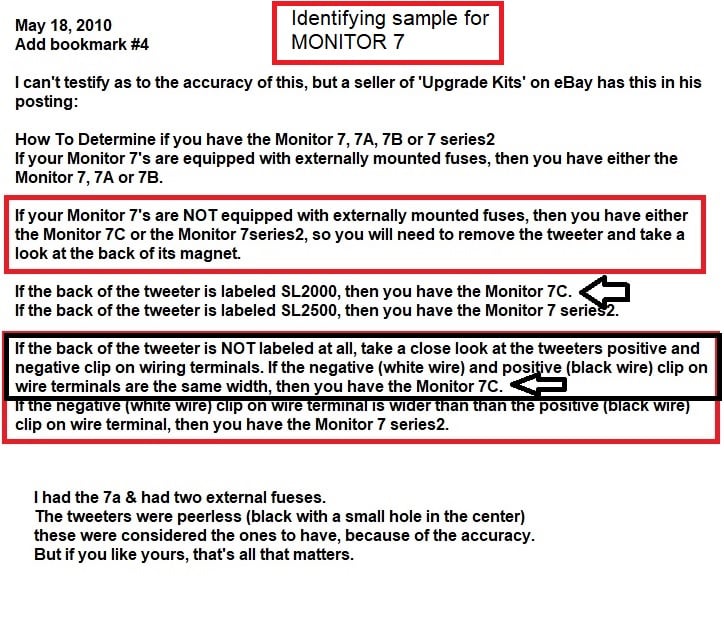

    I found this sample on identifying Polk Audio Monitor 7's. I just opened up my Monitor 7's and the SL2000 with the speaker clips being the same size, confirms the indenty and that the info provided is accurate. wzyj3kofiz62.jpg

    I just contacted Polk by phone to order the RD0-194-1, and they are $60.00 each before discount. I just hope they reduce the "shrillness" some. The SL2000 are great for some music, but, not for all. I had tried placement>up, down, tilted, equalizer<and I am going to give the RD0-194-1 a try.
    pitdogg2 Posts: 27,884
    FWIW the difference between the SL2000 and SL2500 is readily appearent just by looking at the dome and front of the tweeter.

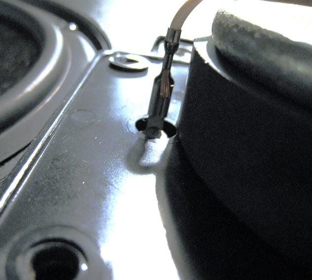

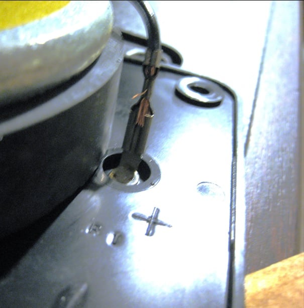

    The positive wire is black.

    The very early 7C, before they went to the polyswitch, had an external fuse and the SL1000 tweeter. Late 7B had the SL1000.
