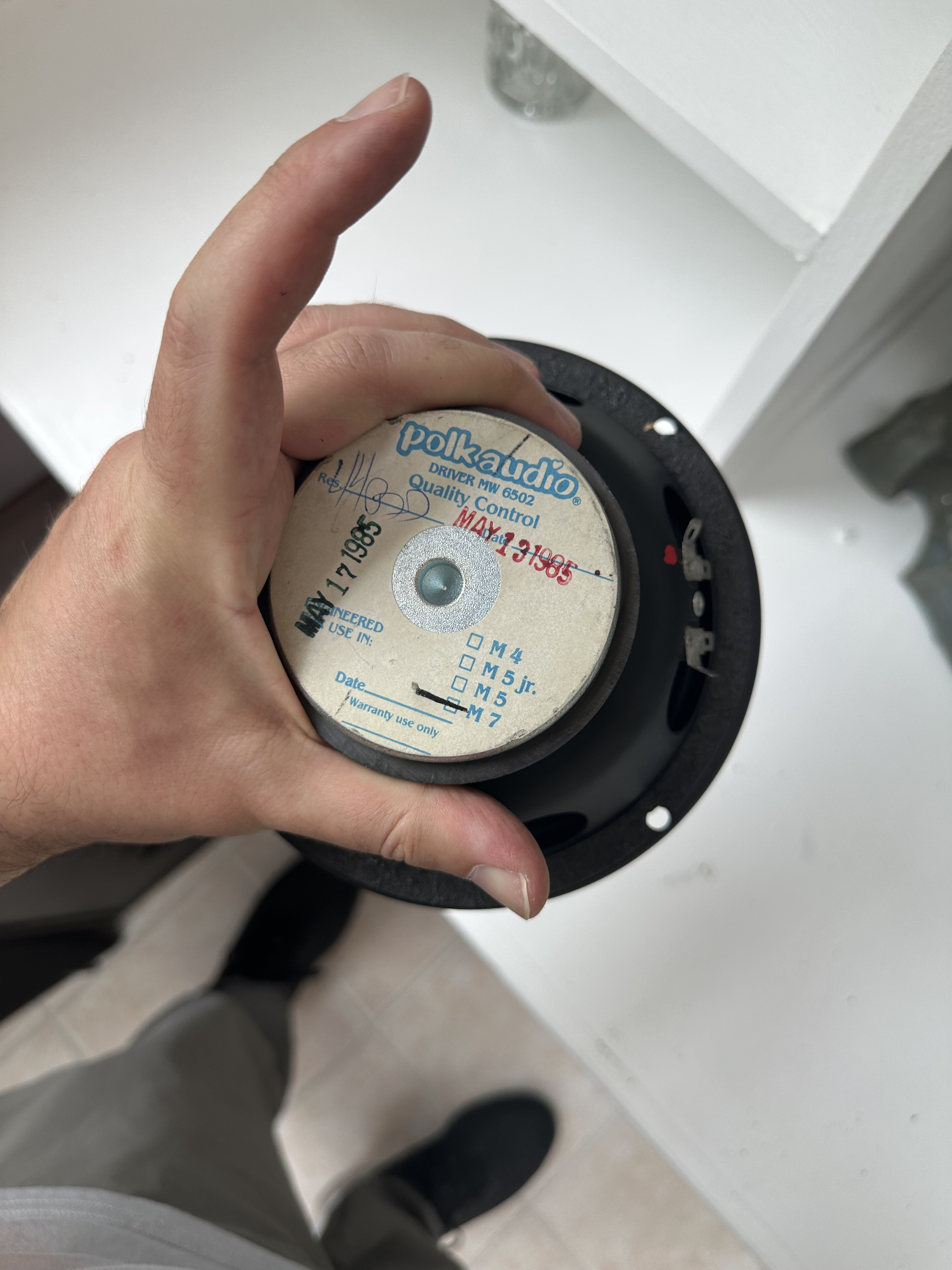

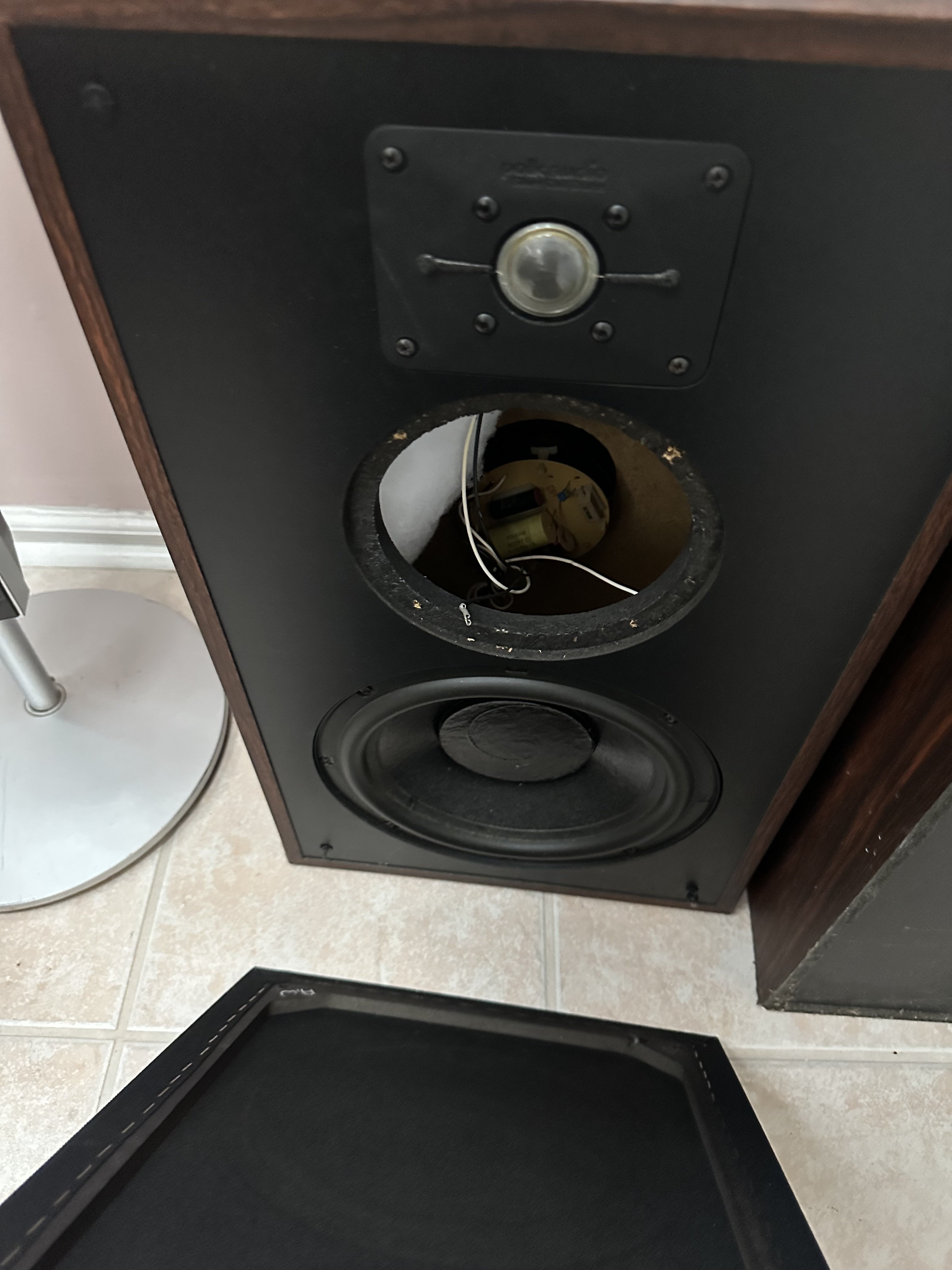

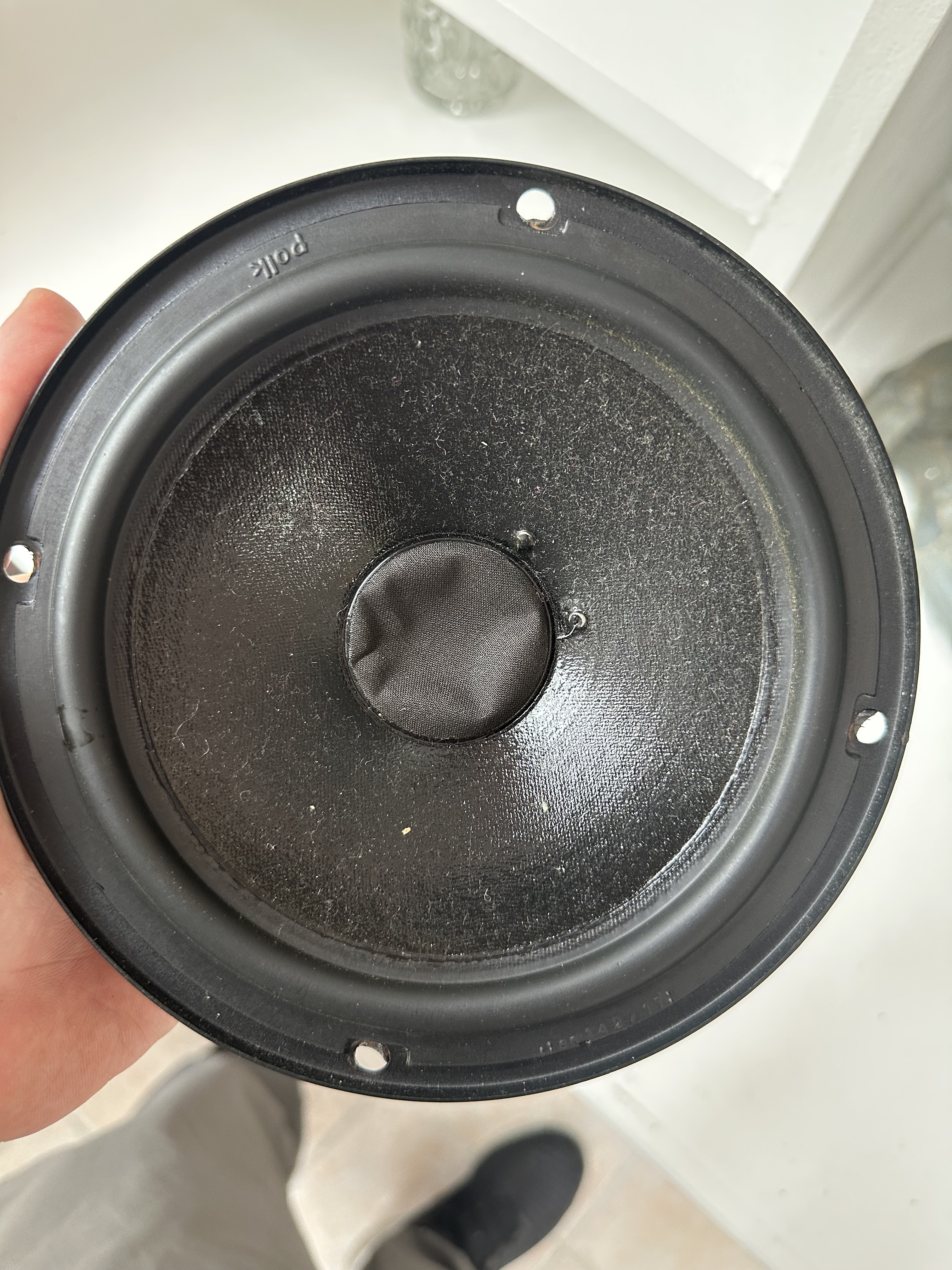

I have a set of Polk audio speakers I enjoy the sound of. Recently had one speaker work fine but start to crackle. The middle part was pushed in and I thought that was the issue but managed to vacuum it back to normal. The other doesn’t make noise. Both tweeters in the box work. Bottom speakers in the box aren’t wired which isn’t something I’ve seen so I don’t know how they work. I tried attaching a video but it will only let me upload pictures.

    pitdogg2 Posts: 27,921
    Bottom woofers are passive radiators. They work from the back wave of the active mid-woofer to produce bass.
    Does the active woofer move freely? When you place 3 or 4 fingers around the dust cap and push in as evenly as possible do you feel scratchy as it moves?
  • speakerfix
    Ok that makes sense. Yes they move freely but do make a scratchy noise.

    SeleniumFalcon Posts: 4,405
    That sound can sometimes be caused by uneven pressing on the cone. Make sure you are moving the complete cone as a single unit when you press, no one side getting more pressure than the other. If you still hear the scratchy sound this can be caused by either a shifted magnet structure or a voice coil that has been heated sufficiently to cause a warping of its shape.
    Chances are the magnet has shifted a bit. It is a well known problem. There's a fix but it is a very involving.
    The other issue could be corrosion in the pole piece area with the voice coil. Those that have taken the magnet and voice coil apart have documented corrosion between the parts.

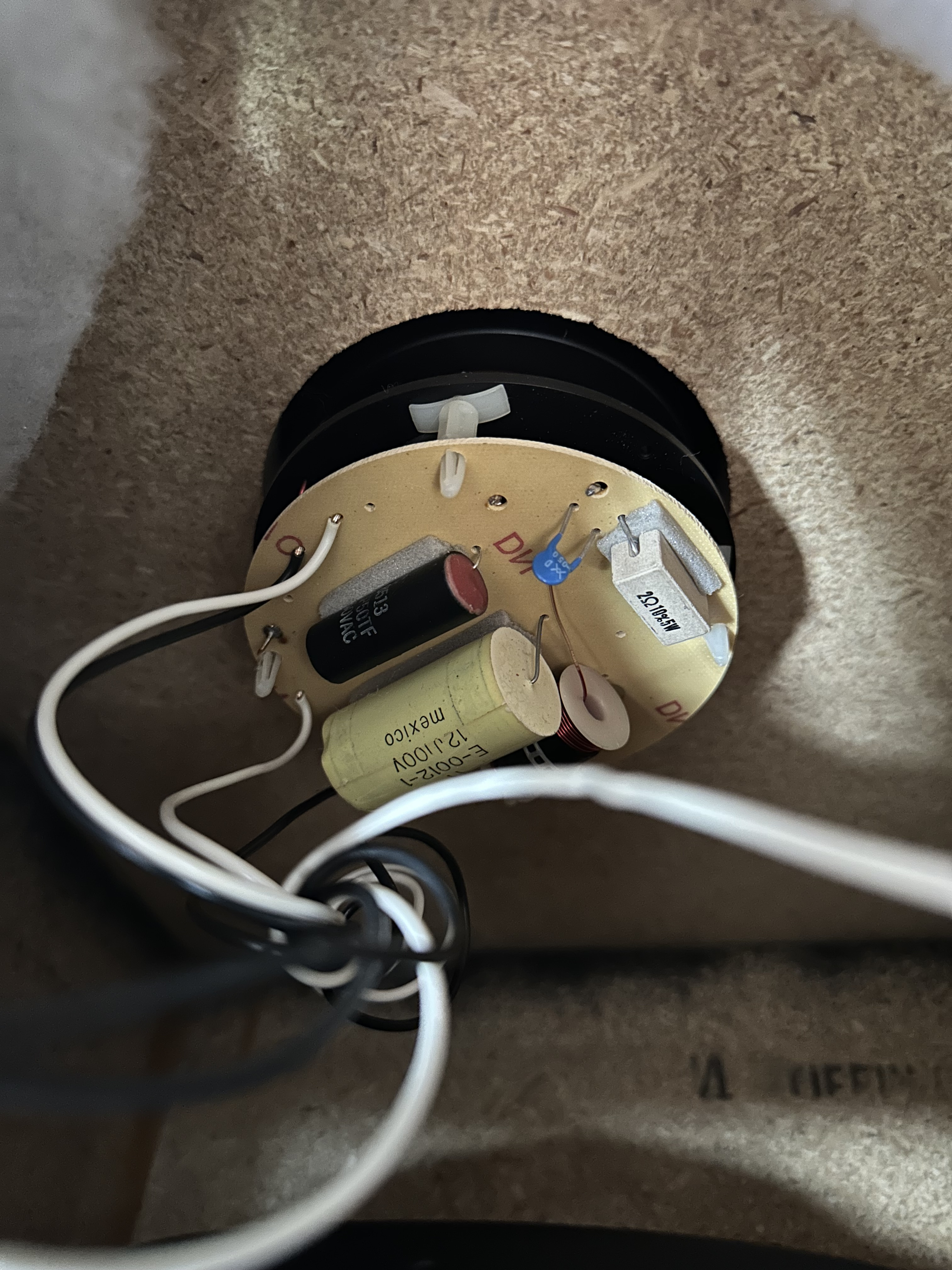

    How would I test for those things. I dont know how to tell if the magnet shifted or not. I searched for videos that show some magnet repair but didn't get a better idea. Does scratchy mean anything? it seems that could be a sign of the magnet shifting. The only thing I know for sure is one measures 3.8 ohms and the other measures 0. I want to try to measure the electronics on the crossovers to see if I discover anything out of spec, but read online I have to take them off the board to get an accurate reading. It should be either new board components or new drivers if they're bad correct?
    edited April 2025
    Did you disconnect the wires from the driver before the ohm test?
    If so then the zero driver is cooked.
    The driver measuring 3.8 is in the correct ohm range.
    If you do buy some, before installing them glue the magnets with original JB weld two part epoxy to the top and bottom of the magnets. Craft (popsicle) sticks are your friend.
    Yes I did. They were disconnected and removed from the box. I will need to look up a video to do that properly.

    speakerfix wrote: »
    The vacuum was a pretty brave and bold move.
    A friend of mine has a audio shop - repairs to some fancy stuff, replacing speaker surrounds etc.
    When that centre cone has been somehow pushed in, I have noticed they use "Prestik", from Bostik to pull them back out. The Prestik is gently heated to make it very soft and pliable, then gently placed on the centre cone. It is allowed to cool again for about 10mins, then the centre cone is gently pulled out and back into position using the Prestik. It makes sense as one has complete control over the process.
    grantza wrote: »
    No it's not.
    The dust caps on most of the Polk driver are open mesh, not felt or plastic. It fact you can see right through them to the pole piece.
    Holding the driver in place and a quick on/off is sufficient to pop them right out. We've used this method for dacades.
