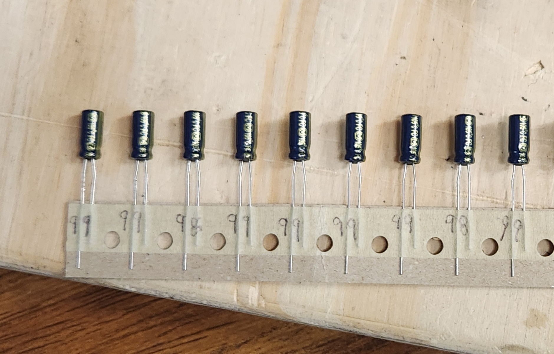

    I used mostly Panasonic FC for the Teac A-6300 recap. The entire tape of 10uf 50v, about 40 total, measured mostly 9.8-9.9uf on the Sencore Z meter. Had some exact and 10.1. (I didn't use a decimal). The other values were similar.

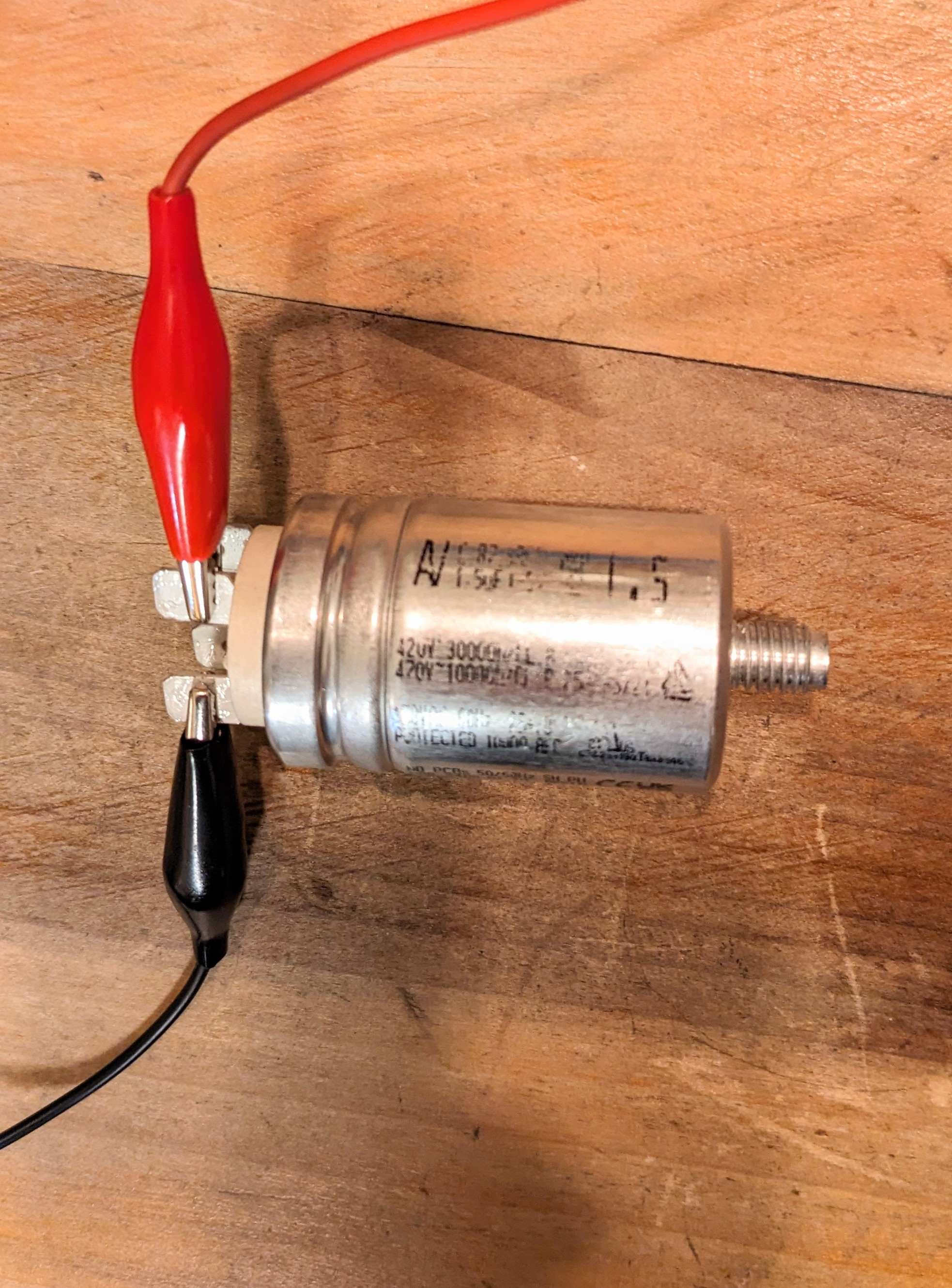

    I just replaced a motor run cap in an old Sony TC-500A reel-to-reel tape deck.
    This is actually a film cap in an Aluminum canister. It's 1.5uF 470V 5%, made by Kemet. The motor was bogging down when under load, and this new cap seems to have fixed it. From what I read, it is a common problem in the old Sony RTR decks.

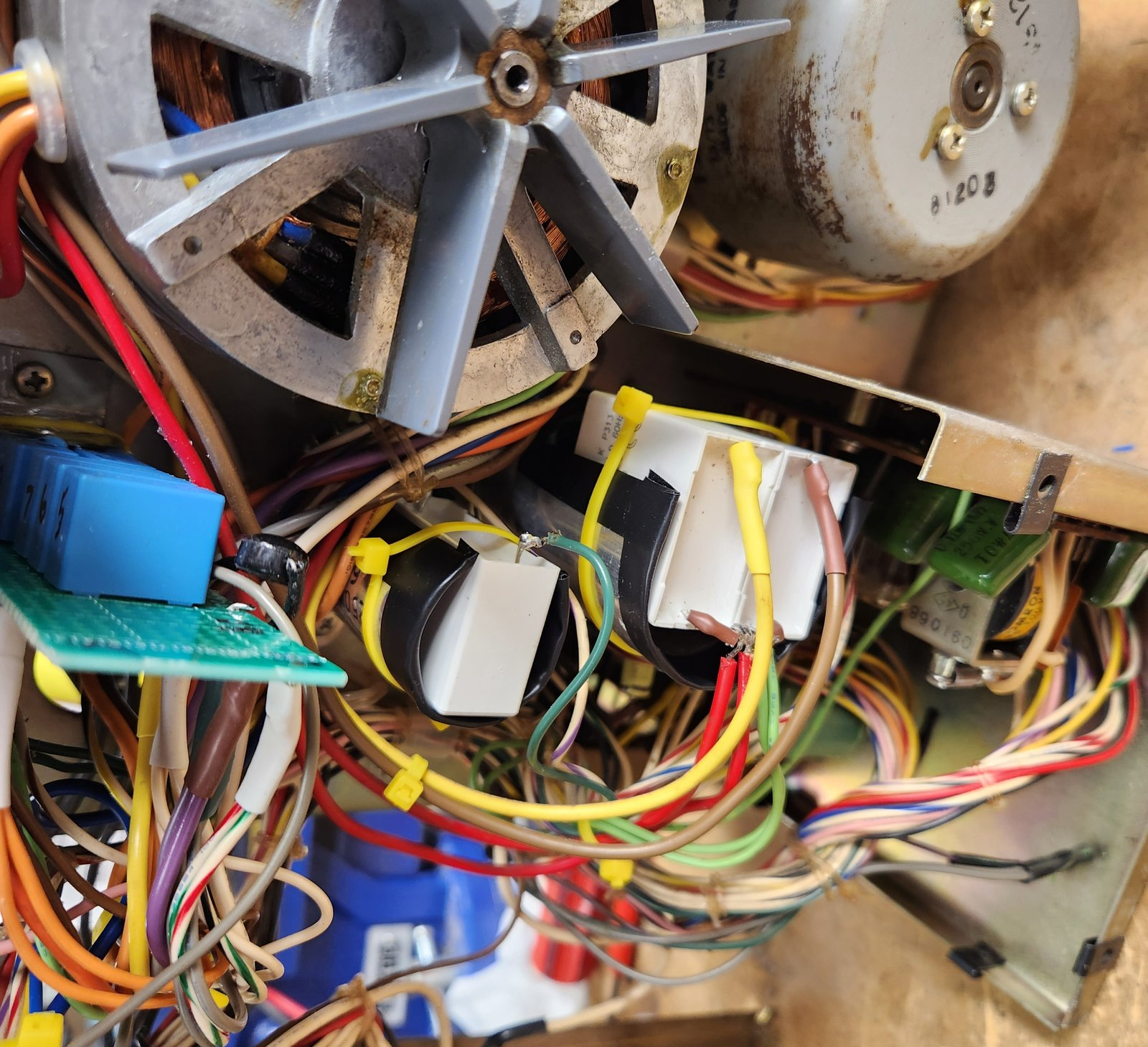

    I had a bad capstan motor run capacitor in a Teac 4010SU R2R. I also replaced the reel motors run capacitor.
    Some folks use ceiling fan motor run capacitors of the appropriate value. They control motor torque so best to replace with same value. It was common for the motor run caps to have multiple values for 50/60Hz operation. 50Hz required a bit more capacitance, typically adding ~1uf to the 60Hz value. When replacing I delete the 50Hz values since we live in 60Hz land. The 50Hz wiring ends, if so equipped, need to be insulated and secured.
    US only models with no 50/60Hz switch typically used the same 50/60Hz cap, just no wires attached to the smaller value.
    I used Nichicon MAB motor run caps to replace them. I gutted and cut a slot in the old can capacitors which made it easier to secure them.

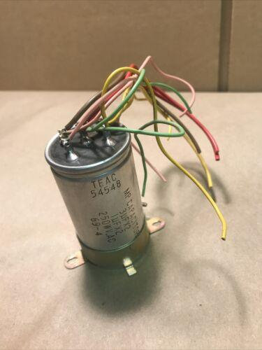

    Not my pic but an OEM reel motor run capacitor with mounting bracket. Two 3uf and two 1uf.

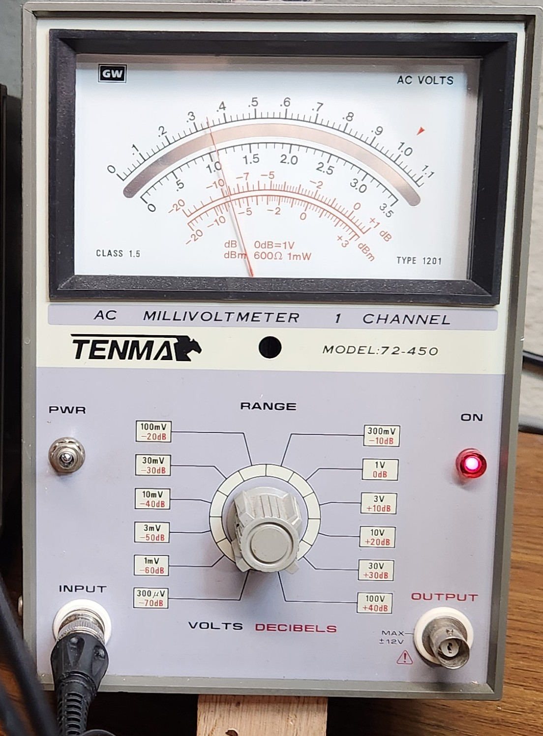

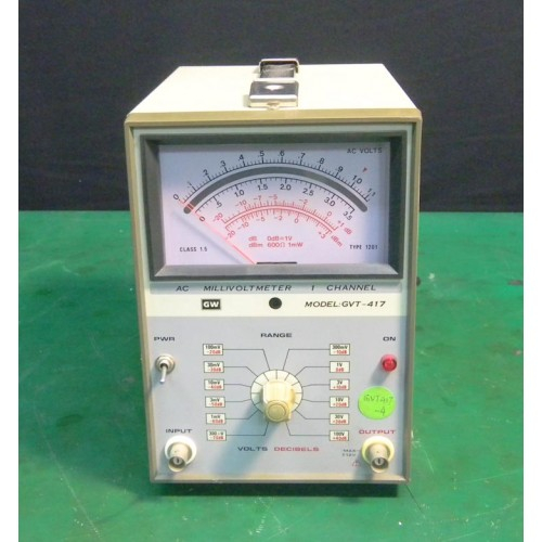

    R2R calibration can be the other expensive part repairing them things. I had signal generators and scope but needed an AC millivolt/dB meter. Multimeters are typically not rated for high frequency accuracy. Leader is the most popular but also the most expensive on ebay. I got a Tenma 72-450 for $50. It is a rebadged GW Instek GVT-417. The meter even has GW on it. Seems like folks caught on as the Tenma now sells for $100 or more.
    I found an op manual but no service manual for the Tenma. GW is still in business, and they sent me a service manual for the GVT-417/427 so I can calibrate it, if needed. GW stands for Good Will.
    Calibration tapes are pricey. The typical go to are MRL which are expensive. Then you need one for each speed to calibrate. MRL typically have only four frequencies. I purchased Teac replica calibration tapes from ebay seller ural91 (Germany). Those included multiple frequencies so you could test frequency response from 31.5-16kHz. He also put both speeds on one reel to save on shipping.
    Purchasing old used calibration tapes is gambling. They could be stretched, partially erased or suffering from "sticky shed syndrome."
    Old tape calibration was 185nWb/m. I calibrated the Teac's to 200nWb/m. Playback would calibrate higher (250nWb/m) but I couldn't get record calibration to match. I biased them for newly manufactured tape, RTM LPR35. My calibration tape was done at 250nWb/m so I have to compensate for lower calibration levels.
    The Teac replica tape has a 30 second sweep to do it quickly though I prefer manually. Since the dB meter is single channel, I built an RCA switch box so I can quickly flip between R and L channels. They do make two channel meters, but they are more expensive.
