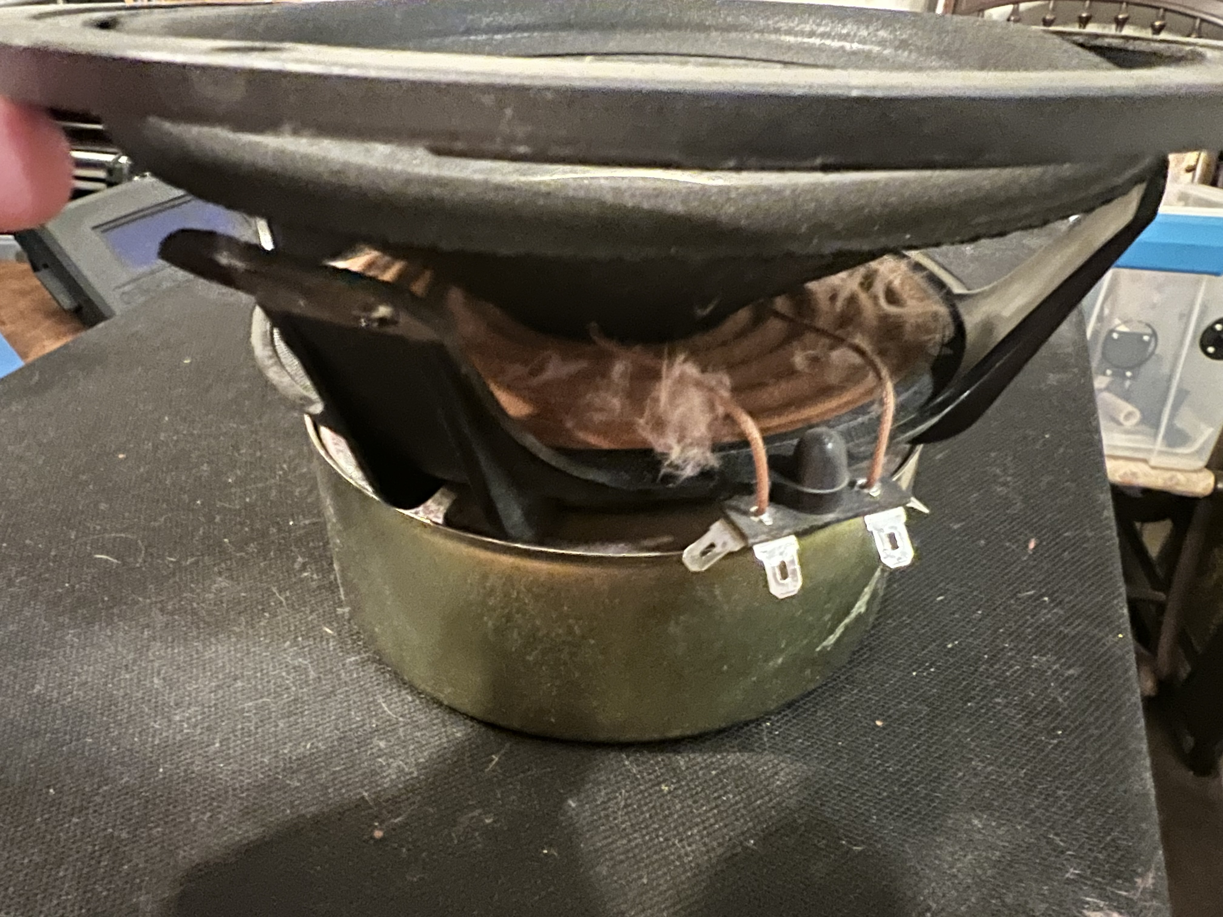

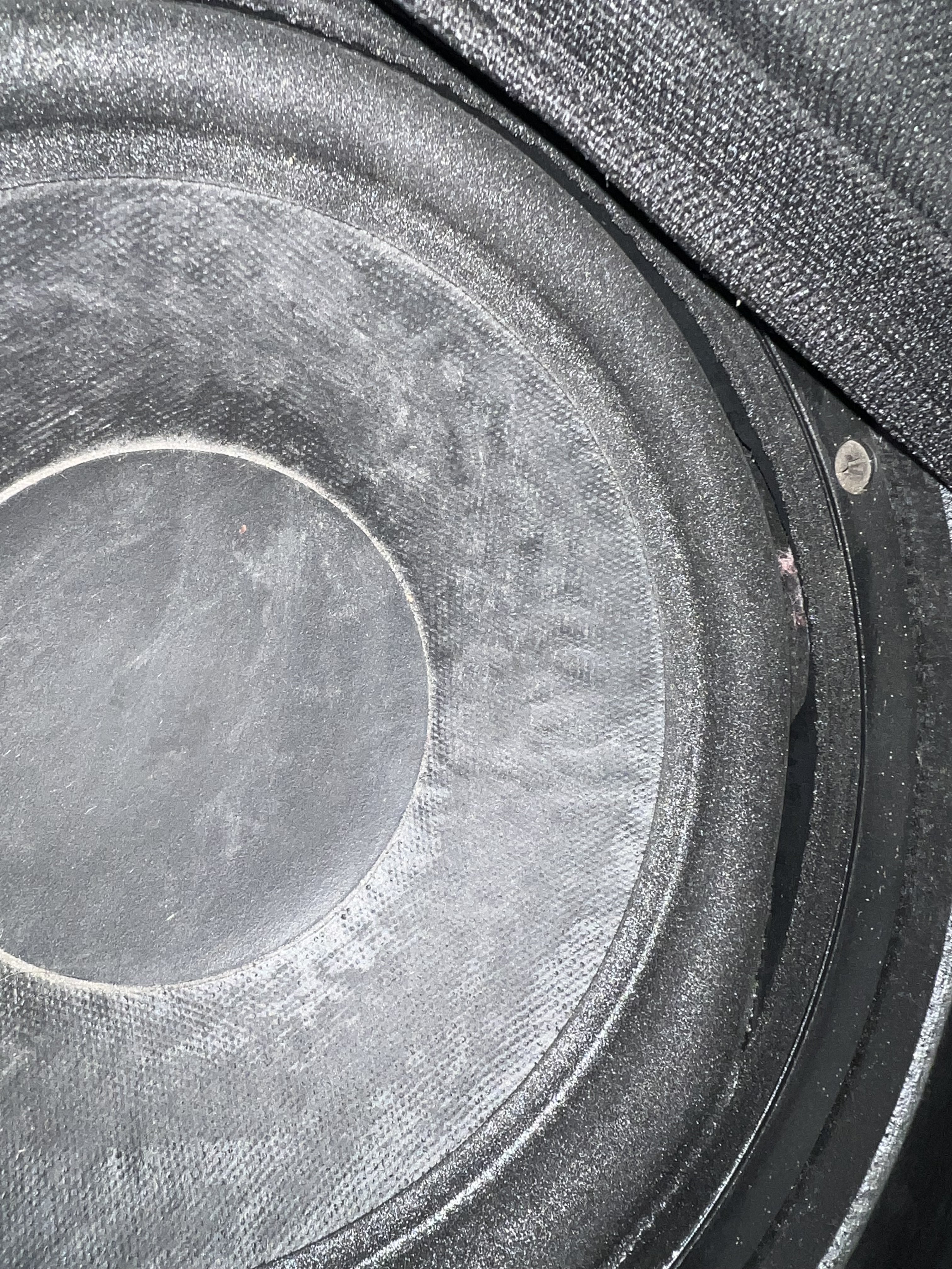

    Update: I ran across a CLR-2002 locally which I had been running for some time. Then two weeks ago @rooftop59 pointed me to a CLR-2500 on eBay that was missing sides but in otherwise working order which I snagged for 130.
    When it came in the sub driver was shattered but the everything else, including the amp, was fine.
    Got a partial refund from the seller and now my CLR-2500 is back up and running and I have acquired a second crossover for this project, along with spare mids and a tweeter so I’m considering this a big win.
    I kept the old amp as it is likely repairable, just not by me.
    Thankfully I have the schematic for it so that should help immensely.
    So now just saving up until I have enough to pay @VR3 to mod the L/R/C for me :smile: and keeping my eye out for BP-7002 amps and drivers….
    On a side note: I’ve never seen a plastic speaker basket until now. I guess no point in dynamiting it as it shouldn’t ring lol…
