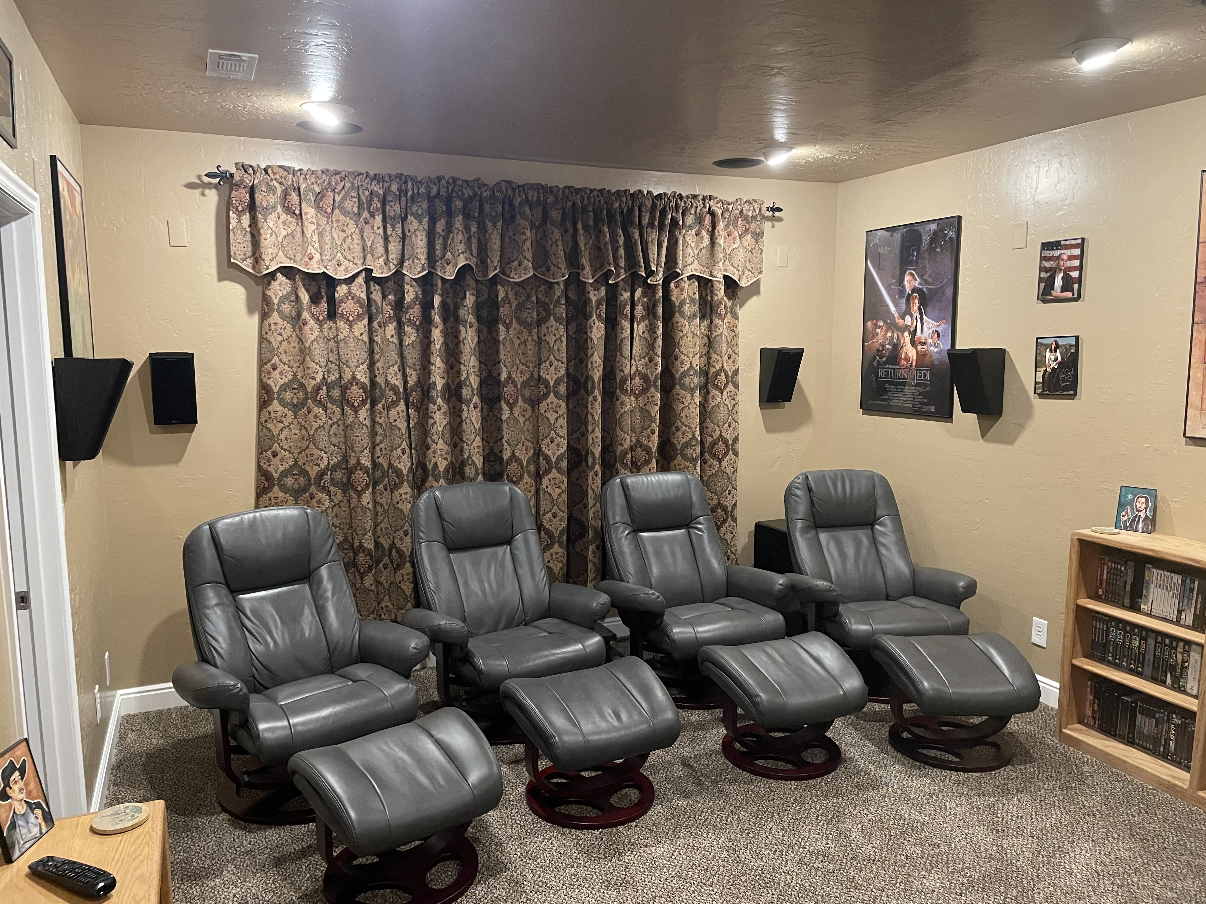

    Here's my current speaker setup for Atmos (work in progress).f86wz7ijv3pu.jpg

    I tried ceiling speakers many years back with a 5.1 setup and didn't like it. The rear height speakers were hung on the wall over 15 years back as rear surrounds with a 7.1 setup. The front height speakers I just hung are very secure. I've been to many sites, watched many videos about the type and position of the height speakers, then I experimented with various positions of the height speakers including Dolby recommendation. I found that positioning them right above the ear level front and back speakers gives the best effect. It also works with Auro3D. Most reviewers recommended small bookshelf instead of ceiling or upfiring atmos and positioning them right above the ear level front and back speakers. Dolby recommendation for height speakers feels too close to the MLP and doesn't give me that much separation. I mostly listen to music and very little movies.
