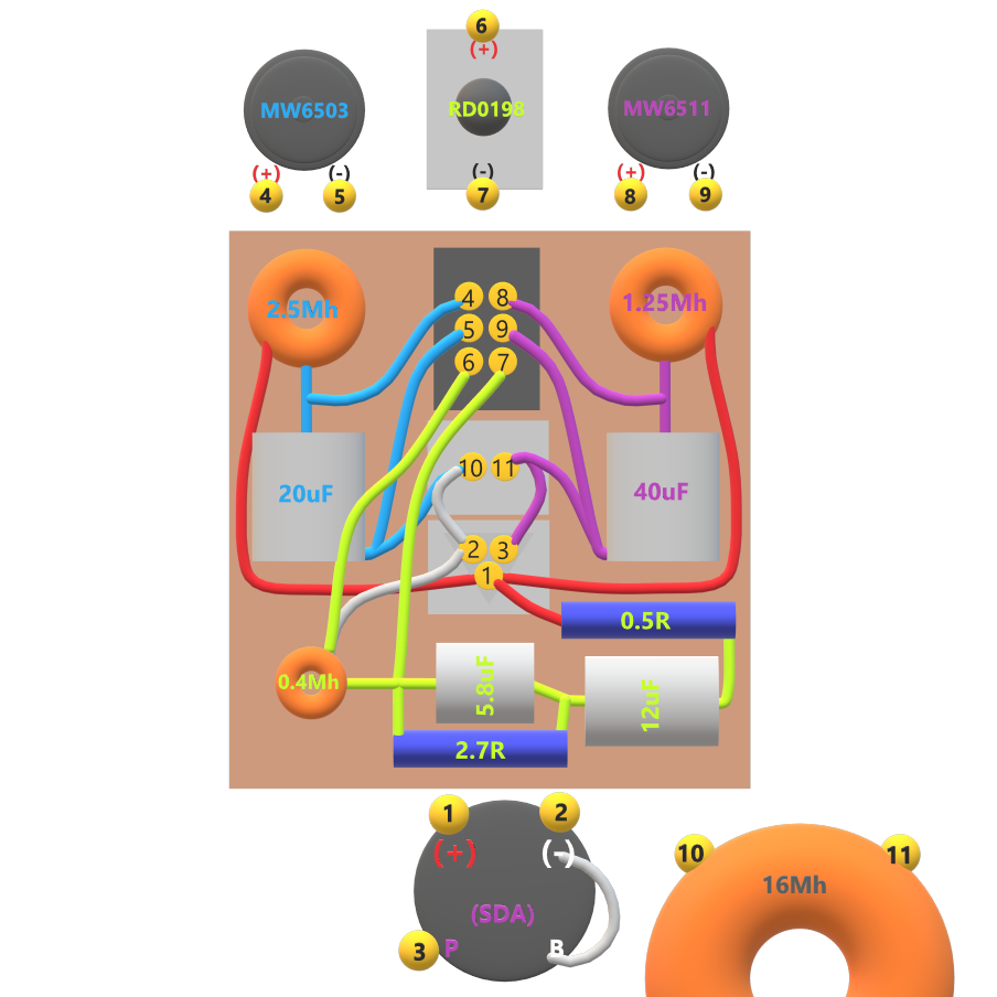

    I'm getting there... But this crossover thing is not as easy as it may appear.
  • drop1
    drop1 Posts: 68
    15 configurations later and I think I've settled on this
  • drop1
    drop1 Posts: 68
    For posterity's sake, #6 and #7 are switched in my diagram above.
    And... the most difficult part of this project is done.
  • gp4jesus
    gp4jesus Posts: 2,019
    edited March 2025
    Your Mar 19th post is awesome!
    That goes a very long way to help others follow in your footsteps while avoiding re-“invention of the wheel!” Don’t be surprised if others use something similar for other models😊
    *all connected w/Premiere ICs
  • drop1
    drop1 Posts: 68
    edited March 2025
    gp4jesus wrote: »
    That was simply my way of plotting out the circuit to make it easier for me to follow. I've swapped caps in a number of speakers before but this was my first full XO assembly. And I was only able to confidently do-so following in the footsteps of many forum posters here. I do not want to take any undue credit. Although I now understand why some people prefer to contract this out to others. It took a fairly substantial amount of time in planning and assembly.
    Post edited by drop1 on
