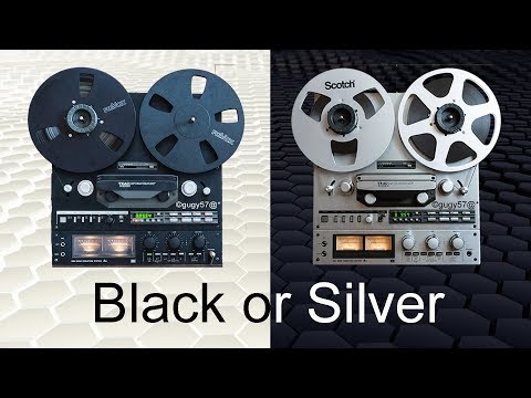

    Two of the decks are getting a new look. Like AC/DC, back in black. Thank you Carl! I kinda like the silver accents. The seller forgot to include the black mounting screws, but they are on the way. The black head cover was included, but some guys swap it out for a silver one.
    To get all black as Teac shipped it, one has to spend for knobs (like $25 each), VU meter cover, etc... The white VU meters are much easier to read than the black ones. Brighter LED's can cause more issues then they solve. Some guys have added white VU meters to their black X-1000r's.
    I had purchased a black VU meter cover for an X-2000r (cheap at $25 free shipping), but the black insert is different so I had to use my silver one. The lens and frame are identical to the X-1000r.
    A you tube video showing various X-1000r color combinations.
    https://youtu.be/XJAdm-xWHSE?si=lTXwOHDprDyPM28y
