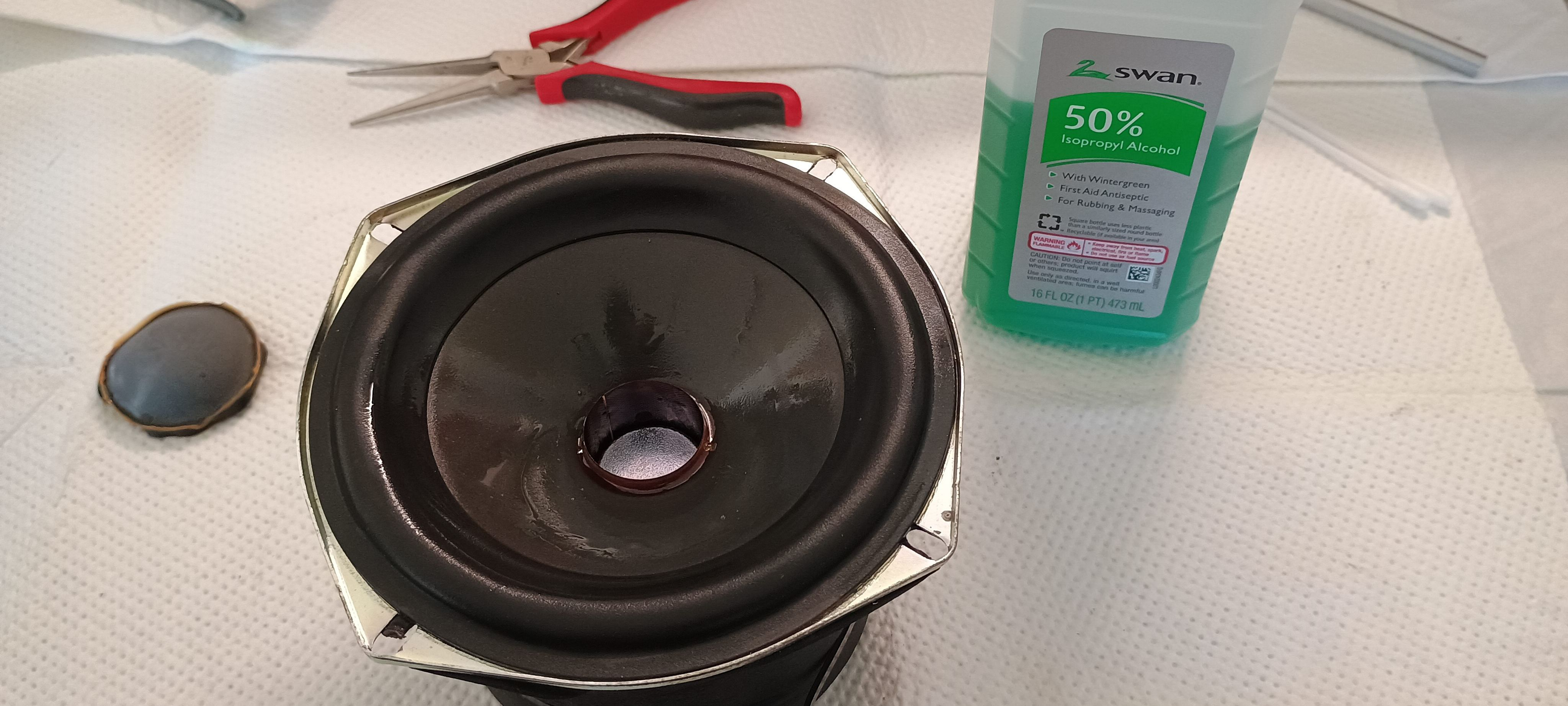

    If you have crappy midrange, the loose (and brittle) dustcaps are the culprit. I pulled them off by fingernails too easily and the edges where crumbly. One was dry-rotted and partially detached from glue....

    1 single drop wintergreen oil to capful olive oil is the sweet spot for fixing these dried out surrounds...

    What does wintergreen oil bring to the party?
    It brings a minty-fresh breath of suppleness. I tested a few solutions/concentrations and the isopropyl alchol dries up too quickly.

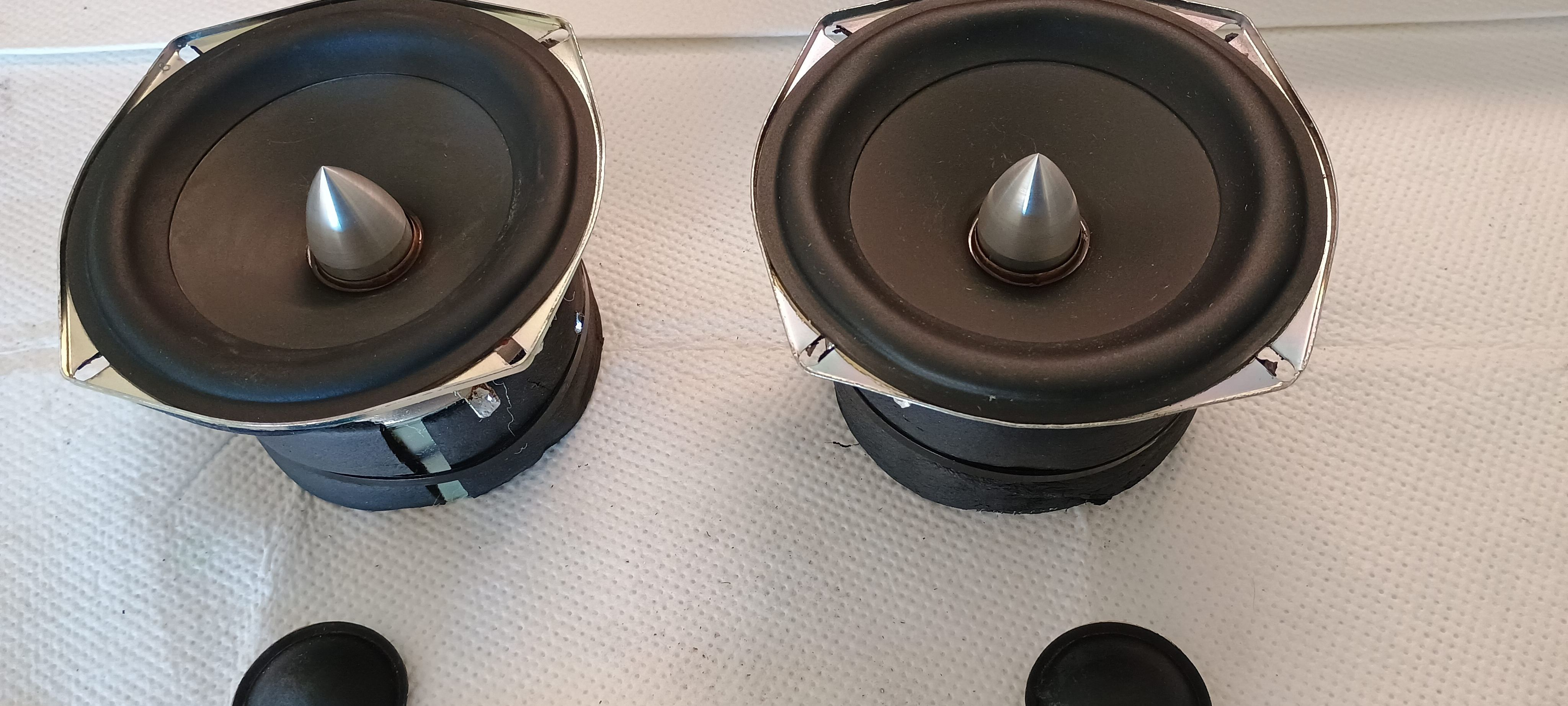

    RTiA 5.25" midranges in process...
    These will also need 0.180" shorter base phase plugs. The 50% Alcohol with Wintergreen is perfect for soaking dust cap perimeters and restoring the butyl surrounds on these without worrying about damaging them....
    xschop Posts: 5,370

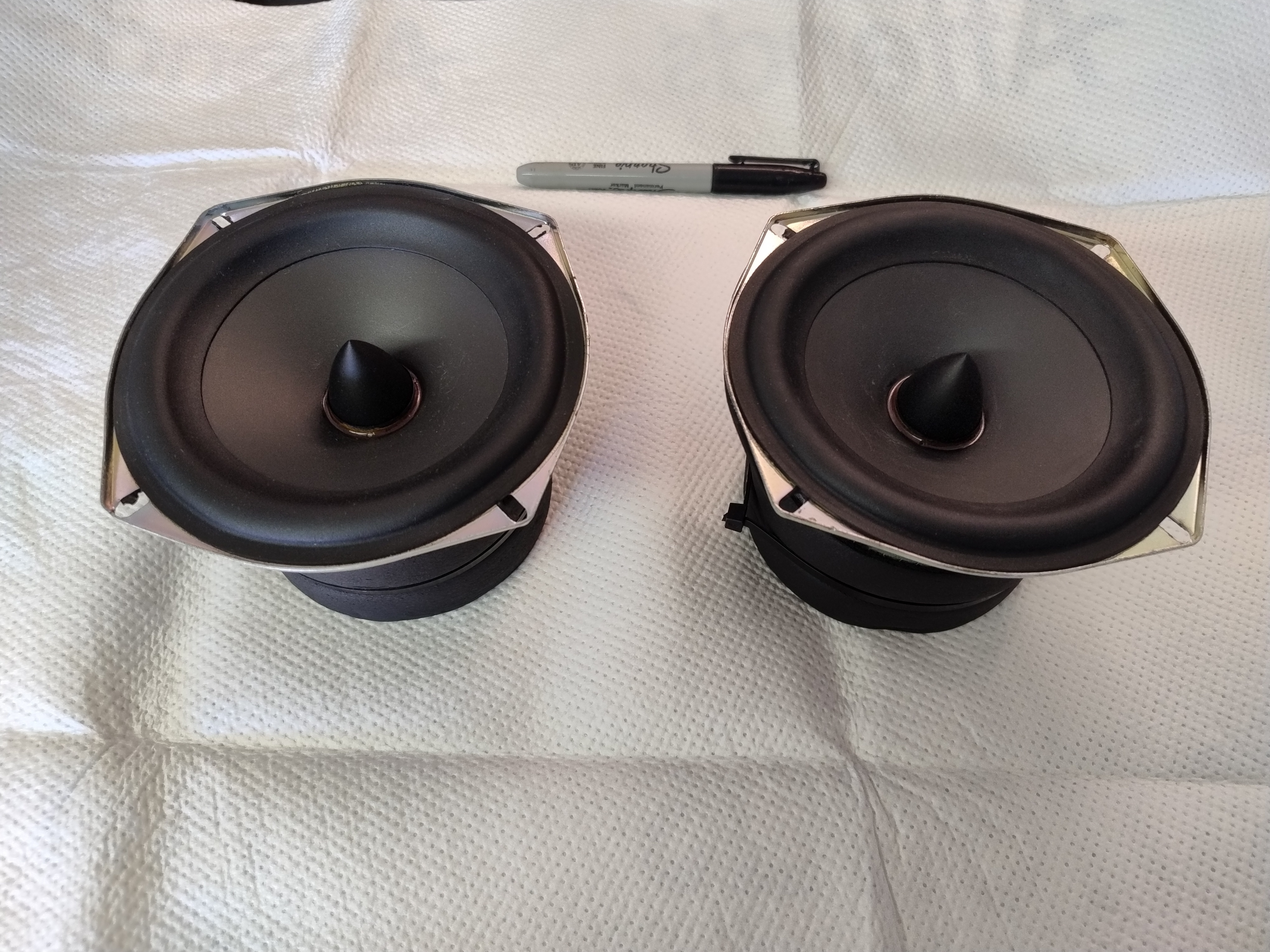

    It thawed out where I could work on these some more. USPS bent the frames in transit although they were packed nicely. Their frames are thin from factory. Had to trim a set of MW65xx phase plugs by 0.180" to match these cones...
    Toolfan66 Posts: 18,165
    xschop wrote: »
    Did you use the sharpie on them, or black anodize them?
    xschop Posts: 5,370
    Satin Black Primer paint...
    I need to get a new Sharpie. The cold took it out. I just use it on the 1/8" of voice coil protrusion that shows after dust cap is removed.
