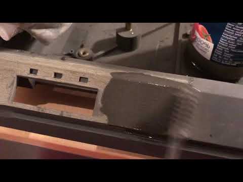

    Nextel is interesting rubberized paint. May have been selected because of anti-static properties when applied over metal surfaces, so it's functional. The ones in top condition I see on Ebay appear to still be dark gray. You may have seen this already, regarding removal of the coating if it has been damaged. Looks like a lot of work!
    https://www.youtube.com/watch?v=wPgGqMgYfic
    Do you know what solvent are they using? I think Acetone would be a good choice since the coating is over metal.
    My Harmony remote had a rubberized suede coating on the back, which became a sticky mess. I removed it by scrubbing with Windex as the case is plastic.
