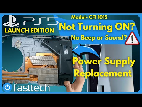

    Is the ps5 power supply external?
    I had lightning take out my Xbox one many years ago but it was just the power supply
  • HzTweaker
    HzTweaker Posts: 1,047
    The ps5's power supply is internal. I tried a different cord off a working console (my ps3) last night and no dice. :'(
    treitz3 Posts: 20,144
    Drat's. Do they offer an external?
  • HzTweaker
    Not to my knowledge. The only PS console that had a external that I'm aware of was the PS3 slim?
    VR3 Posts: 29,557
    edited July 2024
    Looking online it looks like the power supply is removable and is part of the base
    I am not a gamer but if that's the case? Schaaweet!
    Is there a fuse or a reset anywhere within that unit?
    VR3 Posts: 29,557

    VR3 wrote: »
    This is awesome! I'm going to try this for sure, seems easy enough. Great find, Thanks @VR3

    I just ordered the power supply for my PS5 from fasttech. I'll let everyone know how the swap goes.

    The power supply for the SP5 arrived yesterday. I will install it this weekend. :)
  • HzTweaker
    The PS5 is ALIVE!
    Just a heads up to anyone that wants to try this: a T8 security bit will work just fine and a ADP-400DR will work in the place of a ****-xxxER unit.
