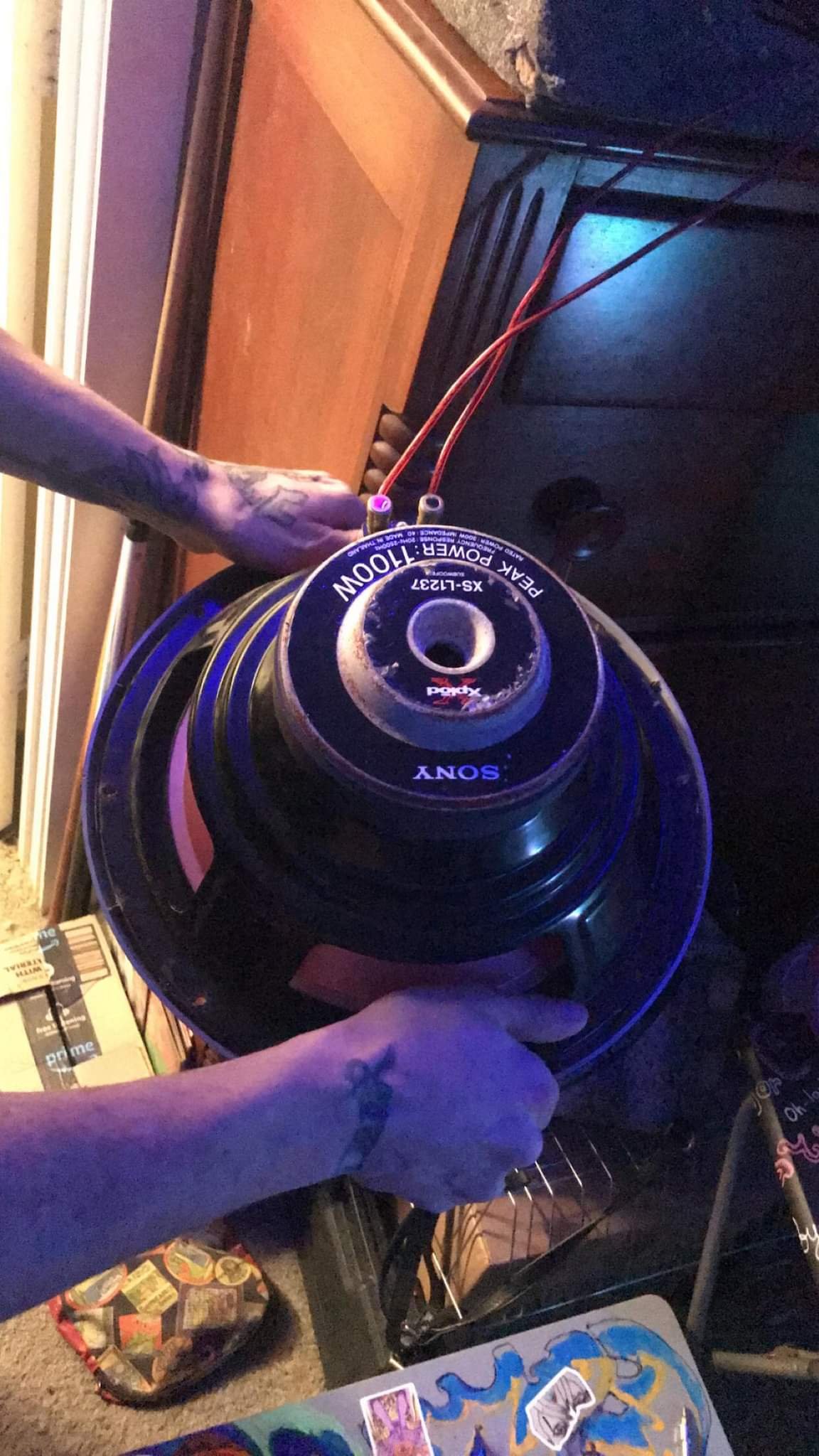

  • The subs are (2) 4 ohm subs (single coil) sony xplode (or however u spell it) 1100 (peak) in a box. I want to run them at 2 ohms (thats the only thing that makes sense but i could be wrong). I tried wiring them multiple ways but i really think my "amp" is faulty for some reason [i did some research and it seems like the compassitors have a tendency to fail] but another problem is the light flickers green if im luccy but never stays green... honestly at this point i just wanna know what type of amp i need to run and try and get a new one. I know the subs work cause they got a lil bit of response when i wired them directly to my recciver.

    3). your woofers seem to be in a sealed box and if you connected them in parallel the speaker impedance would be 2 ohms and if in series 8 ohms.

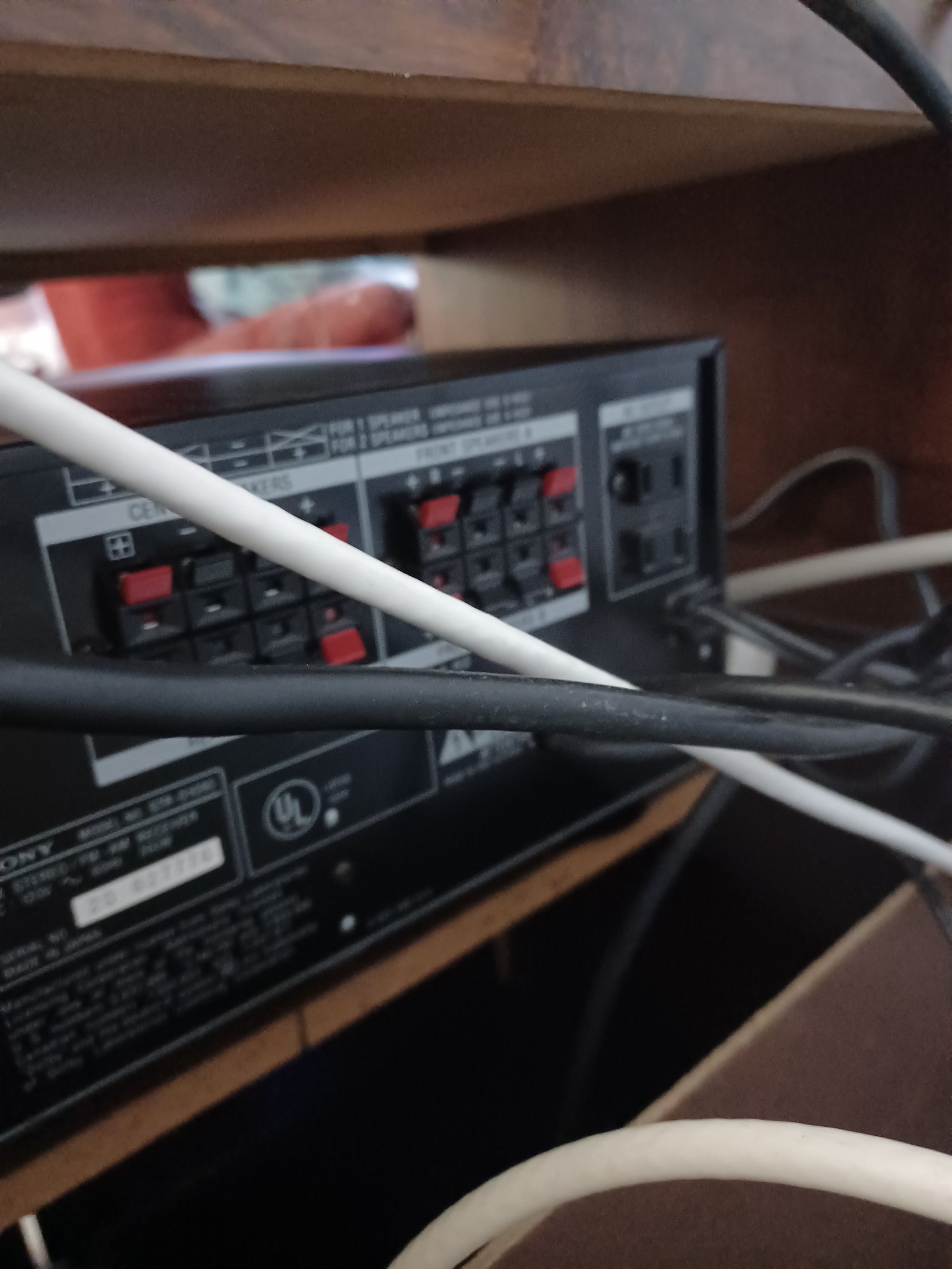

    I would recommend running a right and left speaker wire from the receiver's "B" speaker connections to the corresponding right and left speaker level inputs on the subwoofer amplifier. Then run a second pair of speaker wires from the receiver's "A" speaker connections to your main speakers. Then from the front panel of the receiver select "A+B" on the speaker selector switch.
    I would recommend connecting the red and black wires of the subwoofer amplifier (the ones that would normally go to the 12" woofer) to the speaker terminals of the Sony subwoofer box. I would recommend connecting the Sony subwoofers in series to give an 8 ohm speaker load. Remember that the internal wiring of the subwoofer amplifier will be exposed and will have 110 volts available so be careful!

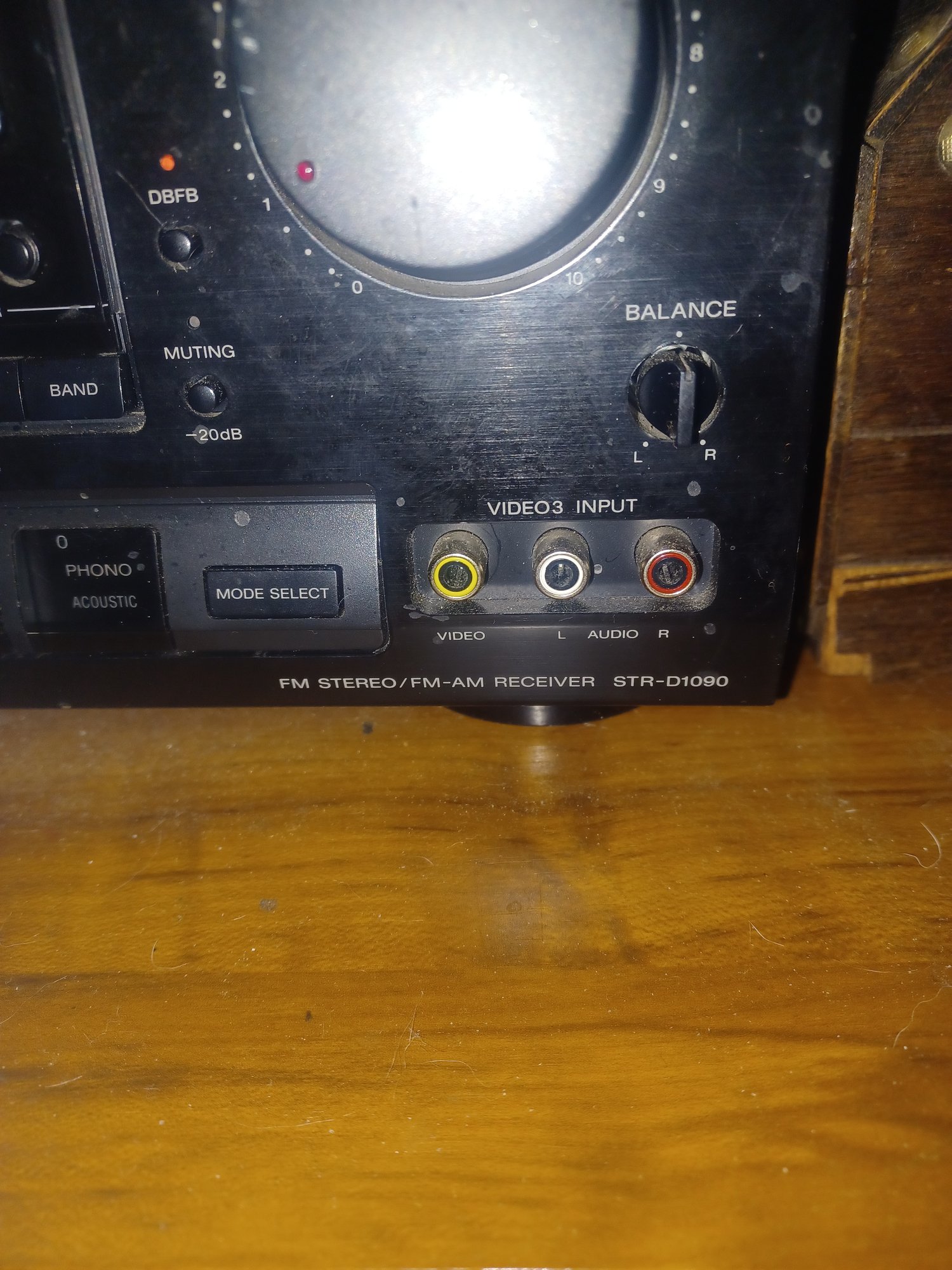

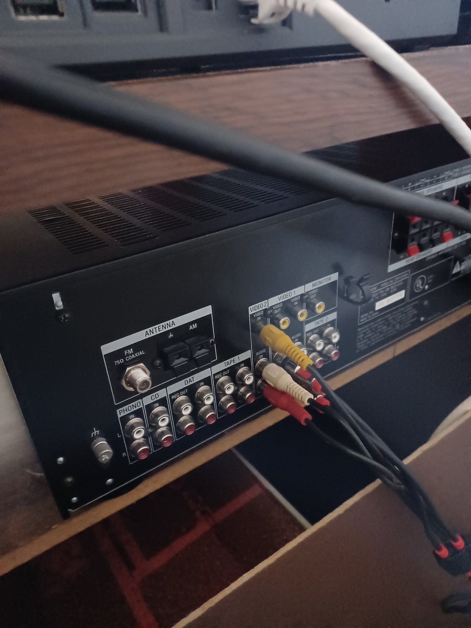

  • What is the manufacturer and model number of your receiver?
  • It is a Sony STR D1090
  • Is that what you needed?
  • Im thinking i would need a mono blocc correct?
  • Thanks for the model number, your receiver has a sub-out connection which is good for connecting a subwoofer amplifier. Since you plan on paralleling the two woofers that means you will have a 2 ohm load and not many amplifiers can produce full power into that low an impedance. There would be too much current needed.

  • Thank you so much. I have it running into the recciver in (i believe in 2 ohms) and its giving a little signal but not what i need. I just ran it in with the speaker wires for now cause there all plugged into the pos(2) and neg(2) that are labeled front spekaer if im not mistaken.

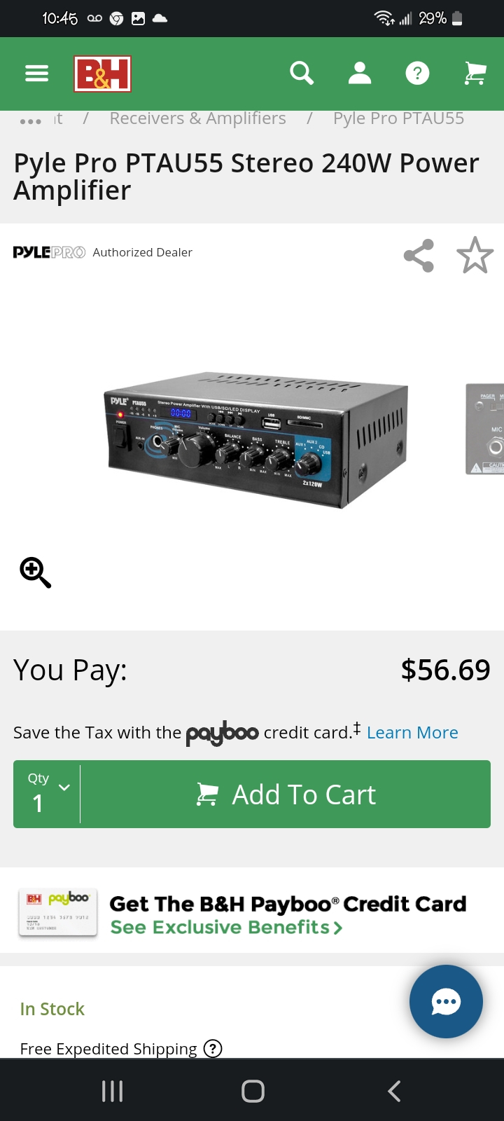

    txcoastal1 Posts: 13,504
    No
    If you could use it, you will need 2 of these each in bridge mode
    you will still need a Y cable splitter to each
