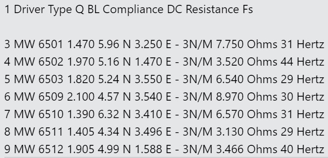

  • What Thiele Small Parameters do you have for the MW6510? This is all I have been able to find so far:
    Is this the driver you have? http://www.dynaudioacoustics.cn/down/DYNAUDIO_17W75v2.pdf

    Well OK. It seems like the Qm is closer than in the non XL, but still not all that close, Compliance is unknown, DCR of two in series is close, Fs is different, BL is less. We can't really know much else can we? How do you know about sensitivity?
    Looks like they used the same voice coil as non XL but changed the magnet motor to a stronger one. Without having the compliance figures for the dynaudio the comparison is tough to make to the 6510.
    How are you going to get any bass without a passive radiator when the freq. response shown doesn't go much below something like 50 to 60 Hz?

    But where are you getting those values of sensitivity (from what graph?) and Vas (Compliance Volume) from for the MW6510, if the only info. you have is the chart that I posted above^^?
    I mean I understand that you are assuming Vas and Cms will be the same if the driver surface area is the same, but are they? It looks like the Polk is around 130cm^2 vs 120cm^2 for the Dynaudio, so Polk is 8.3% greater.
