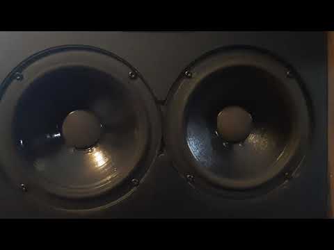

  • I cleaned the cap with windex and a qtip, looks great!
    Still sounds bad. I took a video:
    https://youtu.be/ZIh1goVnyo4
    I pushed the cone out from the inside, and the spider seems securely attached.
    I can push the cone up and down without any noise.
    Think it's a shifted magnet?

    I'd guess either the Pole Piece has shifted or the voice coil has partially separated from the cone or the spider is cracked. Or Lordy Be maybe all three at the same time??? :# I'm trying to keep this brief so as not to upset the powers that be or draw any wrath (or slander). I had an experience with one of mine that was found to be a cracked spider near, but not right at, where it joins the cone. I tried a couple times to repair it with some limited success but I was using Gel Super Glue and I may have been better off with that Ayleens Glue. Anyway, it was VERY hard to spot and I had to use a magnifier and a pencil beam light while pushing very hard from the inside, on the cone. I have now retired that driver because I started hearing occasional malfunctions on bass heavy material.
