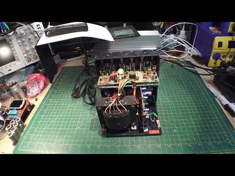

    https://youtu.be/-N31CRS7mpI
    In the last few minutes of this video you will see a demonstration of the power meters. This is the second of two videos that he made on this amp. It was blown up and he rebuilt it.

    I saw the 1st half of that one day not too long ago. Never watched the second half. Thanks, that looks cool as all get out. Mine must be broken. No matter how hard I jam it only the two bottom ones light up.
