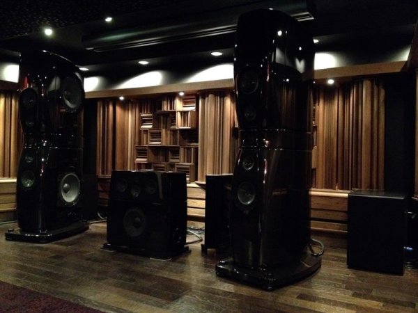

    F1nut Posts: 52,144
    No one, eh?

  • delkal
    delkal Posts: 764
    No one, eh?
    I am impressed with your living room. It is much nicer than mine.
    How much did you pay a professional to custom design and sound treat your room to avoid the destructive interference?

    F1nut Posts: 52,144
    That's not my living room, it's the shack out back.

    SCompRacer Posts: 9,147
    delkal wrote: »
    No one uses two subs.
    This is an absolutely false absolute.
  • delkal
    delkal Posts: 764
    Notice the room looks to be very large and the multiple subs look to be well over 22 feet from the back wall. This will lessen the interference from trying to play a 22 ft long 50 Hz tone but still not eliminate it from the sides. Also notice there are custom sound treatments (which undoubtedly cost more than my whole system including the things I have in my closet) all over the room. They are not there for the tweeters.
    I am sure their system sounds awesome. But for mere mortals with an average sized room.............stick to one GOOD sub.
