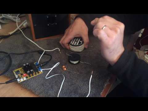

what does an inductor do? pardon my ignorance!
thanks for the link!
In a nut shell spins out wanted or unwanted frequencies

https://m.youtube.com/watch?v=ELQhkMQDiGs
