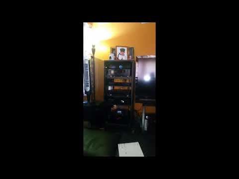

  • Thanks for the updated info, also what is the floor made of (wood,carpet,tile). The reason I ask such questions this will affect the sound of your system.
    Here is a sample of mine
    https://youtu.be/U5ReRo4deu4
    The AVR is Pioneer Elite VSX 32
    most of the music is Mp3 320bps
    my system is a 7.2
    Fronts: Optimus Pro LS3 (old Rat shacks)
    Center: Polk audio CS10
    Sides: Optimus Pro LS3
    Rears: Optimus Pro X77
    Subs: Polk audio 505 & Optimus Pro 12
    Now I put this out there to point out this, the speakers are not closed to being mid to top of the line, but they are tonally matched. I have my speakers set to small and let the subs do their job. I like the detail sound I get and I prefer a more directional effect from my surrounds instead of a blended ambience.
