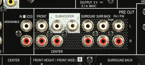

    so how does one connect this to the 5125, since the preouts are L+R channels? with y-cables, or some proprietary cable from Parasound?
    sorry, I'm new to home audio amplifiers.

    The pic of the AVR appears to be a 9.1 channel setup, the 5125 is a 5 channel amp, so only 5 outgoing channels on the AVR can be used. Most people run a 5.1 channel setup, for example the front L and R would go to channel 1 and 2, the center to channel 3 and surround L and R would go the channels 4 and 5, the .1 channel is the subwoofer.

    ah, I see. yeah, the L&R's threw me off. but yeah, that's the from the back of an SC-1222-k

    You need five rca interconnect cables. Connect one from the AVR's front red (right front speaker) to the amp's input which is closest to your front right speaker. I mean it doesn't matter where it goes on the amp as long as your speaker wire is synced up with the matching interconnect, but I like to run them in a certain orientation. Anyway, you're just connecting one speaker at a time with the rca interconnects. Red is considered right except for the center, which doesn't matter. So the AVR's "front" red output is for your right front speaker. Connect that to your amp and make sure you run the speaker wire from its matching speaker wire terminal. And so on.
    yeah, I got mixed up seeing it like this and didn't see how it works. I was thinking a bunch of separate single RCA cables, when really you can still use the standard pair ones, I think.

    Yes you can use the paired RCA's and just use a one side of a pair or just pull a pair apart for the center
