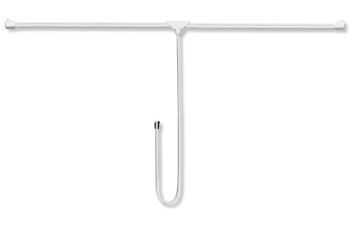

    The good old "T" shaped 300 ohm twinlead FM dipole (those 1 dollar antennae that came with analog tuners, and that Radio Shack would sell you for 3 dollars) are pretty good if: mounted as high as possible and properly oriented. The best reception will be of stations that are aligned with either "face" of the "T" -- the "ends" of the "T" are essentially nodes, with very little reception.
    I use one of these - but mostly because I got it cheap and it looks kind of cool.

    DIY a center-fed, folded, half-wave 300 ohm (twinlead) "T" dipole, and tune it to about 90 MHz. Use it to listen to the "public service" stations (nonprofit, college, NPR, etc.) from 87.9 to 92 (ish) MHz. Those usually sound the best & have the best programming, anyway
    This one's tuned to 90.7 MHz; i.e., for optimal reception of one station's frequency
    source: http://www.antiqueradios.com/forums/viewtopic.php?f=2&t=186963
