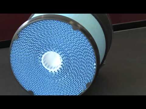

    Here ya go.. Get a Volant CAI with a Power Core filter option. Go to 58 seconds on the video. No oiling, no cleaning and lasts 100K miles or 4 years. The sound when you mash down on the gas pedal is a plus too :D
    https://www.youtube.com/watch?v=SyoSx3WfXZ8
