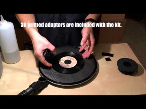

Anybody try this RCM out?
http://m.ebay.com/itm/3D-Printed-Record-Cleaning-Machine-Bring-your-old-vinyl-back-to-life-/151903631006?nav=SEARCH
Seems legit and is half the price of the inexpensive Record Doctor sold at Audio Advisor, I've seen the video and it appears to work pretty good. If you already have a smaller shop vac you are set. I am considering this as a replacement for my spin clean without having to spend the dollars the VPI's and Okki Nokki's cost

    I just finished watching the video - I think I'm going to give this thing a shot.
    I'm going to order direct from Nik at http://www.squeakycleanvinyl.com/
    I'll let you guys know if it does anything to remove jerk record shop owner juju, too.

    I ordered this unit from Nick the Canadian last week. Very polite, eh?
    I need to find a place to find some cleaning brushes like the ones he has in this video below (any ideas where to source?) And some squeezy bottles for the cleaning fluid and rinse. I'll probably go with one of the cleaning fluid ree-sipes I've seen in some of the other posts I've seen discussion about here: Website - http://www.squeakycleanvinyl.com/
    Ebay Listing - http://www.ebay.com/itm/151903631006
    Demo video. Looks like pretty decent build quality.
    https://www.youtube.com/watch?v=QbphnT1d-ys

    Hey guys, got all my stuff together for the SqueakyCleanVinyl 3D Printed RCM from CanFab3D.
    CURRENT KIT IS AS FOLLOWS
    • 1 - 3D Printed RCM Kit from CanFab 3D
    • 1 - Cleaning brush (included with kit)
    • 1 - Shop-vac
    • 2 - Squeezy Bottle (500ml/~16oz); one for cleaning solution, one rinse | http://amzn.to/1Q1LAph
    • 2 - Gallon Distilled Water
    • 1 - VPI Record Cleaning Fluid Concentrate | http://amzn.to/1Q1LrlH
    • 1 - 2 pack 99% Isopropyl Alcohol | http://amzn.to/1Q1LG05
    For the cleaning solution, I used VPI's pour-in concentrate (thanks @voltz), which you mix with 1gal distilled water to make approx 1gal of cleaning solution. I marked one jug W for wash, the other R for rinse. Probably going to draw a skull and crossbones on them, too, so the W won't be mistaken for... Water.
    FUTURE CONSIDERATIONS
    • I am thinking about removing from the 500ml/16oz squeezy bottle approximately 50-100ml (~1.5oz to 3oz) of the VPI mixed cleaning solution, and replacing with same amount of 99% Isopropyl alcohol (I will probably do this now, in fact, the more I think about it)
    • I will probably add at least one additional brush to this kit/method, and possibly play around with a steamer.
    • I will probably also experiment with a DIY cleaning solution recipe instead of the VPI concentrate, given its cost.
    I'm not really sure what the alcohol will do at this point, and need to read up more for specifics. I would imagine it helps release oily deposits and may help optimize the moisture evacuation/drying process.
    I also wanted to post up this link to Nick's site - he offers his plans for a full on stand-alone RCM Station for a more finished approach. You can purchase a more elementary kit from him, and source the other parts yourself for an even cheaper approach if you prefer a bit of DIY. Looks pretty easy, so this could be another option for any DIY'ers interested in building a full on station. If you don't need/want all that, then the turnkey tabletop kit (subject of this thread) seems to be a good option. I like this idea best at this point because it was the easiest way for me to get up and running, and you can set it up and take it down when you're done, and store it away in a tub or something.
    http://www.squeakycleanvinyl.com/diy-rcm-instructions.html
    I'll post up with my impressions of the 3D printed RCM after I get a chance to use it. Not sure that'll be today since I have some grown-up responsibilities to see to, but I do have a couple of dirty records that need some attention.

    Just finished building this one using Nick's (3d from canada) used 3/4" cherry hardwood veneer. Stained with traditional cherry stain and 3 coats of Simi gloss polyfb8cuvr06q99.jpg

    nice! where'd you get your squeezy bottles? I went with the ones I linked above and they leak.
    have you tried it out yet? I haven't gotten around to washing any yet, but just got a new album this morning from Discogs, and it needs a little attention.
  • soundfreak1
    soundfreak1 Posts: 3,387
    Got the bottles at "Micheals" craft store. Will start using today and tomorrow.

    Just cleaned my first album (ARS ) with the RCM. Results were stellar as the album was unlistenable (if that's a word) before ,now like brand new album. Dead quiet. I'm sold!
