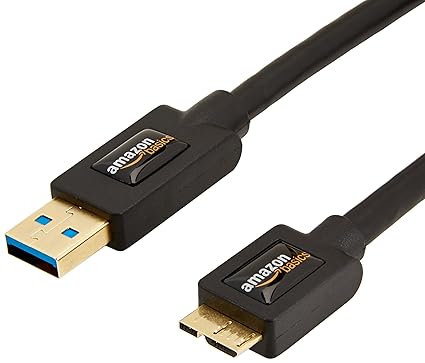

    I was playing music off my external hard drive just fine 2 hours ago. Shut off the Oppo for a bit, turned it back on and now it doesn't "see" my hard drive anymore. Works fine in my laptop. Tried unplugging, replugging, shutting the oppo back off/on, nothing. My USB stick works fine still.
    Strange.
    afterburnt wrote: »
    Village Idiot of Club Polk
    nooshinjohn Posts: 25,893
    Might just be setup issues. I only use my oppo for movies.
  • Nightfall
    Nightfall Posts: 10,084
    Figured it out. I found out that my hard drive, which is powered by the USB port and not a wall wart, only worked on my laptops USB 3.0 port. Plug it into the USB 2.0 port and nothing. This was while using a USB 3.0 cable exactly like this:
    I swapped it for a USB 2.0 cable like this one
    and it works in a 2.0 port now. Plugged it back into the Oppo again and it came right up.
    Reason? I have no idea, anybody know?
