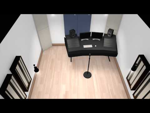

    If anyone would follow Dan's advice, the right speakers reflection points on both side walls would be covered. And the same for the left speaker. Skip's diagram appears to just treat right and left speaker first reflection, not the right speaker on left wall and vice versa. Any additional listening positions have to be treated as well.
    If you have a low ceiling, that too. GIK rocks. I use four bass of their traps and three 244 panels in my room. Great choice of custom fabrics.
    https://youtu.be/B9u7k2V4YPw
