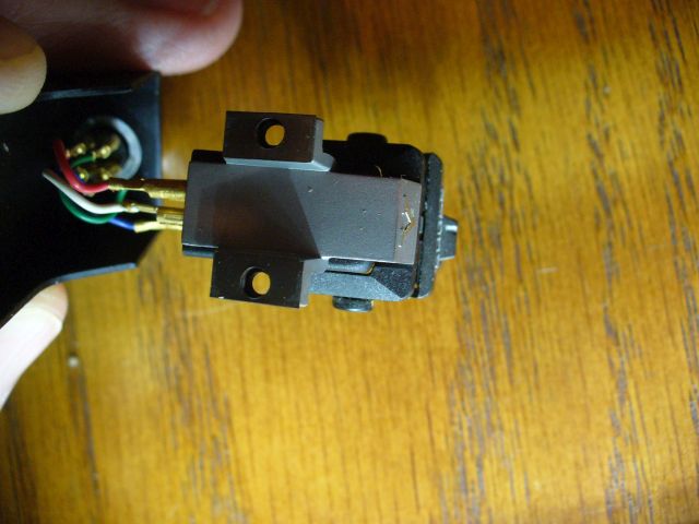

    Well I found the old cart. I thought it was a Shure V15 Type IV cart but all the images I've found on the net show the Type IV plainly visible front the front. The body of this cart is all black except the top has a gray piece and a silver V on the front. What are the numbers 109942? I'll need a stylus. The cart is probably 30+ years old...is it worth getting a stylus(if I can even get one)?

    My V15 Type IV has that written on the front and the V15 Type III has that written on the side.

    Is that a V15 Type V-mr?

    But, wouldn't the V15 Type V-MR also say that on the side? Not sure about that, what does yours say on the side? If it is a V15 Type V-MR, it was TOTL when it came out I believe. There appears to be one on audio asylum trader for $225 with a Jico stylus. The cart itself w/o stylus is worth some jing.

    There is nothing on either side, totally black cart other than where the V is on the top front and the numbers area in the pic.

    I don't know what ever happened to the needle and I guess it's very expensive to have retipped. Only thought of that due to the beryllium cantilever, which I believe is what this has based on memory. Looks like $100 for new Ed Sauders replacement. I found a new DL-110 for $87...what would you do?

    I never had a Type V, just many III's and a IV. Not sure about the Ed Saunders stylus, seems I've read differing reviews of those, I'd research that more. I've always heard the Jico SAS is a real nice stylus, but its pricey. People say the SAS takes the V15's to a new level though. I'd for sure do more research to make sure which version you have, as the styluses will not necessarily interchange between different versions of the Type V. Regardless, that Type V was supposed to be a real good cart. If you had a V15 on your tonearm and you liked it maybe you'd like the M97xE which is about the same price new as the Denon 110 at around $85-ish, lots of guys on this forum speak well of it, and Eric Tracy pointed out the Denon may not mate with your arm. I'd also check out the Grado Reference Platinum that Dawgfish pointed out and see if that will match with your arm.

    Can you post a photo of your cart from the side as well? Try googling something like, matching cartridge with turntable tonearm, and you should get some stuff to read on matching carts to arms. Other guys hopefully will chime in as well here. I checked and it looks like B&H Photo is selling the Shure M97xE for $69 new. That's really reasonable, they've really come down in price. It also looks like its 5.6g so it should work with your arm unless I'm missing something, plus as I understand it they are made to "excuse" compliance issues to some extent. You could always check with the seller to make sure it would match your arm. Also look at the archives for polkies who have posted on the M97xE cart. If you don't want to spend $150 now I'd consider looking into that cart and then keep researching your existing cart because if that check out good it's a real nice cart that would be probably worthy of a Jico SAS stylus down the road. Don't forget you have to align a cart when you put it on the arm. There are threads on the various adjustments when installing a new cart.

    You should be able to slide the front of your cartridge out, which is the the stylus assembly. You should be able to gently slide it right out of the front of the cartridge, together with the stylus guard. Is there a part number on it? Its not 109942, not sure what that is maybe the serial number?

    I have pulled the stylus assembly out and no other markings. Will try and get pics up soon. Did find online the Shure owners manual for the V15 type V and my cart looks just like that one on the manual, just not sure if other carts looked like that or not.

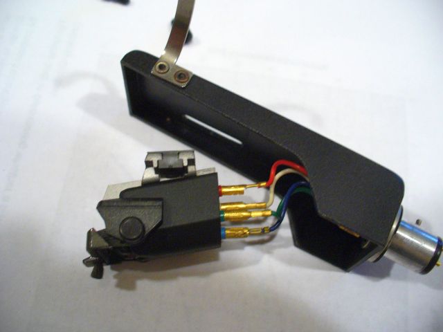

    A couple more pics of the mystery cart. Sending an email to Shure customer service for help. Just want to be positive I'm ordering the right stylus for it.

    Still in limbo on this. I did finally get a DAC and we are enjoying some of the better sounding cd's in our collection. With some $$ due us from the IRS I think the cart is about to happen finally. Shure was not much help in identifying my cart but with some images on a Google search and looking at one on the Gon for sale right now I'm thinking I have the MR cart. Looks like I can either pay for a new stylus or get a DL-103 or possibly 103R for around the cost of the Shure stylus. I've read some really good things about the 103R but something I read says the phono stage needs a minimum of 60db gain...not sure if my Rotel RC-990BX has this as it's not a spec in the manual.
    I now realize that for years I wasas playing lp's with a cart that was not properly installed...I sure hope I have not ruined my records!
