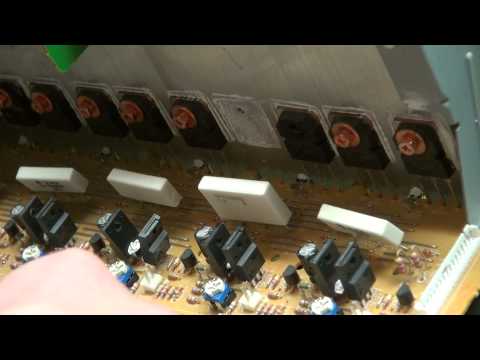

    If you've ever used a multi-meter. Meter the diodes, resistors, and transistors, on that channel. Sometimes its just the output that has opened or shorted.. Other times there are several components like capacitors that get damaged.
    Here is an example of a troubleshoot and repair.
    https://www.youtube.com/watch?v=DKCSD3F3D9w
    While it takes some skill to figure things out and actually repair the unit, you might learn something along the way even if you can't fix it yourself. If you have to have a shop repair it ask them what went wrong and what they replaced.
