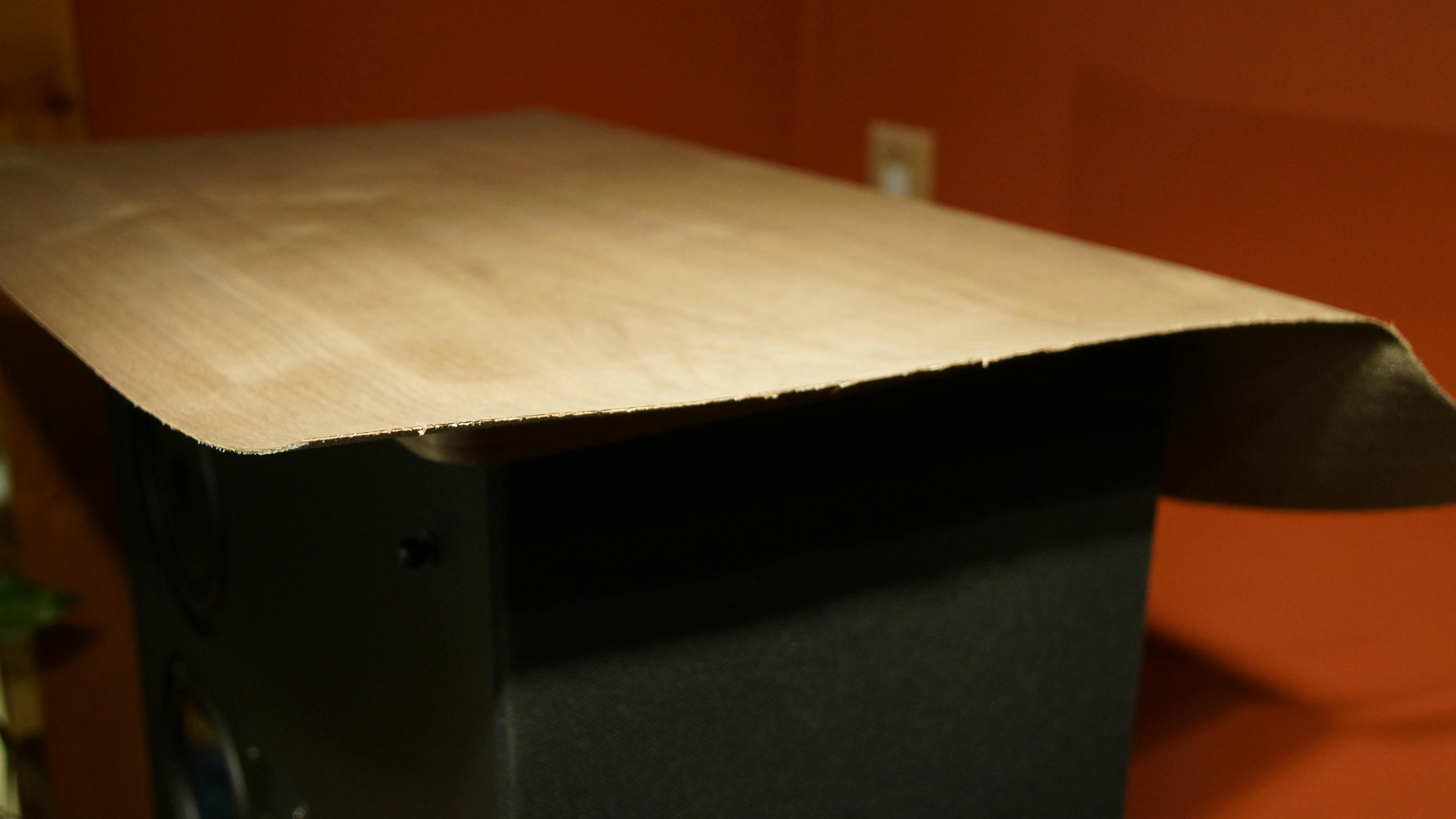

    After putting the band on, and roughing the top on.

    Ordered all products from Band-it prods. http://band-itproducts.com/
    walnut veneer sheet 24x96 and edge banding 2"
    it Irons on and really sticks nice ... no bubbles.
    I applied it with a teflon iron, and a cheap plastic spackling spatula.
    it really takes about 10-15 minutes per top. I thought about removing the top, but then had nothing to hold it in place... so i did it in place, and it worked out fine.

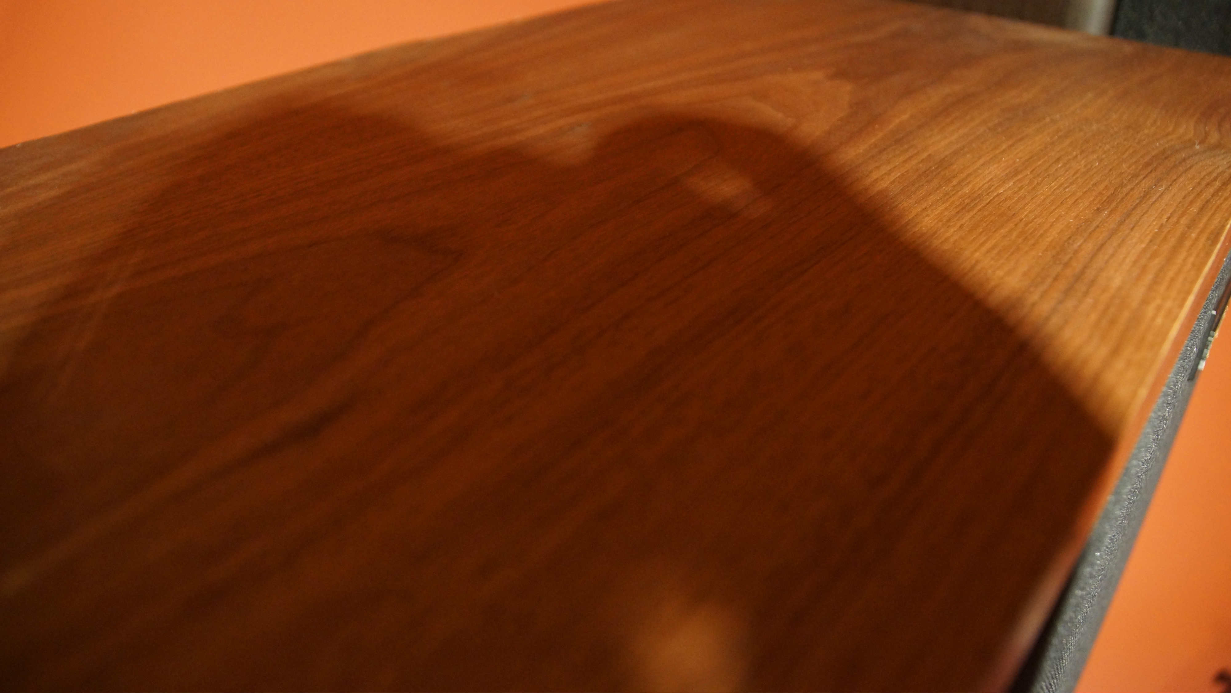

    After 2 coats sanded in between. ! more coat will do it.

    That looks very nice! I like the walnut way better than the oak. Thanks for posting this. It will help when I get to the point of doing this myself in the next year or so.
