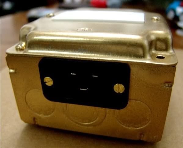

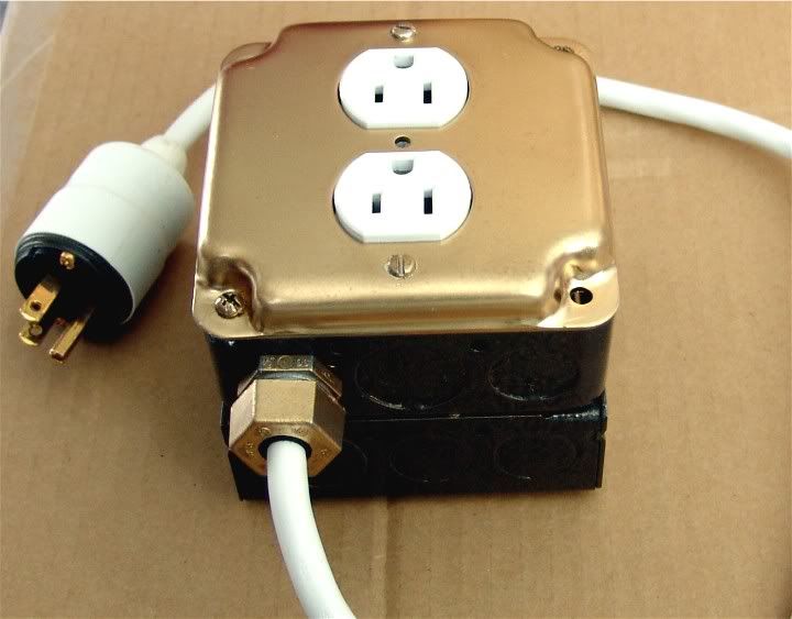

    Mains DC can be blocked, if that indeed is the problem. Certain devices like light dimmers, fan speed controls, temperature controls, etc. load the AC power line asymmetrically (i.e., on only 1/2 of the AC cycle) and this superimposes direct current (DC) on the power lines. This DC causes the core of a transformer to saturate, and in an attempt to recover, the transformer buzzes or hums audibly.
    Prevention is better than cure. It is easier to eliminate the cause versus applying a remedy. Look around the home for any devices like those mentioned above that may be generating DC and turn them off. Halogen lights, fans, light dimmers, hairdryer and curling iron temperature controls, etc. are all potential causes. Sometimes the DC can come from outside your home, like from a neighbor whose home is on the same power company transformer.
    When you can't turn a source of DC off at the source, you can try a DC blocker. The only company I know of at this time currently making filters that claim to eliminate power line DC is Emotiva. I have custom built several DC blockers for Audiogon Forum members since post #23 in the following thread:
