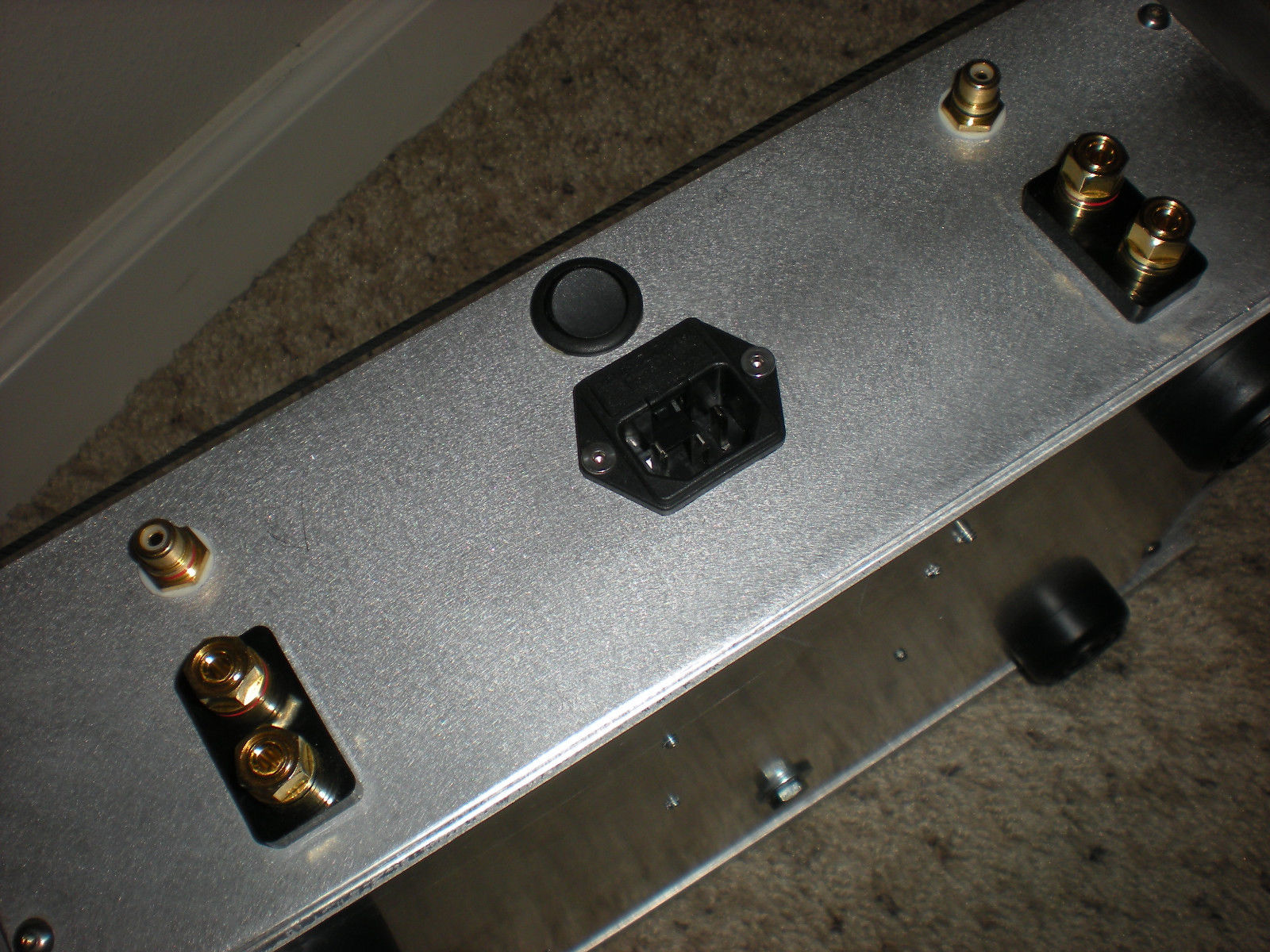

It's obviously a DIY and looks Rawson to me, but the single output device per channel makes me think chip amp?

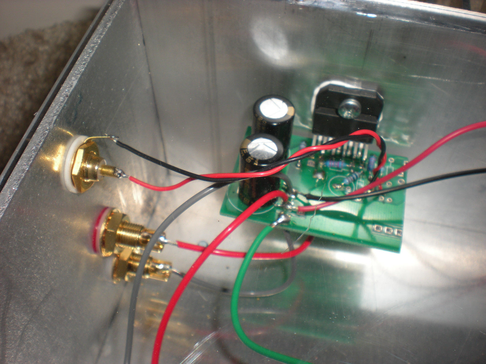

    Gain clone chip amp,possibly using an LM3886 or LM3875.

    Thanks Fred! Gain clone was my thought based on the looks, but I've never built one, so I thought I'd ask all those who are smarter than me.

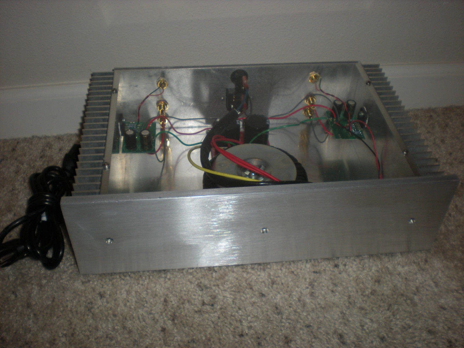

    The output devices are one LM3886T per channel, fed by 55VDC, and with an offset of 35mv. Seems well built and we'll see how it sounds!

    I assume 55 vdc total not+ - 55vdc?Otherwise your exceeding a safe value.It does appear to have a decent supply with plenty of filter capacitance and hefty toroid.Many have used these chips with a mere 2000uf or so of filter capacitance.Why they under sized them makes no engineering sense but...

    Correct Fred, 55VDC + to -. The transformer is rated at 340VA, and it's a snubberized PS with 20000uF of capacitance.

    340va.Then you have plenty of transformer and heat sink area to add another pair of modules and make it a 4ch.

    Sure hook 4 modules in 2 sets of parallel(not bridged).That will give you increased current to drive lower impedances.

    After having the amp on for two hours last night, I gave it a listen with a few different albums and was impressed. The LM3886 amplification was clean, detailed, natural, and seemed to have sufficient power. However, I was testing it on a pair of monitors with a subwoofer running bass duty, so that may help the amp keep its composure longer. I'll test it this weekend specifically against my Tripath amp to see how the chips compare, but I do like that the LM3886 has no tweeter hiss associated with class-D.
    The amp and circuit was very well built, with star-grounding (and chassis grounding), solid electrical connections, high quality components including Cardas connectors and a Plintron transformer, and proper voltages at all test points with no hum or buzz.
