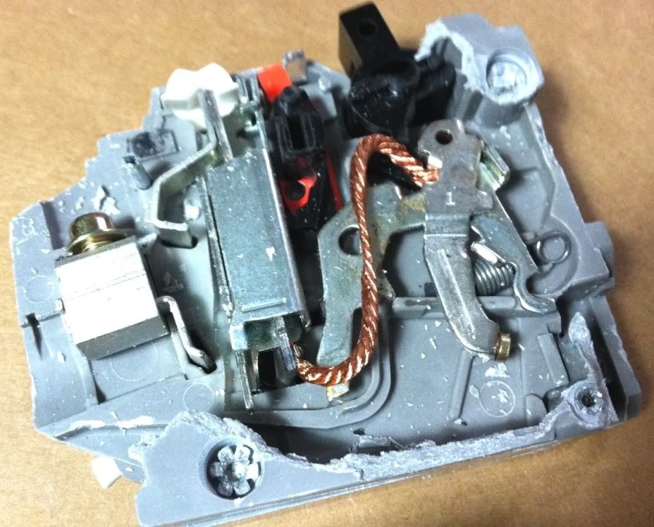

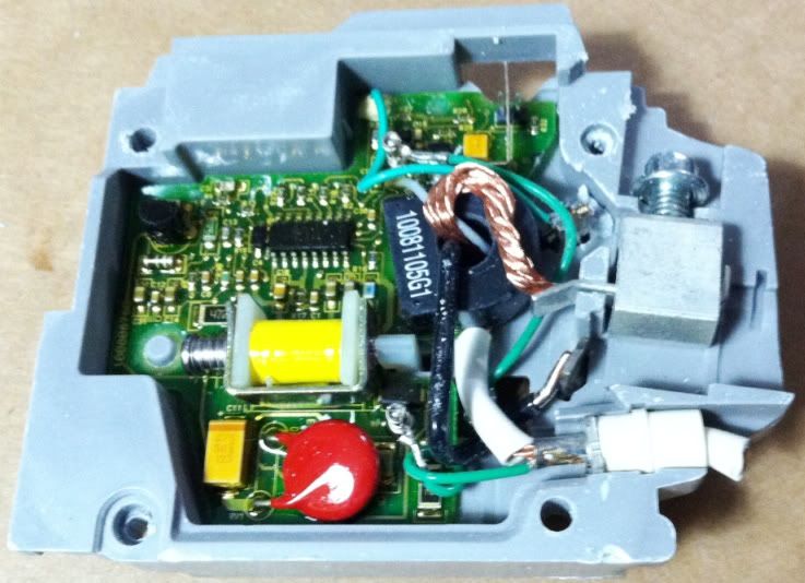

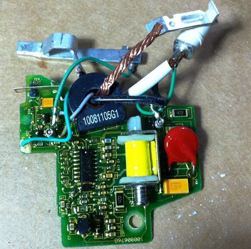

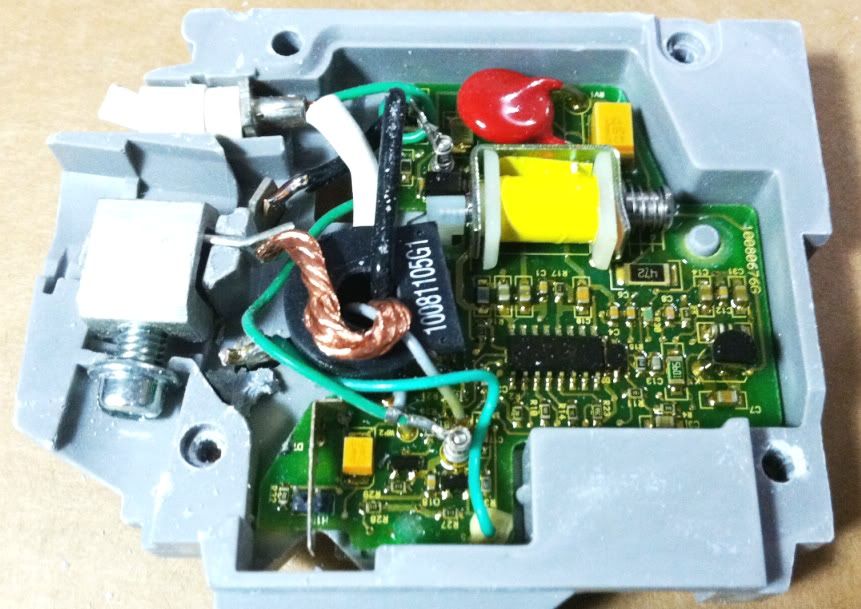

    While there may be some merit to the heating aspects of a "smaller" sized breaker, 1-inch and 1/2-inch breakers of the same type and rating carry identical specifications, including interrupting current rating. You would think that manufacturers have taken that into consideration. There is no lower rating for one size breaker, and higher rating for the next. Products that bear the UL mark have after all been tested and approved for use at their specified ratings. I have a few 1/2-inch breakers in my panel, and have made it a habit of checking on them periodically, especially during the warmer summer months. They do not appear to run any warmer than the 1-inch breakers.
    Anyone using the now-required (1-inch) AFCI breakers is in reality using 1/2-inch breakers without even realizing it. If you ask yourself where does the AFCI detection circuitry and trip mechanism go ? The answer is that one half of the AFCI breaker case holds a 1/2 size breaker, and the other half of the case holds the circuitry and a solenoid that trips the breaker.
    AFCI breaker internal views
