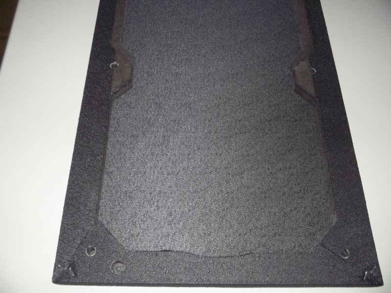

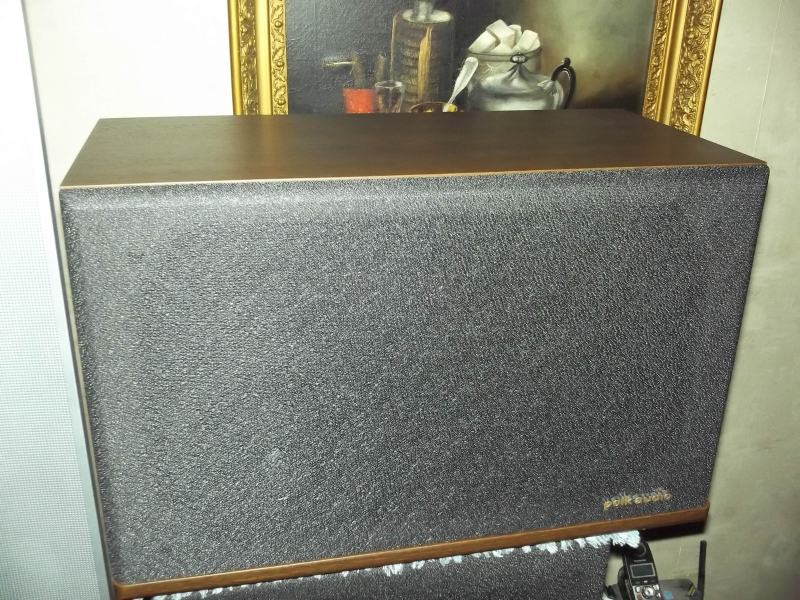

    Here's a photo of my CRS+ with the Grill cloth:
    And my 2ATLs
    Damned thumbnails still not working right

    Yeah, the thing that's got me procrastinating on the grill cloth is pulling out all the staples, that just has "pain in the arse" written all,over it. Plus, my original grill cloth is in very good shape. And also, I'm afraid that the new cloth would not take kindly to trying to re-inset the Polk badge, which I'm quite fond of.
    So... How about that poly fill??

    The CRS grills are small, so pretty easy to work on. There's an upholstery tool called a "Staple Lifter", which makes the job a lot easier. I don't staple the new grill cloth in place, I use 3M #77 spray adhesive on the back side of the grill frame. The only part that is stapled, is the corners after the fabric has been "butterflied" and flattened.
    The Polk badges are easy to remove, apply pressure to the pin on the back, and spin the badge like you were unscrewing it, then remove the clip from the hole. Once the new cloth is on, I take the tip of a utility knife, make a small puncture where the hole is, and push the badge pin back in.

    i re-did the grill covers on my 11T's, and felt the same feet dragging dread going into it, but it was not horrible and the returns were great. My speaks had been in storage for 10 years, and had candle wax on one cover from a party when I was much younger(ick). The new cloth made me feel so much better about everything.
    I have a very good pair of needle nose pliers, and I was surprised to find the vast majority of staples pulled quite easily.
