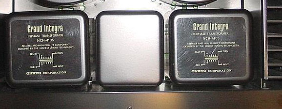

My new pre amp is phase inverting and I have SDA's. Do I need to swap the pos and neg speaker terminals? I can't remember the proper procedure.

    Yes swap the phase on the speakers.However the audibility of absolute phase is debatable.

    Thanks Fred, I was more concerned with the SDA's and making sure they are getting the proper signal to function properly.

    Oh missed your running SDA's part.In that case I would'nt reverse them unless you have one of the isolation transformers.

    My linestage also reverses phase. Best suggestion is to try it both ways to hear which sounds best. IIRC I reversed mine at the speaker and the imaging/clarity/tone was audibly better. I am running a dreadnought, though I wired them the same before the dreadnought without issue.

    The big caution is with SDA speakers, that flipping the speaker outputs can damage the speakers and/or the amp.

    Yes with common ground.An exception would be if using one of the purpose built isolation transformers and a non common ground amp.Polarity could then be swapped with out issue.
    As for preserving absolute polarity I have never found it to be a significant factor.

    It's because you don't use the In-phase transformers. :P

    Ahhh thats it,the old "INPHASE" transformer trick.
