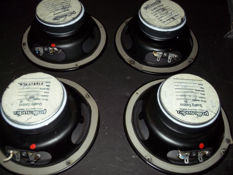

    Home Depot, Loews, Good Hardware Stores should carry it. It comes in 6oz tubes, which are easier to handle then the caulking gun tubes. Gluing the magnets is not difficult. If you look at the back of the woofer, you'll see a steel back plate (usually with a label on it), the dark grey ceramic magnet, and underneath, the front plate. The magnet is sandwiched between the two plates. You apply a small bead of glue where the plate meets the magnet, on the top and bottom. Then smooth out the Loctite with your finger tip, making sure it fills the little gap completely. What I like about the Loctite, as opposed to epoxy or solvent glue, is clean up with soap and water. Any excess glue on the plates or magnet can be wiped off with a damp rag. Set the woofers aside for a few hours, and the Loctite dries clear with a flat finish. It Looks professional and looks like it's been there since day one. Do not use generic or another brand of clear acrylic adhesive. I choose the Loctite Power Grab specifically because it contain no silicone. Most of the others contain trace amounts of silicone, which you don't want anywhere near a speaker, or the inside of a speaker cabinet. Here's a few photos of what the glued magnets will look like:

    Thanks WestMassGuy! Loctite Power Grab it will be. The pictures helped, as did your description.
