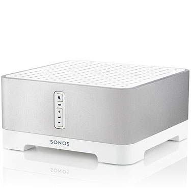

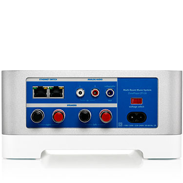

    Speaker switching amp stuff? Go to Niles and look around http://www.nilesaudio.com/
    But why get into a messy outdated system? Buy three Sonos Connect Amps.
    Three Sonos players with built in amps. You can group all three zones into one or play them as three different zones all from the flip of a switch on your PC,tablet, iphone, or ipad.
    If you have music on a network drive, Media player, or PC you can point the sonos at it using its PC app. It will stream CD quality music.
    But I hate streaming music, well Sonos has a audio input. You connect 1 source to any of the three sonos amps and you can use it on any zone. The more sono amps you get the more sources you can add. So in your case Three.
    The amp is good too. I power in-wall B&W and Sonance speakers with them all the time. 55w X2 + they have a Sub out connection.
    I cant say how awesome Sonos is for multi zone audio systems. Anything else is a waste of time and money.
    Also want to point out that you only need ONE unit connected to the internet Via Enet cable. the others will run on Zwave. If your audio location (A/V main) doesn't have Enet you can connect a Zone Bridge to your network and that will let your Sonos amps connect to the network.
    AMP http://www.sonos.com/shop/products/connectamp
    (if needed) Bridge http://www.sonos.com/shop/products/bridge
