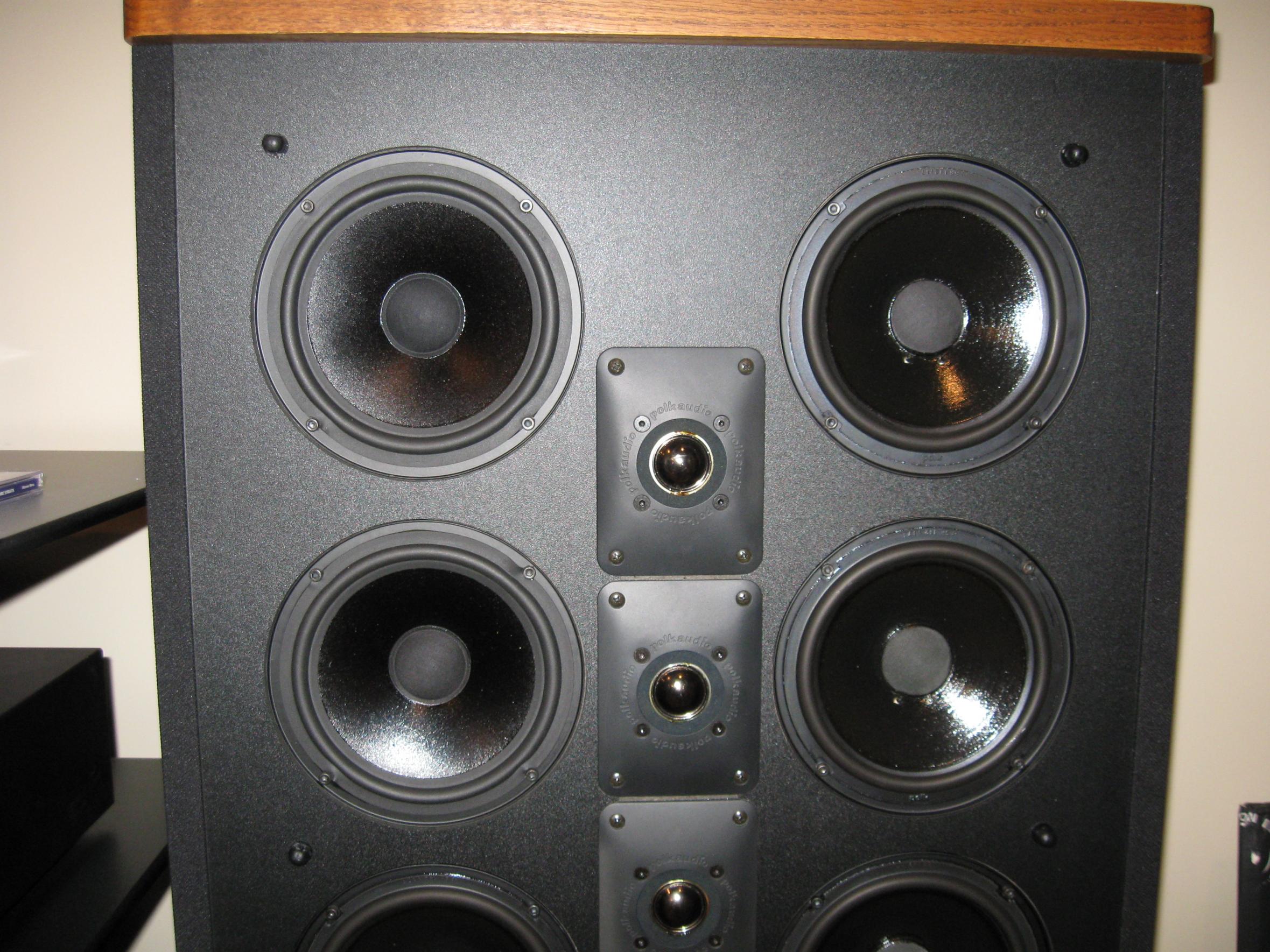

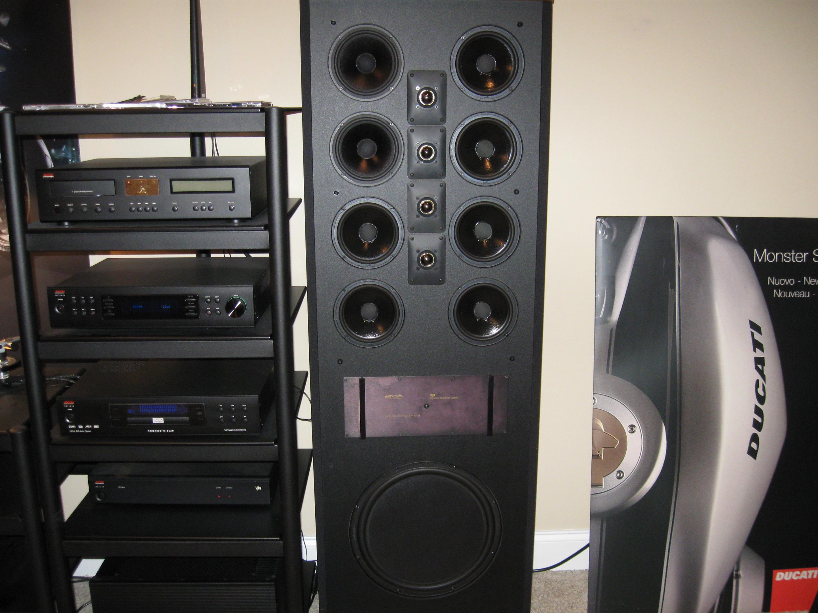

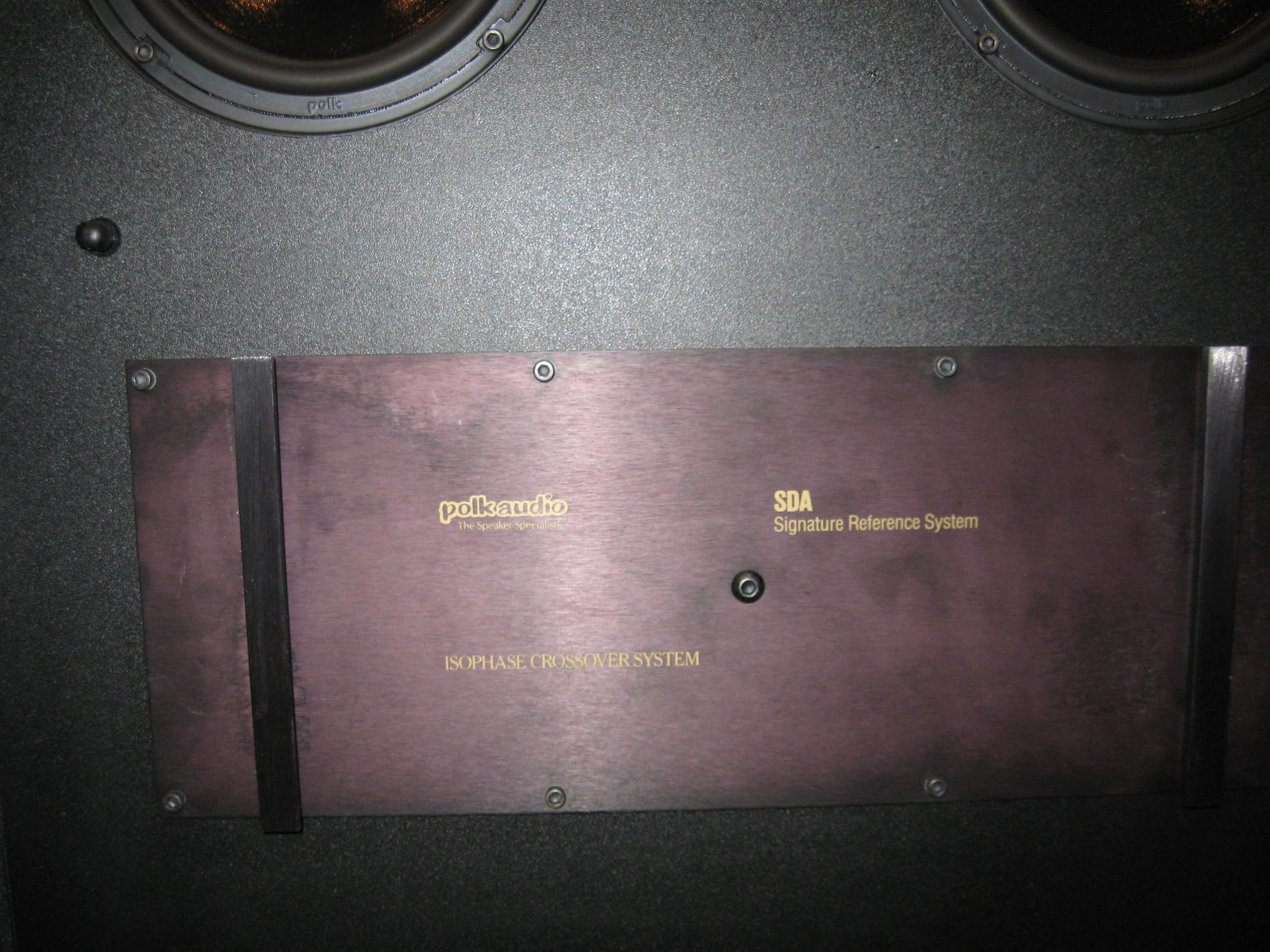

what version SDA SRS are these? what is a fair price?

    Not original SRS, crossover has fewer fasteners (9 vs. 13) OR the crossover has been replaced (but why?)
    Has black tweeters, if they're original, they're SL3000, so 1.2TL. Otherwise, either 1.2 or 1.2TL, and RD0 tweeters.
    I suppose $1400--$1800 depending on whether the tweeters are originals, somewhat higher if mods are already performed, etc.

    Those are 1.2 TL's. The foam ring on the tweeters indicates they are SL3000's.

    They are 1.2tl's, and it looks like some of the drivers have been replaced as well with the newer ones..
    I paid $500 for mine, but that was luck on my side..

    Good eye. The 2 upper left mid-woofers are replacements. You can tell because the voice coil leads don't peek out from under the dust cap. Also looks like the person who installed them didn't trim the rubber around the screw holes. A couple spots look like the surround is slightly rippled from tightening the screws.
