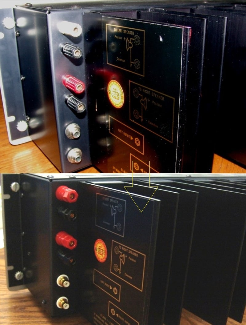

    This time I figured out what it was. It is the RCA connections on both amplifiers. Wiggle them the wrong way and kiss your speakers goodbye. It is just crazy how both amps have the same issue. Should I check what's under the hood and see if I can get to the RCA connections to inspect? Or is this an even more simple job? Would love some direction at this point and thanks in advanced.

    If the original RCA jacks are attached directly to a PC board, they could have developed a bad connection. In either case, for peace of mind I would replace the existing ones with new, better quality chassis-mount connectors. If the originals are PC-board mounted, the replacements can be jumpered to the board. I've done many such replacements, and its not difficult to do. My favorite chassis-mount RCA jacks are Furutech FP-901 at $92.99/pair, if you want the very best, or Dayton RCAs, part #091-1120 at $6.89/pair from Parts Express, a good quality for the price.
    http://www.vhaudio.com/connectors-rcaxlr.html#FURUTECHRCAfemale
    http://www.parts-express.com/pe/showdetl.cfm?partnumber=091-1120
    Here original short nickel plated RCAs have been replaced with the Dayton gold plated RCAs for a more secure connection:

    You can also solder some short wire from the board to normal solder type rca inputs, and eliminate any vibration problems than can occur from inputs soldered directly to the board.
    I know the normal solder types are easier to find, and there is a bigger selection as opposed to pcb board type inputs.
    I would consider using some good ones, because it is a nice upgrade from basic rca inputs, and does add some benefits IMHO.
    Being some older amps, I have my doubts the inputs are soldered directly to the board, but I have a history of being wrong, so YMMV with my advice.:cheesygrin:
    Mine is an older B&K, and it had wire soldered directly to the rca inputs, to a Molex connector, and the female Molex was soldered to the pcb.
    I eliminated the Molex all together, and reaped some detail in my amp using some decent wire straight from input to board, and eliminated the stock silver plated copper wire in the process (which I dislike).
