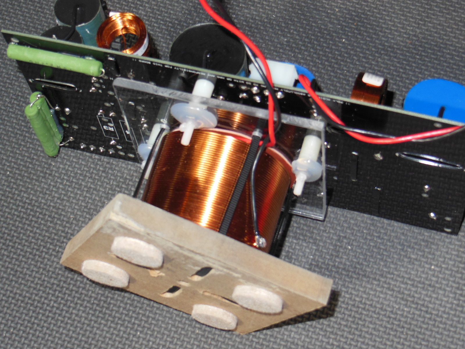

Now, I have the Mods Completed on My 1Cs!
Moose68Bash
Moose68Bash Posts: 3,843
edited July 2013 in Vintage Speakers
1.Installed RDO 194 Tweeters
2.Installed Crossovers Upgraded by Vr3 Mods:
a. Gimpod Boards
b. Clarity Caps
i.Tweeter Network: Clarity Cap ESAs:
ii.Midbass Network: Clarity Cap PXs
c. Mundorf Resistors
d. Jantzen Perfect-lay Inductors: Board-mounted & SDA
3.Custom SDA Interconnect Cables by Vr3 Mods:
a. Supra Rondo 2.5 Cable
b.Neutrik speakOn NL2FC Male Connectors (Speaker Ends)
c.Banana Connectors (Dreadnought Ends)
4.Custom Aluminum Binding-Post Plates by Vr3 Mods:
a.Upgraded Binding Posts
b.Neutrik speakOn NLJ2MD Female Jack Receptacles for SDA Cables
5.Dreadnought SDA Amplifier Interface per DarqueKnight’s Design:
a.Toroid Corporation of Maryland 600VA Transformer
b.“Larry’s Enclosure” by Toolfan66
c.Cardas CCGR Binding Posts
6.“Larry’s Brackets & Rings” by Toolfan66:
a.Brackets for Tweeters
b.Rings for MWs and PRs
7.Black Hole 5 Installed behind Tweeters, MWs, and on Sides in Cabinets
8.Dynamat Xtreme on MW and Passive Radiator Baskets
9.JB Weld on MW Magnets
10.Custom-cut Gaskets for PRs (1/4” Neoprene Material)
11.Spikes
First impressions of sonic performance:
Immensely improved clarity, definition and openness of the high frequencies -- e.g., in Rebecca Pidgeon's rendition of "Spanish Harlem" on Chesky's "The Raven" CD.
Greater depth and clarity and power in the bass. Timbre of the instruments came through clearly and accurately -- e.g., bass violin in the Turtle Island String Quartet, "Windham Hill Retrospective."
Overall, the accuracy and richness of the sound reproduction is remarkable even at this early stage of burn in, and I'm sure it will get better and better.
Well done, Trey! Thank you, once again for all your good work, help, and advice.
Thanks also to DarqueKnight, Toolfan66, F1Nut, drumminman, nspindel and everybody else on the Forum who have searched for, found and passed on information about these mods that have made it possible for a neophyte like me to get this done -- one way or another.
Here are some pictures of the process:

    After my initial delight with the performance of my newly mod'd 1Cs, on Friday when I went to my exercise area for my daily physical therapy routine, I turned on my system and got on the arc trainer for an aerobic workout.
    I realized quickly that the sound between the two channels was not balanced; there was very little sound from the left channel 1C speaker.
    Here's what I did to try to identify the problem:
    First, I checked all connections. They were secure.
    Second, I adjusted the balance to see whether I could get more sound out of the left channel. The result was that the overall volume went down when I increased the signal to the left channel, but this did not increase the sound out of the left channel.
    Third, I disconnected the SDA interface from each speaker to see whether the faint sound I was getting out of the left channel was the SDA signal through the Dreadnought. This action had no effect on the left channel sound. (I don't understand the SDA circuit well enough to know whether this "diagnostic" really made any sense.)
    Fourth, I disconnected the 1Cs and connected my Allison 6s. Bingo, great sound again.
    Then, I sent an email to Trey at Vr3 Mods describing the problem and what I had done to identify it. Over a period of a few hours and in several emails Trey suggested a number of things to do. As always, Trey showed that his first concern is solving problems, especially with folks who have had work done by Vr3 Mods.
    Omitting several steps to make a long story short:
    Trey thought there might be a problem with the stainless steel machine screws and washers that I used to mount the crossovers on Lexan plates. He tested his hypothesis with a spare GIMPOD board and a machine screw and discovered that in some instances current was passing into the screw from contact with the board.
    He wrote to me:
    "I actually was able to get the rod to keep a resistive load, simply lightly keeping it to one side of the board to keep contact and it maintained a 3.5 ohm load in the midbass circuit.
    "On other parts of the board it was fluctuating between .5 ohms and 0. With this information I am hoping everything will be ok..."
    He recommended that I unmount the crossover boards from the Lexan plates to see whether this solved the problem.
    This morning, I removed the PRs, disconnected the new crossovers and SDA inductors and reconnected the stock crossovers and SDA inductors. The 1Cs performed properly, which indicated that the problem was with the left channel crossover/SDA assembly.
    So, I unmounted the crossover boards from the Lexan plates, removed the stainless steel screws and washers from the GIMPOD boards, and reconnected the new crossovers and SDA inductors. Again, the 1Cs performed properly.
    After a trip to Home Depot, I remounted the crossover boards on the Lexan with nylon machine screws, spacers, and washers. When I reconnected the crossovers, the 1Cs performed properly, both confirming that the problem had been with the use of conductive screws to mount the GIMPOD boards on the Lexan plates and solving the problem.
    While this was an interesting exercise in problem solving for a newbie like me, it was undoubtedly a distraction for Trey, who nevertheless once again really showed his sincere concern for helping a fellow Polkie in trouble. He went above and beyond to give me advice and to follow up on my results.
    I am posting this "story" for two reasons:
    1) As further testimony to Trey and Vr3 Mods and
    2) as a warning not to use conductive materials to mount GIMPOD boards in speaker cabinets.
    The remounted crossover board on the Lexan plate, using nylon machine screws, spacers and washers.

    Midrange sound is distinct and mellow in a good sense -- e.g. vocals and instrumentals in David Johansen's "Shaker."
    Bass is wonderful: Compact, punchy, nicely tactile, as in Mark O'Connor's Hot Swing Trio's "Live in New York," as well as in the above selections.
    Because of the space in which this system performs, it is difficult to evaluate the soundstage, except 1) that in the "sweet spot" the rendition of the music is very realistic with respect to both the location of vocalists and instruments and the apparent movement of sound around the stage as parts change in the music and 2) that the power of the projection virtually fills this large space with sound, even at moderate volume levels.
    All in all, these speakers produce great sound in a difficult context.
    An aside: Just as I was reconnecting the 1Cs into this system, the on/off switch in my 25+ years old Perreaux PMF3150 amp failed; the switch would not remain in the "on" position. I had to replace it with my Perreaux PMF2350 (same vintage) while the 3150 is being repaired. When I have the more powerful 3150 (300 wpc into 8 ohms v. 200 wpc into 8 ohms) back in the system I expect to get even better performance.
    Once again, thanks to all those on the Forum who made it possible for me to make these improvements in my system, and especially to Trey for his excellent work, great follow-up, and sound advice (pun intended :smile:).

    Awesome to hear! Keep rocking and rolling! :]

    You and Trey did a magnificent job on those. I am just getting ready start getting all the parts together for my crossover mods so it was nice to see your step by step implementation.
