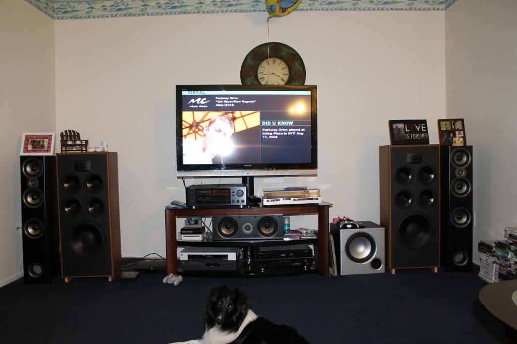

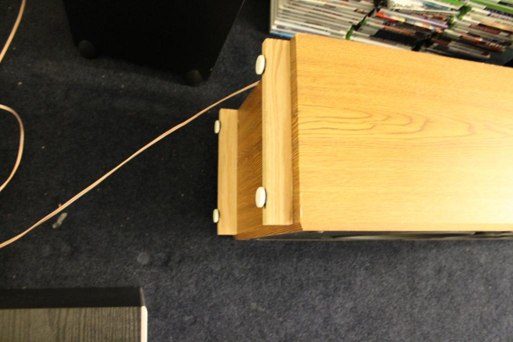

    Ok after seeing your pic, I don't think my risers are original. Here is a pic with a few more.
