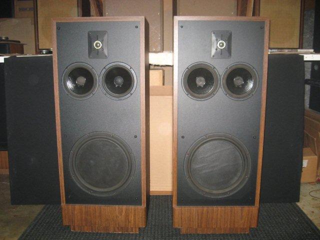

I finally got a pair of SDA 2A's
doctorolds
Posts: 12
I would first like to say hello to all of the Club Polk members since this is my first post here. As the title of the post indicates, I just acquired a pair of SDA 2A's. I have been reading quite a few other posts to obtain a bit of knowledge prior to posting, in addition to the SDA Handbook and the information on Vr3 website.
I have performed the DCR test on the speakers and I am reading 4.7 ohms on both speakers versus 4.0 ohms as indicated, is that acceptable? All other readings are as they should be. The speakers were said to be functional when I purchased them from the original owner but he had no equipment to test them with. One end of the IC has been damaged and electrical tape has been wrapped around it as a fix, but it tests out OK, no short across pin 1 and 2.
Should I look for or test for anything else prior to hooking them up for a test run? I would hate to damage my Sansui 9090 just because I was in a hurry to test them. Thanks to all.

Welcome to the forum!!
One test that is often overlooked is a basic test for the all of the drivers inside the cabinets being in phase, and all your connections having the correct polarity all the way back to the amp. It can easily be done with a 1.5 volt flashlight battery. Having everything in phase can make a HUGE difference in the way your SDAs will sound. Be sure you disconnect the Interconnect cable before doing the test.- SDA 2BTL · Sonicaps · Mills resistors · RDO-198s · New gaskets · H-nuts · Erse inductors · BH5 · Dynamat

doctorolds wrote: »I have performed the DCR test on the speakers and I am reading 4.7 ohms on both speakers versus 4.0 ohms as indicated, is that acceptable?
I'd be way less concerned about DC resistance measurements if the value you got was LOWER than spec. Higher than spec...hook 'em up and play music. -

How much resistance is in your test leads? Did you "zero" the meter with the test leads in the circuit?
I think that you meant that you would be concerned if the measurement was lower than expected (i.e. something shorted). I agree with the reading being a little higher and will probably hook them up unless someone lets me know about something else to check. Thanks. -

Ignoring my recommendation may come back to haunt you...
I have seen this test mentioned before but do not know how it is done. Care to share?

littlewoodboats wrote: »I have seen this test mentioned before but do not know how it is done. Care to share?

Other than checking to make sure everything moves freely my ears have always been the test. I have seen mention of using a battery for testing but have not seen an explanation of what was being done. Just wish my dancing partners were not so pricey -

Play those bad boys and tell us what you think, IF there are any problems, many around here would be glad to help.
What gear are you using? Is your room big enough for them? -

I was not familiar with your Sansui Model so did a quick search. You did not mention whether your 9090 was the DB model. The 9090 with no suffix does not seem to be four ohm stable. The DB model does make mention of four ohm operation.
I roasted a nice Yamaha Receiver with my 2A's so know first hand that it can happen.
Enjoy your speakers. While the blade/blade models do have limitations compared to their later siblings great sound is not one of the limitations. -
Sorry if this has already been mentioned. if polarity is a concern, it is easy enough on the 2A's to remove the drivers and compare the wiring to that in the sticky showing the schematics for theses speakers.

When I first got my CRS+ speakers I had no SDA sound. OldManSRS suggested that I test for the drivers being out of phase and check my wiring connections for correct polarity. The battery test helped me find that the previous owner had connected a new MW out of phase when he installed it. When I connected the driver properly there was a night and day difference in the sound. Here is link to that thread : http://www.polkaudio.com/forums/showthread.php?129314-CRS-Just-arrived-Need-help-checking-them-out.&highlight=battery
See, TennMan, I knew that with a little prodding you could be very helpful. :razz: I'm just trying to encourage those who are trying to be helpful to actually be helpful. From the OP's post - his first post! - you can easily feel that he was burning at the bit to get those new-to-him SDAs fired up to see what they can do. He just didn't want to jump the gun if there was the possibility of doing any damage to them. Then you stepped in with the ominous statement: "Ignoring my recommendation may come back to haunt you..." all the more ominous with the trailing dot-dot-dot "...", as if his not following your recommendation might lead to some catastrophic consequences. Then, you gave him no direction as to how he might go about following your recommendation. That's not helpful. All you needed to do was guide him back - which you eventually did - to the thread from your early days in the SDA world when OldManSRS and others were very helpful in helping you get started on your journey. -
littlewoodboats wrote: »I was not familiar with your Sansui Model so did a quick search. You did not mention whether your 9090 was the DB model. The 9090 with no suffix does not seem to be four ohm stable. The DB model does make mention of four ohm operation....
I have a 9090, not a DB model. Here is an AK link that states that a 4 ohm load should be fine if your receiver is running properly. http://www.audiokarma.org/forums/showthread.php?t=339880&highlight=9090
My leads when shorted read about 0.3 ohms, so that would put my readings at about 4.4 ohms. I think that this would be considered a good reading. -

I thought I would provide a quick update. The SDA's are fully functional and sound great, even though they were not setup properly in the middle of the garage. I posted a couple of pics in which you can see the grill cloth is coming loose, they have a bit of candle wax and nicks in the vinyl on the top near the back edge and around the bases. I cannot wait to perform a few upgrades, clean them up, and place them in a better position. I did not steal them but I don't think that $200 was to bad. What is your opinion?

I checked all my SDA's with IC connected for battery test and all drivers including SDA drivers are in phase.

With the cable connected the SDA drivers can move out of phase when needed to cancel out crosstalk between the speakers giving the SDA sound that we all talk about. I don't know enough about crossover electronics to tell you how and when the SDA drivers operate in phase and out of phase in normal operation to work their magic. Maybe someone here with an electronics background could explain how it works.
I do remember when I was troubleshooting my speakers that the signal from the left speaker crossover goes through the right speaker crossover (and vice versa), so leaving the IC connected while testing one speaker could cause a problem when trying to determine if one speaker is in phase. That's why I said the IC should be disconnected.- SDA 2BTL · Sonicaps · Mills resistors · RDO-198s · New gaskets · H-nuts · Erse inductors · BH5 · Dynamat
I don't believe it'll cause anything. DC voltage will go to SDA driver/s of other speaker with IC connected but this is important to check SDA drivers' phase.
If you don't test SDA drivers, even if you have all other drivers in phase, speaker as a whole won't be in phase if SDA driver is not in phase.
IC disconnect may help other kinds of troubleshooting.
Mystery, I believe you missed my point but that's OK. Thanks for giving me your opinion. I appreciate it.
